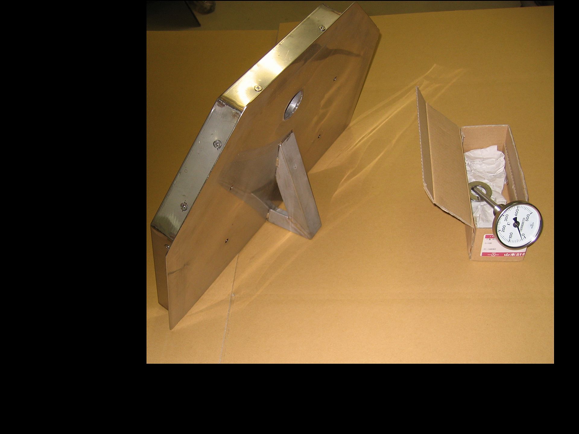

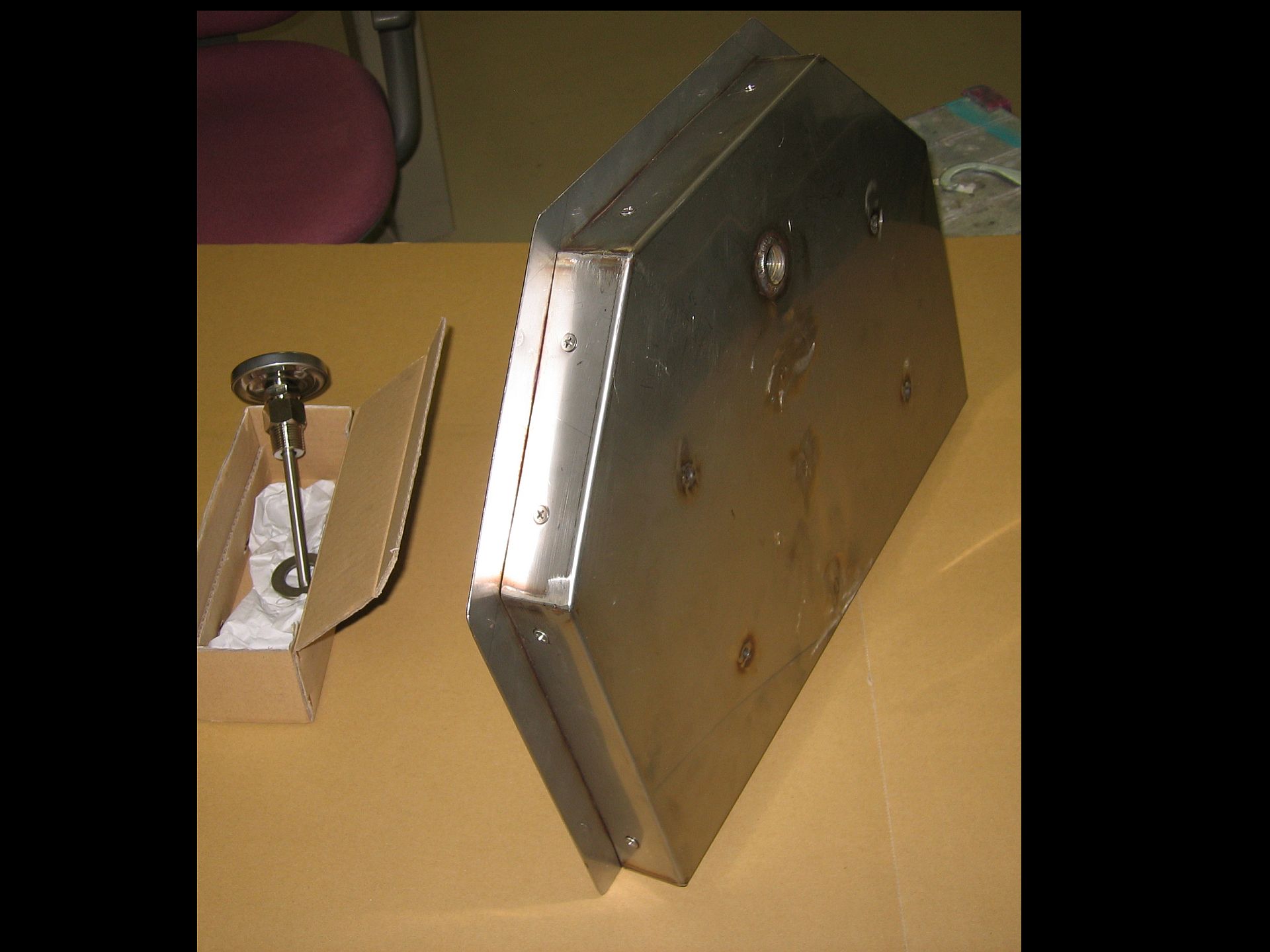

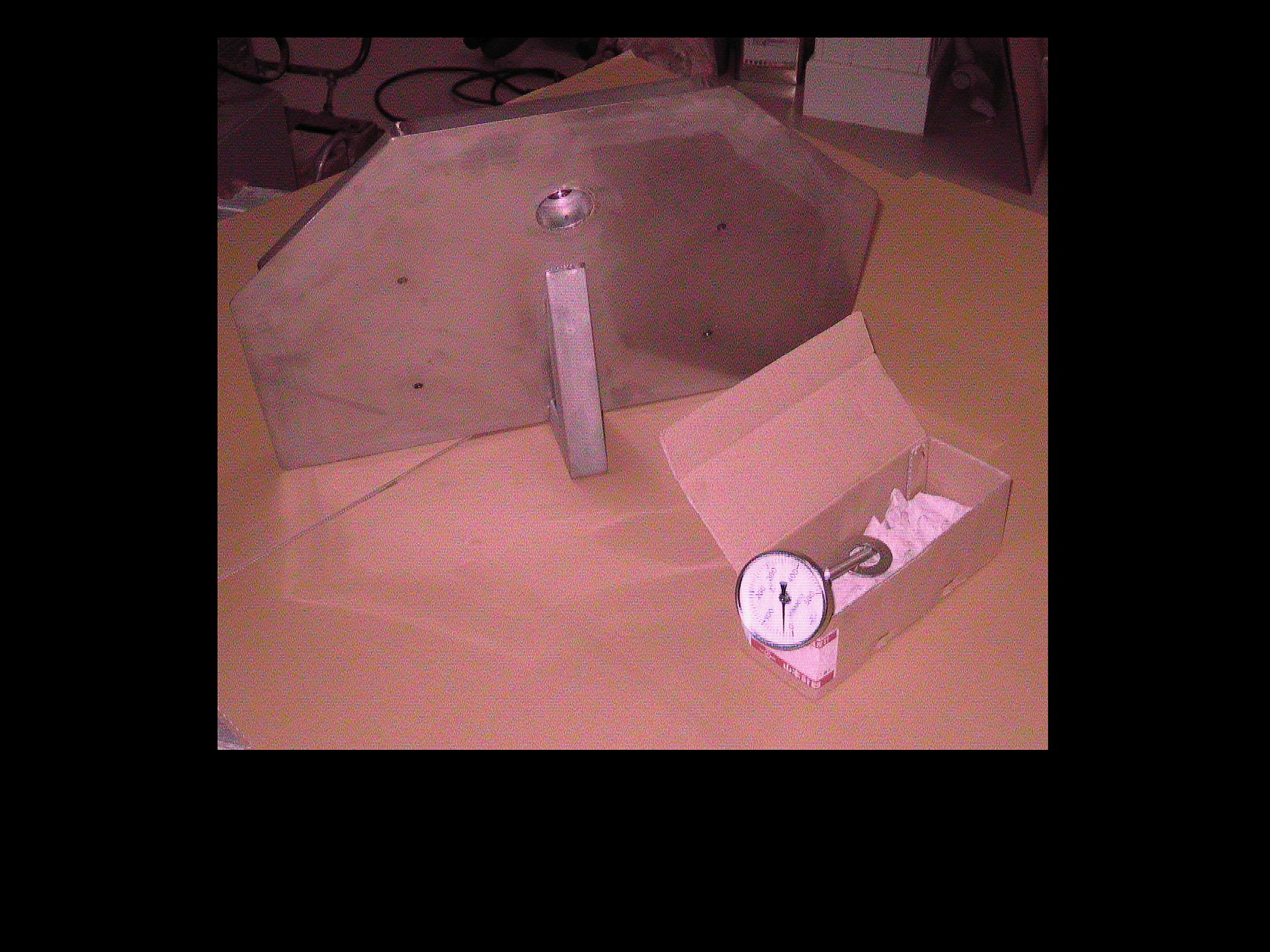

                Re: Show us your Door Thread
                Here is my work in progress door.
                No handles yet, but will be wood (some sort --yet to be determined)
                Can be disassembled now to install insulation inside--yet not installed.
                Will have a (wood stove type) rope gasket around top sides when finished.
                Thermometer will be attached by threaded coupling in door.
                  Nice door mikku:
                  Is any part of it welded? Or is it all bent stainless steel with screws?
                  I'm just asking because I'm trying to build my door now but I have no idea how to weld and would like to make it without welds.
                  thanks, Dino

                    • mikku
                      • Jan 2013
                      • 619
                      Originally posted by Dino_Pizza
                      Nice door mikku:
                      thanks, Dino
                      Dino- there are a lot of welds.
                      The door is the result of some horse trading if you know the term.
                      My friend is a professional fabricator who needed some carpentry work done.
                      I did the carpentry work for free, he fabricated my door to my plans--for free.
                      I think that I got the better part of the deal...he has all the tools to fabricate any shape imaginable...works with steel, stainless steel, aluminum--also can weld food grade (like making a cooking vessel-welding one side and inside is a perfect weld as well) his work is amazing.. the door is what I thought I wanted--screws are for disassembly to install insulation--later will be sealed with the stove cement and rope. I hope for him to make some of my tools as well---just need him to order more carpentry projects!
