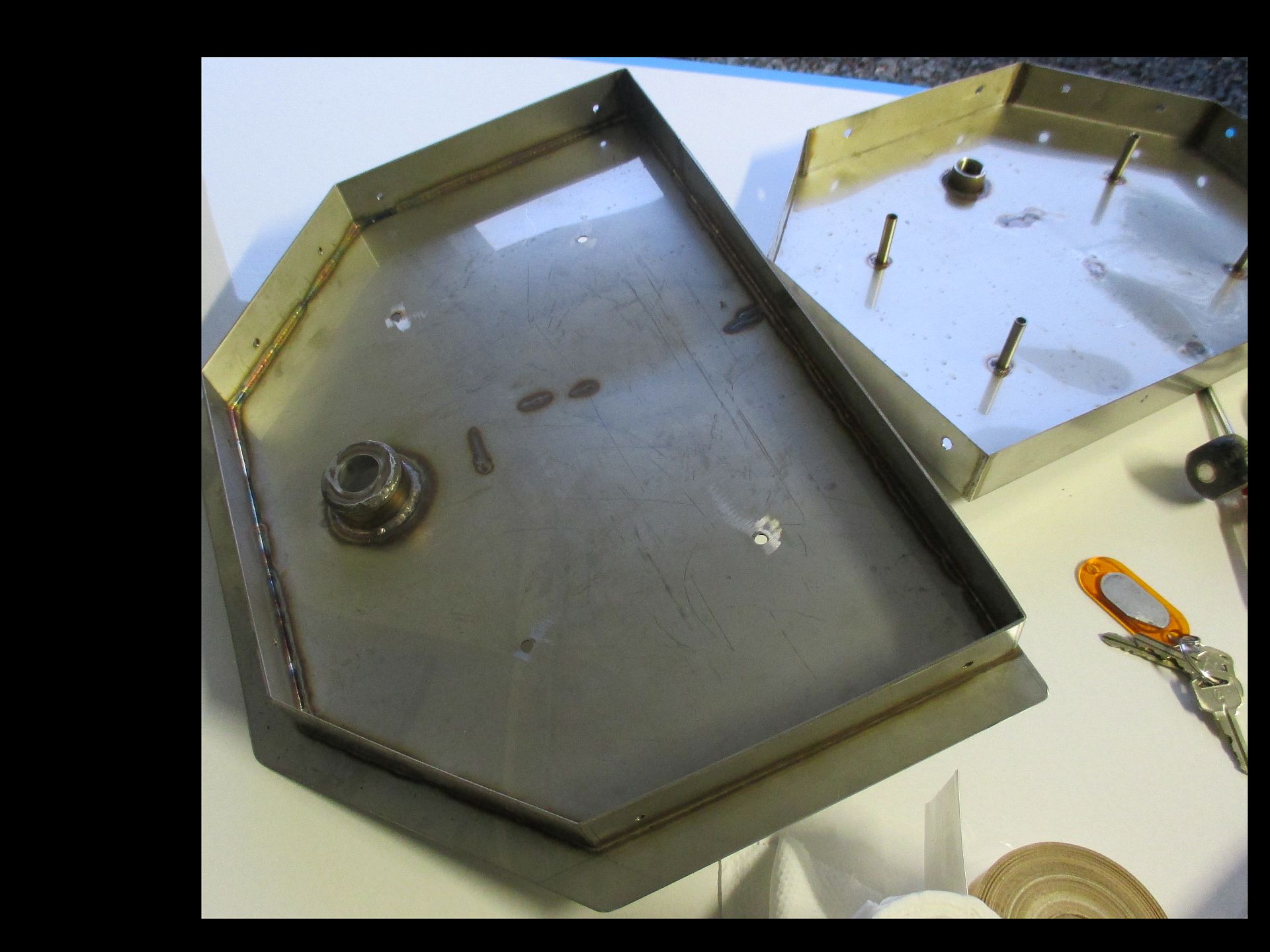

    I chose to have someone fabricate my door for me. simply because what I designed required precision bending of stainless, welding of a pipe coupling to a sheet of .8mm stainless, thru bolts or sleeves welded in place ---etc. All these things I can do if the equipment or tools are available to me---but it was easier to give a little business to my friend--horsetrade services at no money exchange--we both did things that we enjoyed doing (stresslessly) if that is an English word! As of today, I have welding equipment available to me-- I did an overhaul of a gasoline engine operated welder/ generator --and now I can weld to my hearts content! Even bought a welding hood that immediately changes from clear to tinted when an arc is struck... I am looking forward to a lot of little welding projects--- maybe part of the WFO enclosure and stand construction!!!

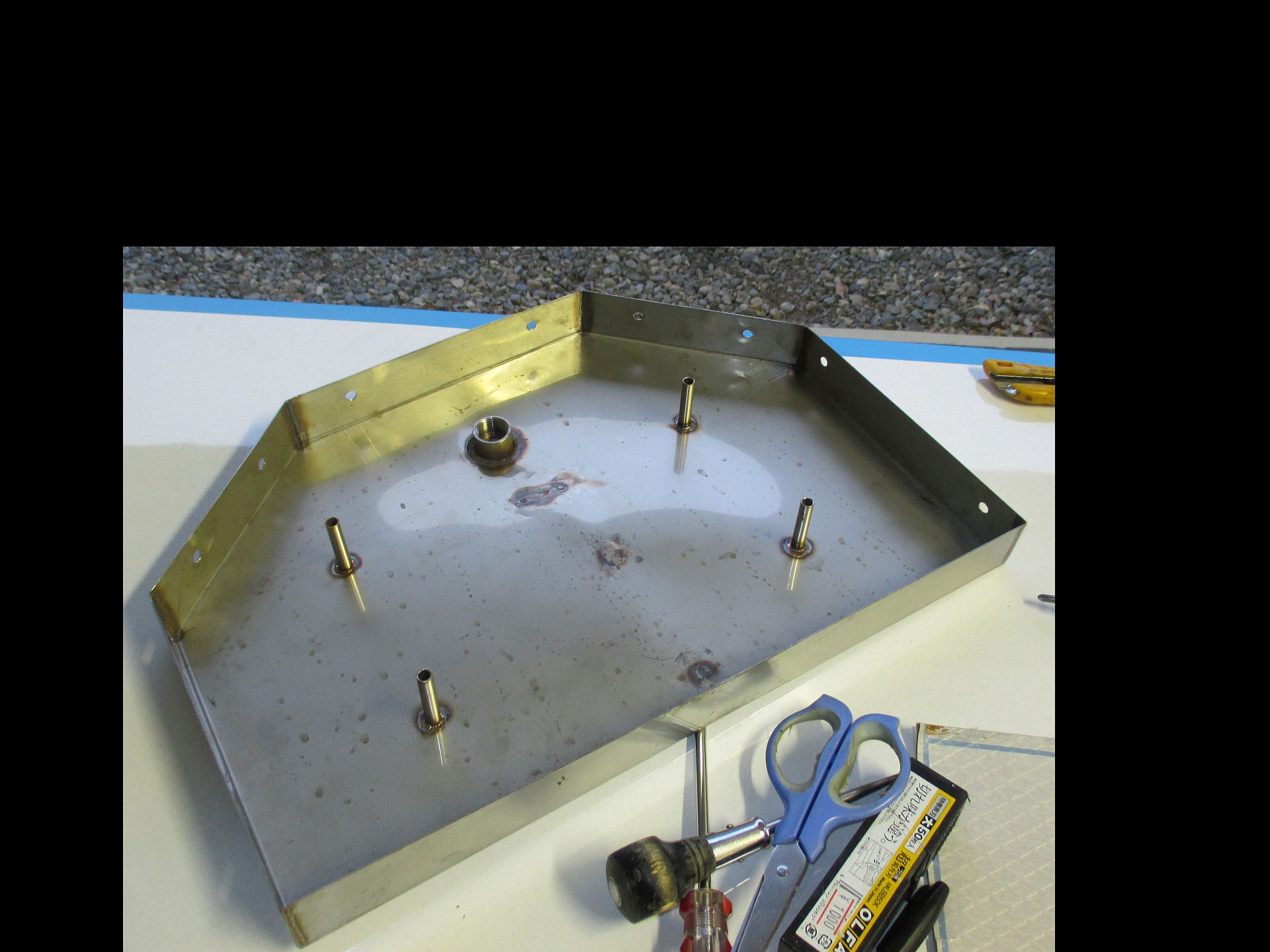

      Put ceramic fiber into my door tonight along with mounting the thermometer. Still have to seal the edges with stove cement and adhere the rope gasket material to perimeter. That is in the next few days along with the carved wooden handles..
      Here are the pics--pretty self explanatory, maybe you can see some of the welds on the door halves before assembly.

        Here are a couple more that you can see the welds required to fabricate this door. Really pretty simple if you have the right tools.

          Nice tig welds by your friend. Did by chance, did you ever ask you copper craftsman friend about possible ways for me to make a starter copper shingle?

            I thought the welds were nice as well. My friend (70) didn't weld it though, his shop foreman has a lot younger eyes and he is really talented. It is amazing to see some of the stuff they make out of stainless for local food manufacturers--nothing they do is standard.

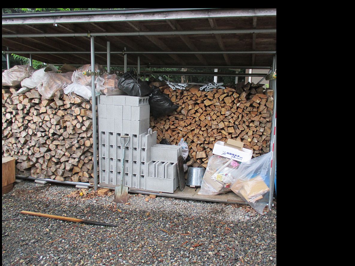

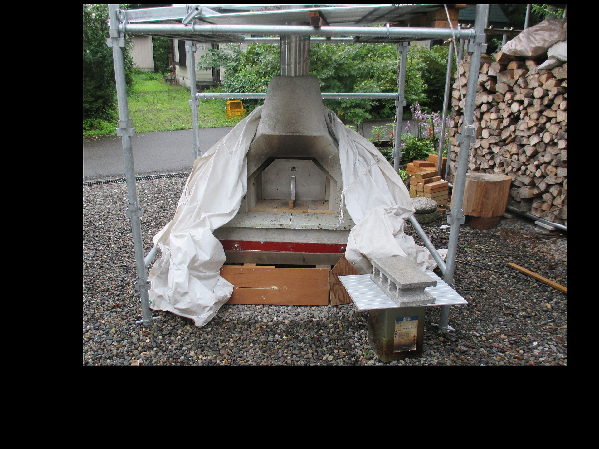

              Still no stand for the WFO, use pipe scaffolding and corrugated sheet metal to keep the rain away... Also doing pizza "Japanese way" --ON YOUR KNEES--
              Brickie might like that comment! At least I have settled on a location for the oven. Need to crash my wood pile structure and make a larger one that will accommodate the oven in the same construction...plan to make it out of 2" square tubing and c channel. Should be cheap enough and keep the weather away. That is the most important thing anyway...not trying to make an architectural statement. Just a simple build.

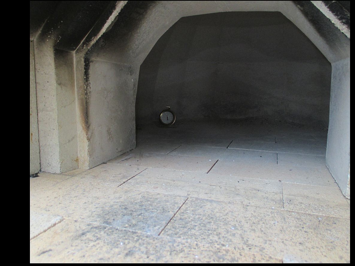

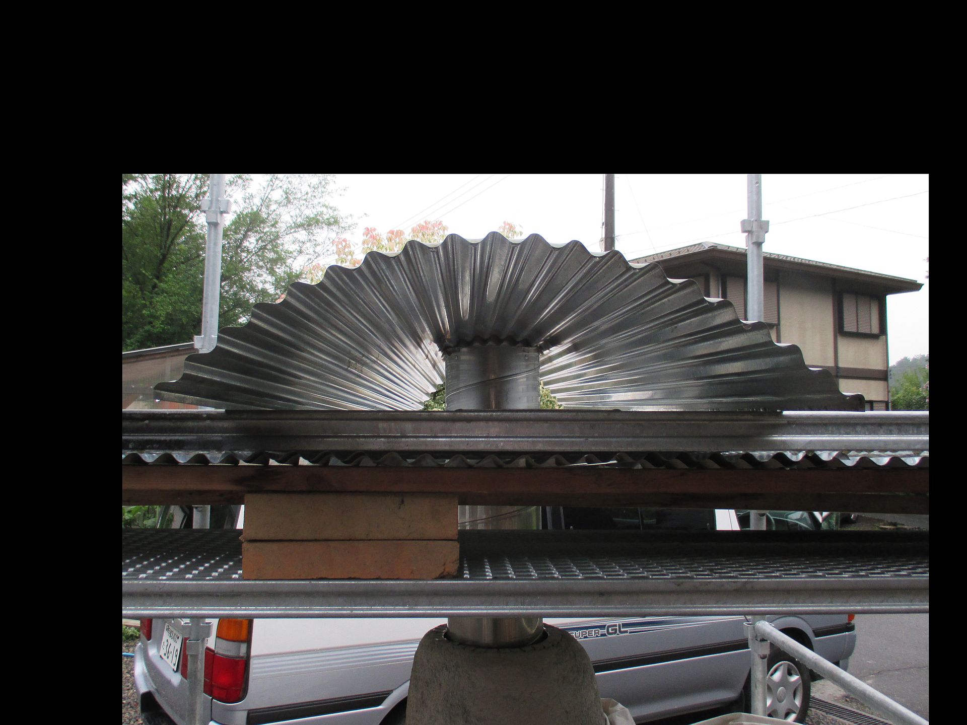

                Could not find the photos--now OK.
                scaffold WFO cover for week-end.
                wood pile structure to be crashed and rebuilt.
                chimney cap to keep rain out during a downpour! Man did we have rain both Saturday and Sunday--but oven still dry!
                View inside "crack less" oven after maybe 15 hot burns--still "Crack less castable" Harrah!!
