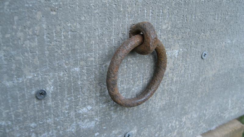

    My ghetto door until I make a real one.
Name:	IMG_1592 temp door.jpg
    The best part is the hitch ring...it came from a granite post next to a house from the 18th century I helped dismantle about 14 years ago.
Name:	IMG_1593 door ring.jpg

          Nice find. Because that ring has only one small contact point with the bolt, it won't get too hot.

            Thanks David. The center if the door is a perlcrete slab about 3" thick, and the pin is
            only about 2.5" . I think I'm going to use this on my real door, but Ill oil it.
                Gudday Stonecutter
                Did you caste the pearlcrete yourself and while I'm asking is it shaped to fit the revel

                      Gudday Stonecutter
                      Yes, it was an experimental panel I made a while back. It fit inside the pattern except two corners, which I trimmed off.
