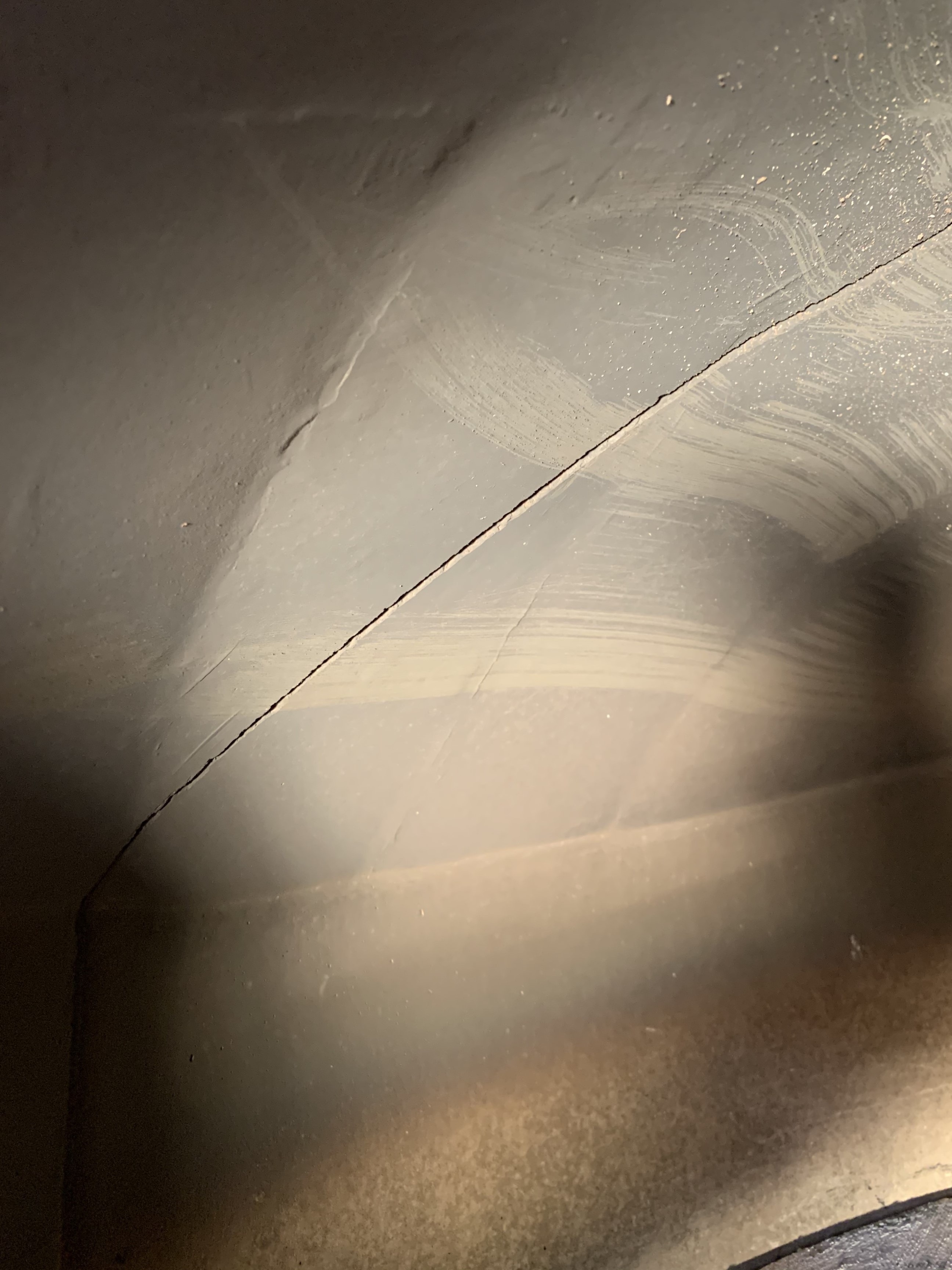

                      They seem to be extremely small, and after some reading, it seems that small cracks are somewhat normal. I wanted to throw it by the pros though to get a second opinion.
                      image is large, may need to zoom in.

                          Yesterday was the third curing day as mentioned, and we got the oven up around 350-400 degrees. When I checked the oven this morning after having the door closed overnight, I was still seeing high temperatures around 200-275. Looks to be ok for now?
