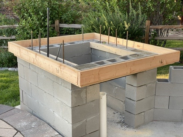

    Good morning from Denver. Most of my stand is complete and I am ready to form and pour a 3” slab for the top. Problem is making sure I am ready to mount the control box for the gas control unit. All of the photos that FB has sent me or that I have seen show the control box recessed. It is over 6” thick so not sure I want to surface mount it. Also, need to account fo getting access to the lines for install of gas lines etc. not sure if I should cut open block that has not had the core filled, mount it to the back wall of the brick so that it is recessed. Probably looks the best visually but the most complex for installing the gas lines. the other option which is easier, is to mount it in the top right corner of the wood storage opening. this would require a couple extra bends in the copper/stainless gas lines and the potential for wood banging into it. Also not as visually appealing. Here are some photos... please don’t judge too critically, never done masonry before. Hack job results may have made that last statement unnecessary. So the big ask is to show me how you installed your gas control box on a cement block stand... PLEASE.

        Thanks all, I started with FB and did not get much. That is fine. I got impatient and decided to just mount it to the top left corner of the opening of the wood storage. Not ideal but it will be fine. Here is what I got done today

            I totally get that. but I think the solution is workable and was getting no where on how to mount a 5.25" thick control panel in an 8" thick block in a way that keeps stability and gives access to remove it and install the lines.
