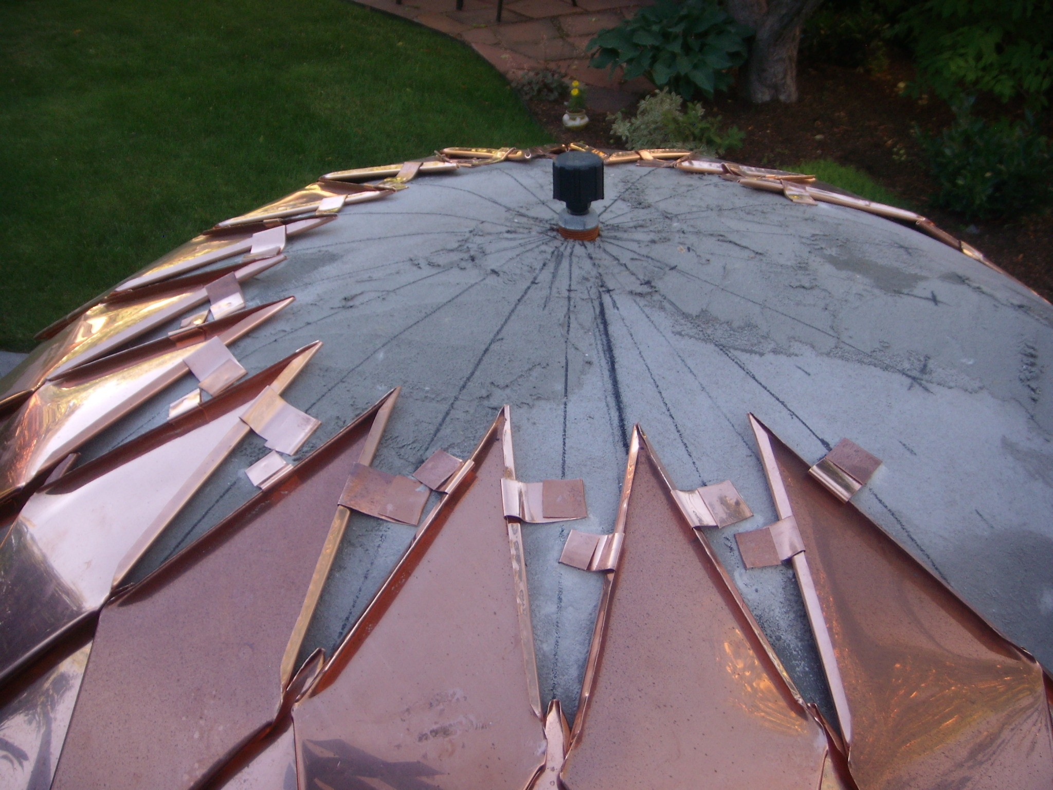

          A vent at the apex would be good preventative maintenance since you are at the pcrete stage you can still install with a little work. This allows any water vapor to escape since when water sublimates to vapor, the volume increases by a factor of 1500 which could cause pressure build up in the dome and crack it or the stucco or the finish coat. There are several options but Gulf and I use a breather vent available at any car parts store for less than $10.

            I had seen that you guys had added those vents. I actually added two using copper pipe. It's hard to see in this picture, but I put them up on the back side of the oven. I hope they work. I'm going to let things cure for about another week, then start the fires. Wish me luck
            • #21
              Those should work you just need to screen off so bugs done use as a some and plug off. I have seen other builders drill holes in copper and cap off end. There is a lot of water in pcrete so a week may not be enough time.

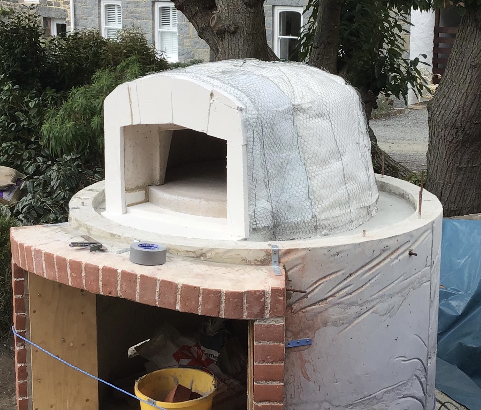

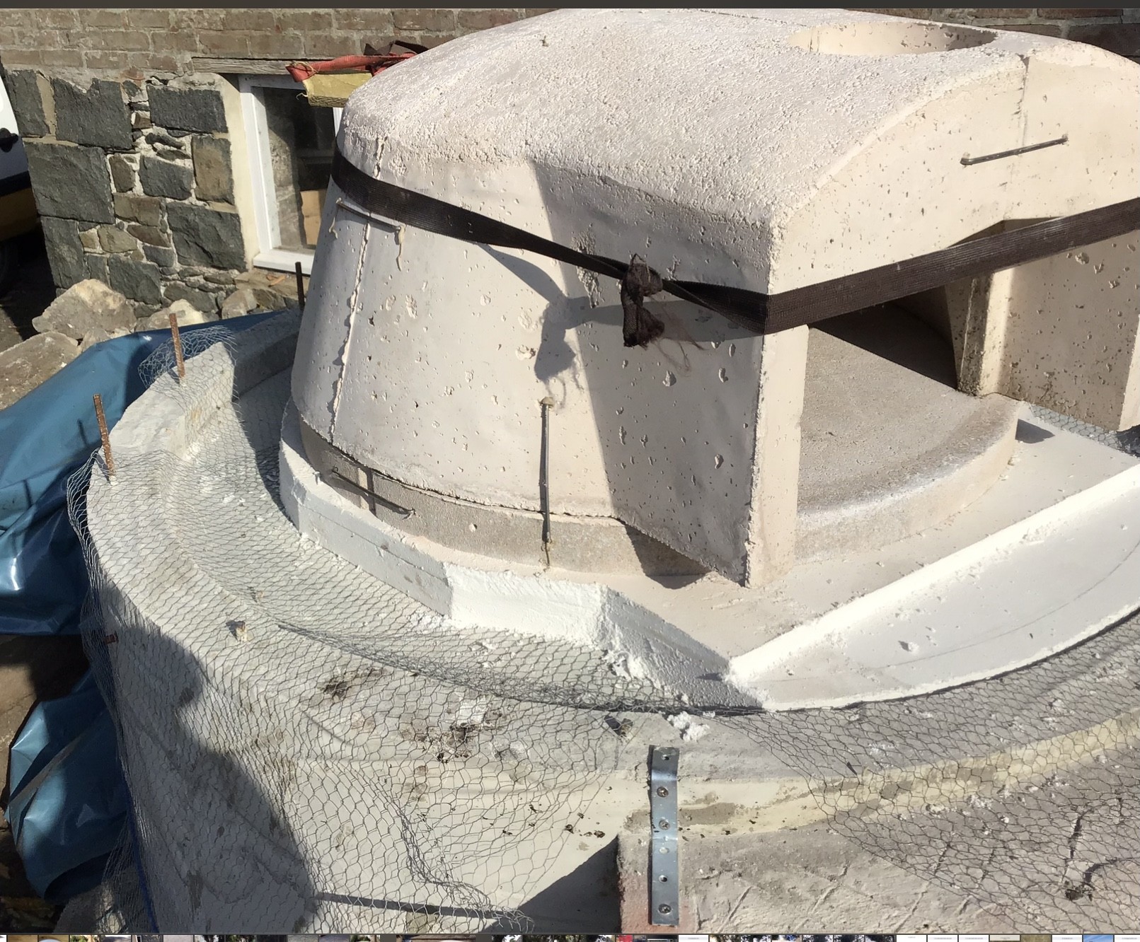

                          How did you secure the lathe over the insulation? Looks like tapcon screws, are they just directly in to the material of the dome? I have a 6'6 hearth pour and working on setting the base foam and floor this weekend but want to make sure I'm setting it right for the lathe. Just going to do the insulate and stucco cover rather than a custom mix, unless there are thoughts from the experts?
                          • #28
                            I helped a friend install a CasaG90 several years ago at their lake cabin. We laid sections of chicken wire underneath the rigid insulation board prior to setting the oven sections/cooking floor on the board. It was a little bit inconvenient having the loose wire sections there but put some cardboard on them until oven was assembled. Then we applied the ceramic blankets and simply brought the wire mesh sections up & over to hold the blankets in place and to provide some base for our outer stucco layers. Wire mesh was cut & secured with wire pieces to hold it in the dome shape prior to applying the layers of stucco.

                              That is the method i use too, place the mesh down first…..

                                The manufacturers build instructions should be followed, but I abandoned the use of lathe or chickenwire years ago for three reasons. Firstly getting the stuff to conform to a compound curve is difficult and time consuming, especially over a small oven. Secondly, having a highly conductive material in the insulating layer is counterproductive. I use a 10:1 3/4” (35mm) thick vermicrete layer over the blanket and this is sufficient to hold the blanket in place as well as evening out the uneven surface and restoring the spherical form. Lastly any compression of the blanket, caused by tightening the lathe or chickenwire will reduce its insulating capacity. I prefer to use random mixed reinforcing fibres in the outer rendered shell for much the same reasons.
