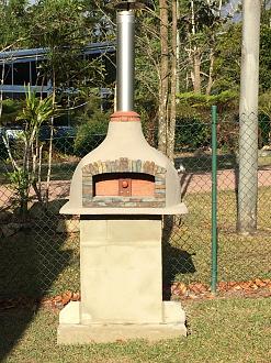

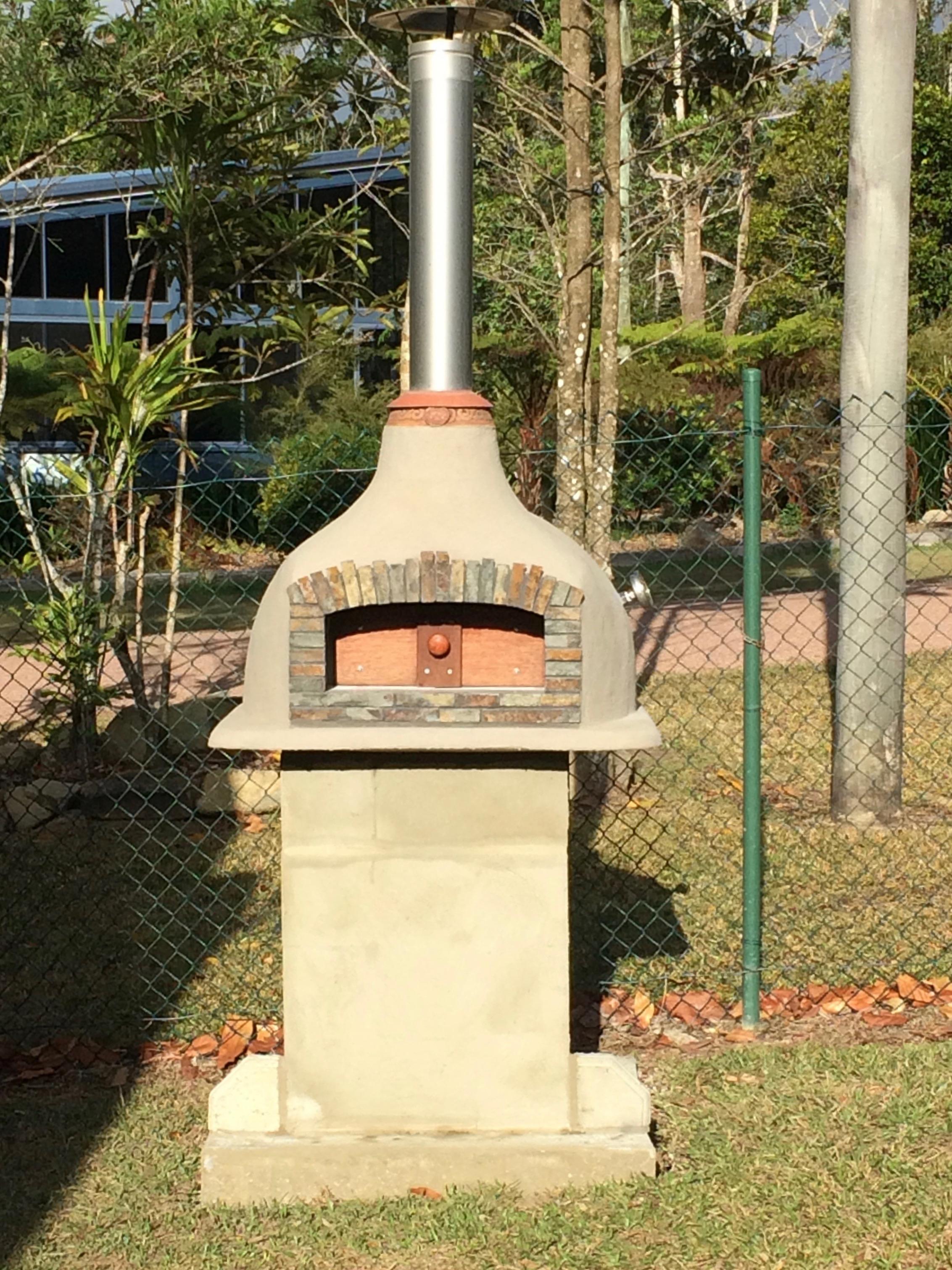

            I was concerned about mosaic tiles on the outer decorative arches on my ovens in terms of the heat cycling causing them to fall off. I went ahead anyhow and haven't had any failures in more than 15 years. However a customer who purchased one of my ovens 12 years ago recently contacted me and reported that several of the slate pieces on his oven were falling off. He fires the oven regularly once a week, so it's had plenty of use. Contemplating this issue I rememberers that another customer with a slate arch also reported that one of the pieces on his oven had fallen off. On researching the thermal conductivity of the slate, it turns out that it has a lower thermal conductivity than clay tiles which are similar to standard concrete. This would set up an incompatible thermal expansion and presumably is the cause of the failure.
            I use a quality outdoor tile adhesive and always recommend glossy tiles and black grout, which makes it easy to clean off any soot staining.I will skip the slate decoration idea, a pity because it looks great.
