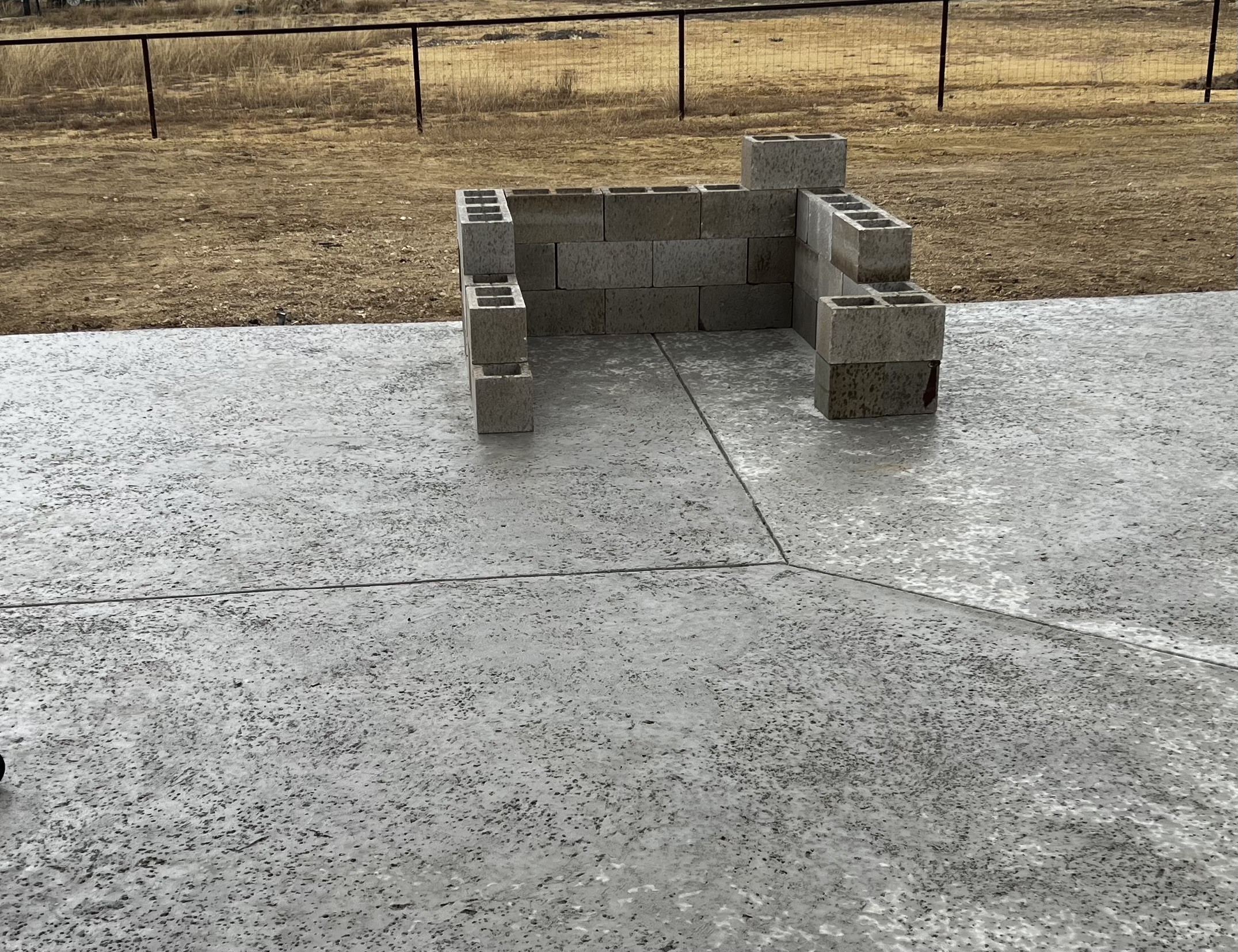

    Foundation:
    Extended my patio to make room for oven area. 6” with ½” rebar.
        Base complete ready for Dome!
          Be sure to drill some weep holes under the dome area. We insulation a key reason for poor oven performance.
            Absolutely! I set 5, one center, 4 perimeter with ½" PVC pipe into the form before pouring. I believe I saw one of your posts about this subject pre construct research. Thank you

              Photo's of weep holes and the base pour
              • #8
                I cannot give you direct experience on the cracking of the joint mortar for an FB oven since I did a brick oven. I suggest you email FB support directly and get their take on it. IMHO, the FB cast pieces over lap and the mortar is not for strength but rather fill the joint gaps and minor crack should not be an issue.
                • #9
                  I helped a friend install a Casa 90 several years ago and we had these same kinds of cracks develop in the joint mortar lines. As Russell noted above, these mortar joints are really about filling the gaps. Those cast oven sections do move significantly during the firing cycles and if we removed the outer insulation/facade on any of this type of cast oven you'd see cracks in all those seams.
                  Your hearth & weep hole setup looks great. Don't forget to cap/cover the weep hole tubes underneath with insect screen. Next layer is your upside down mosaic tile squares to provide an air/moisture gap below your floor insulation. Great start!
