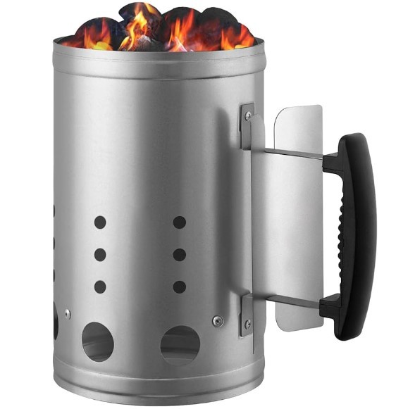

              #21
              If you have a chimney starter, if makes it easy to load into the oven. Gulf does this as well.
