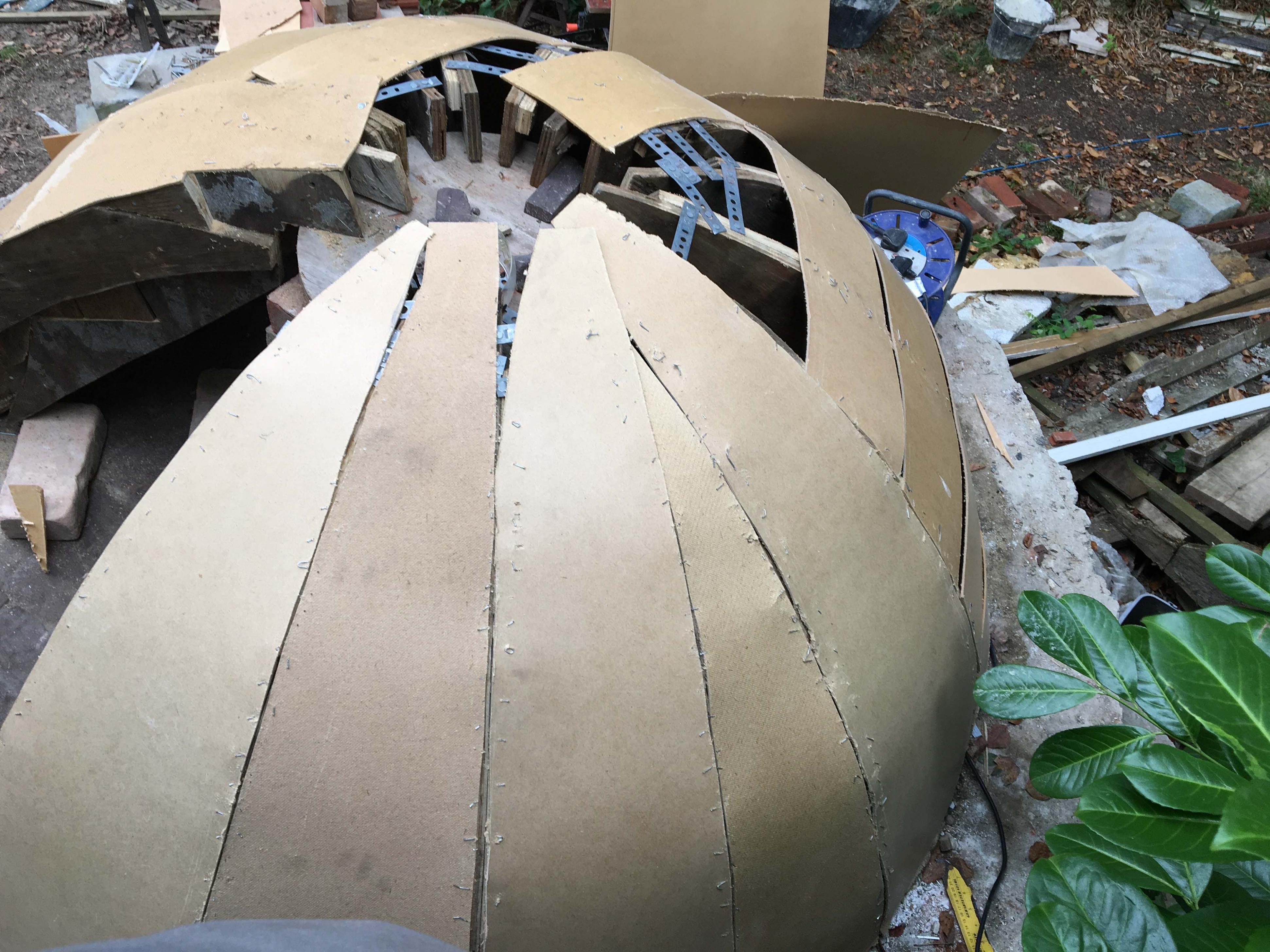

                    After 4 years of neighbours complaining to the local council, sabbotaging my electrical cable to my allotment and following a threat from one of my sad alcoholic neighbours, to have a fist fight! I have decided to stop reinventing the wheel, I have decided to listen to the wise voices of many here including Karangi Dude and david s .
                    I have decided to demolish the red brick soldier bricks and restart with the proper way by using firebricks.
                    I have created a moulding frame made of timber for the dome, made of the weathered timber that has been sitting in my garden exposed to the element for 4 years.
                    Please forgive the brick laying standard as I have never laid down a piece of brick.
                    My work is very messy and does not live up to the standards of the rest on this forum.
                    the internal diameter is now 192cm, The internal height of the dome is 75c
                    m.
                    The cost of a single fire brick in Surrey, UK is about 4 each + Shipping. I have purchased in access of 840 bricks.
                    The project is well over budget and over sized and running 4 years late! Now I have restarted and racing against the English weather. I could not put a gazebo as the neighbours are getting mad with me with numerous retired busy bosses around.

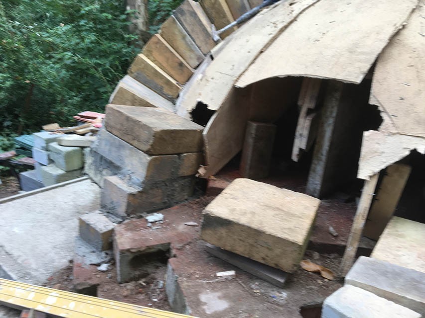

                    • #40
                      Unfortunately, I am using only the grinder as I couldn't bother to rent out a proper cutting machine sue to esceeding my budget. Hence the brick cutting looks a bit wonky!

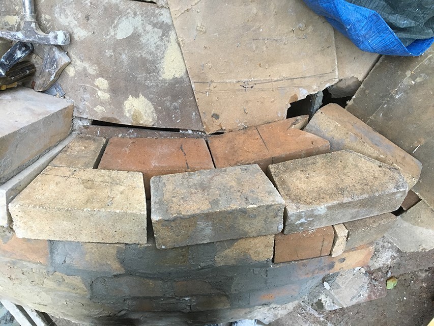

                      • #41
                        Hopefully I will cement in the arch and publish more images tomorrow.
