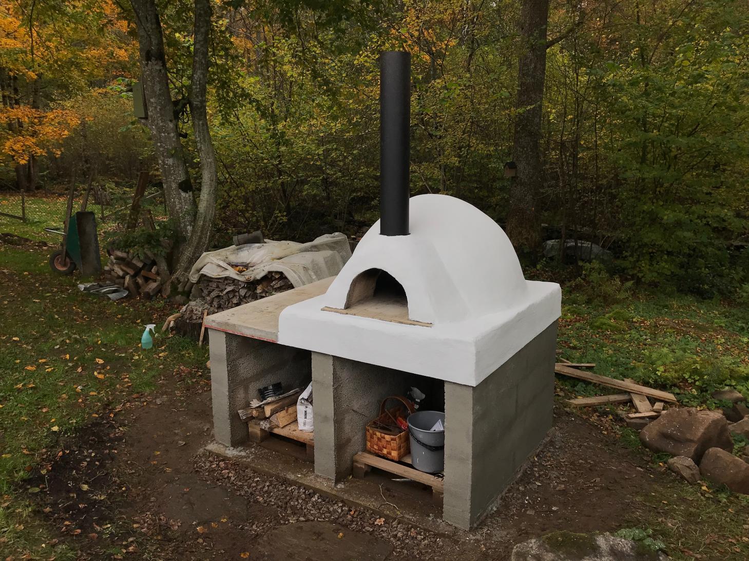

I would like to share my summer project. I found a lot of helpful information here and maybe someone can find this helpful.
I apologize if i use incorrect english terminology.
I first made a concrete slab of about 10cm with rebar. I made a base using LECA-blocks and mortar. On the top i stabilized using old wardrobe-bars and put a sheet used for casting on it. I then made a concrete slab about 5 cm.
Click below for photos.
part 2 in next post.
/anders
