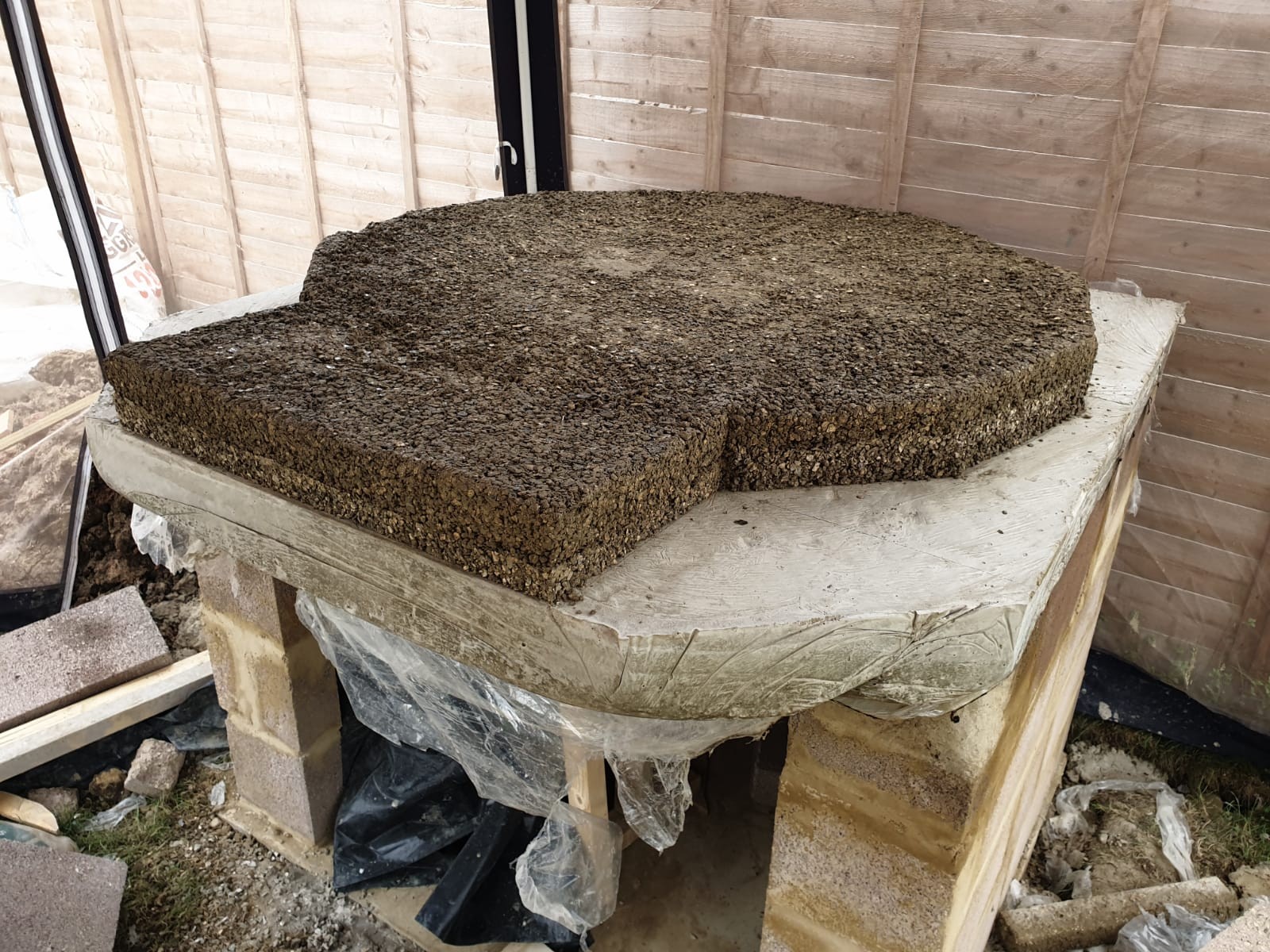

My first 2 inches/50mm of Vcrete used 100L of Vermiculite, so I had to do it in two pours, seemed to work out well, also helped speed up the drying process I think.

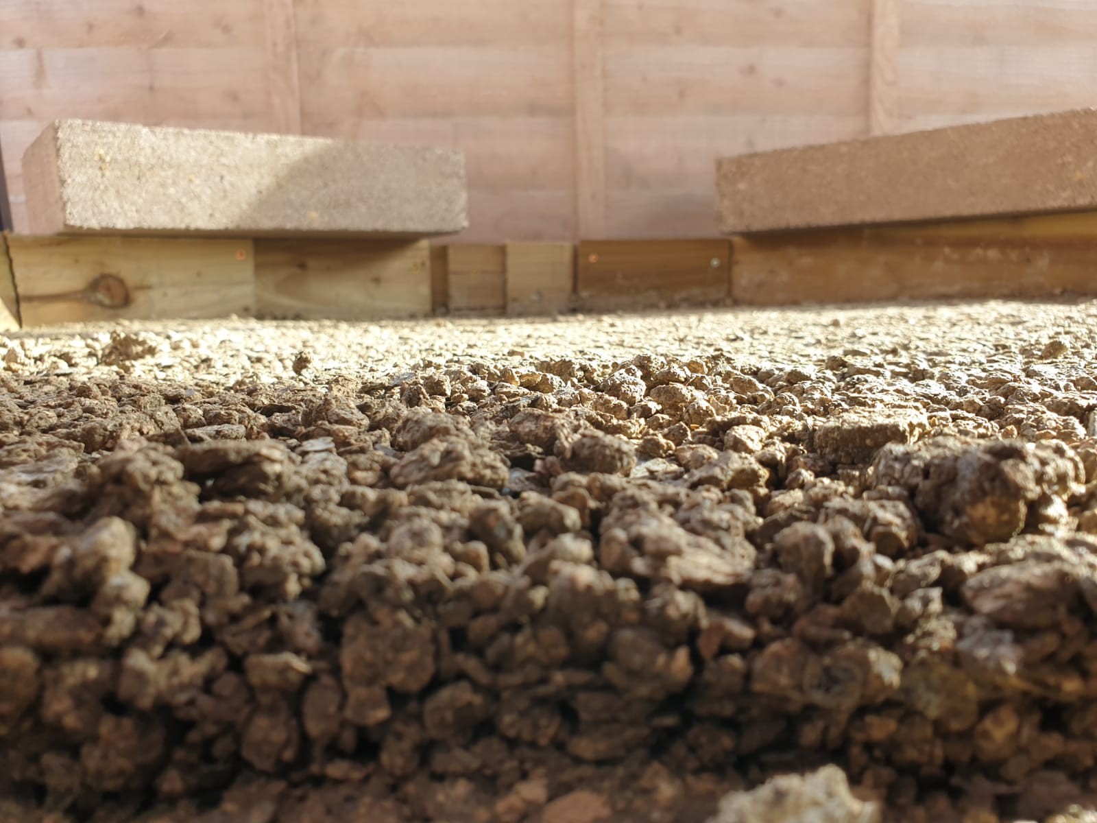

It was kind of hard to get this super smooth and level.
It seemed the more you work to the Vermiculite seemed to get damaged? But it did leave a nice flat-ish surface.
(see photo, low angle)
My form was thrown together with scrap wood, but it made a pseudo circle, which will be neatened up once the floor is down.

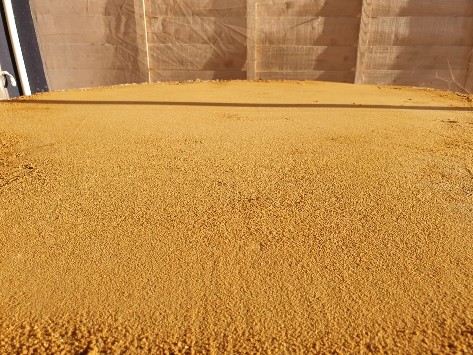

On top, I put a very thin layer of sand and made sure this was very level and smooth.
A mist of water and let it dry overnight, left a semi-firm bed for the bricks.
