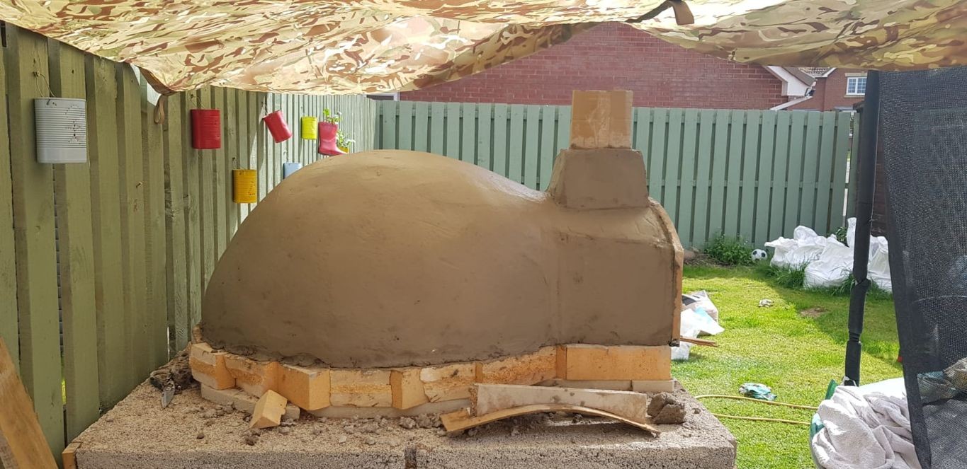

    replied

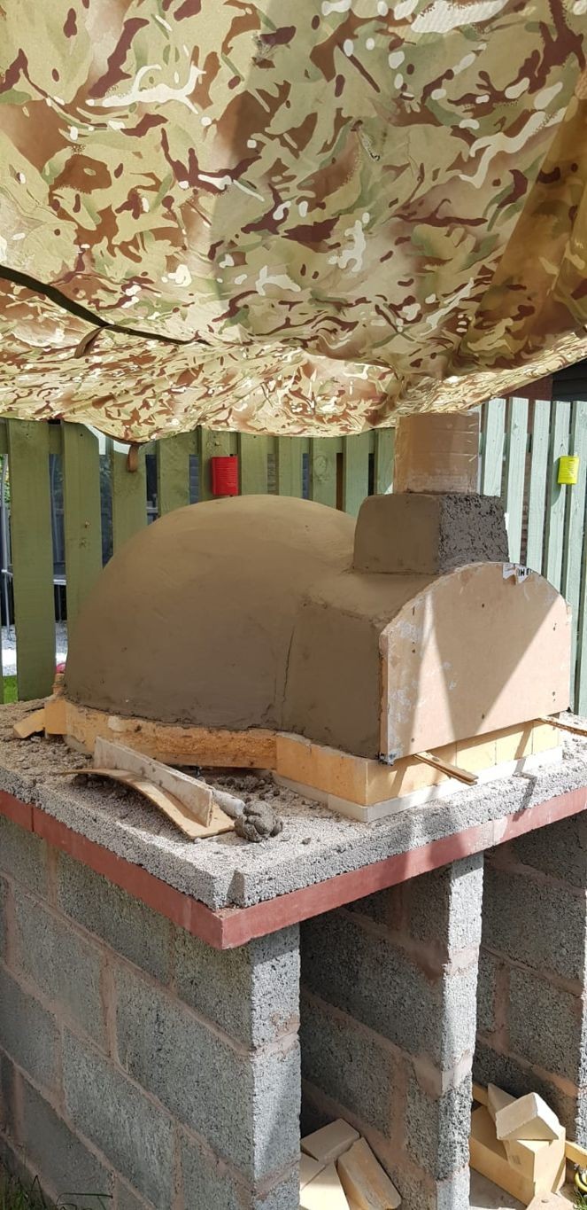

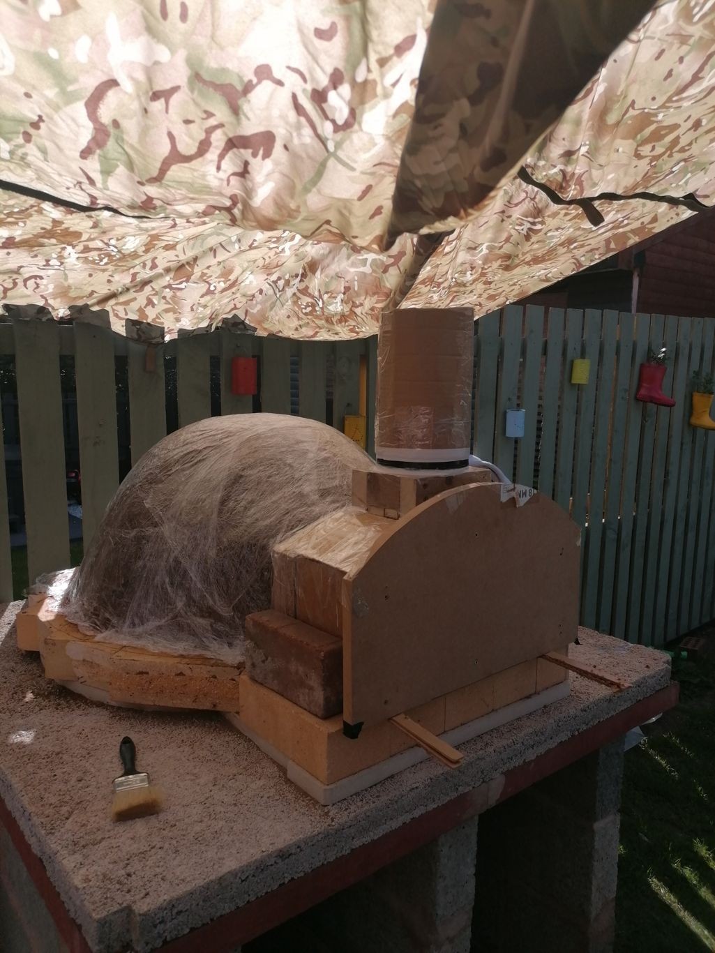

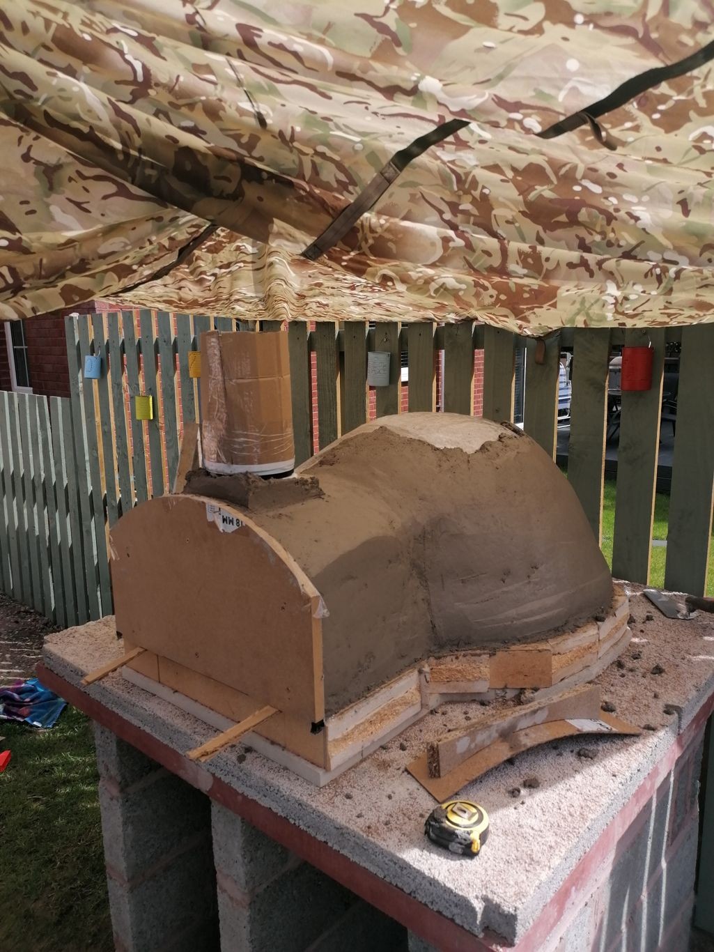

    That looks ok to me. Sudden corners tend to be weak points and a more funnelled flue gallery would have addressed this as well as perform better, but I think you'll be fine. Allow a couple of days before remoulding, then remove the sand, inspect the inside and fill any voids with the homebrew mix (you can sieve out the larger grains of sand for this) then damp cure the casting for a week.
    Leave a comment:
  • Daveholdn
    replied

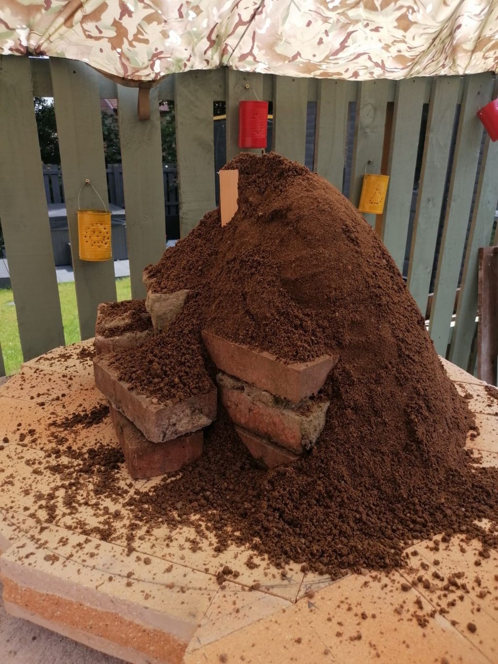

    So I cast today, was a lot hotter than I thought it was going to be so completed it in 5 batches! Mixed by hand as my mixer never came through so thanks david s for the heads up of consistency required. I weighed the dry mix of each batch and worked out 2.5% for the ss needles required for those about to cast.
    Overall happy, the homebrew was nice to work with, better than the sandcastle, but think I've got carried away with the flue, I think I've gone too high and no idea why I made it square when it's cast round a circular 150mm diameter object, I'll put that down to "lost in the moment"!! I also forgot to put the tapered sides on the flue, totally forgot, will this be a problem in anyones experience? And will the height of the flue I've cast be a problem or can I cut once cured?

  • Nick J C
    replied
    I did mine in two mixes, although it wasn’t too hot a day. Lasted a lot longer than the render mixes, which needs to be sloppier
    Leave a comment:
    replied
    No it needs to be stiffer than mortar. Use "ball up" consistency, ie make a ball about the size of a cricket ball toss it 2 ft in the air, you should be able to catch it intact.If the mix is too dry you will get too many voids, if too wet it won't stand up vertically and will shrink more.

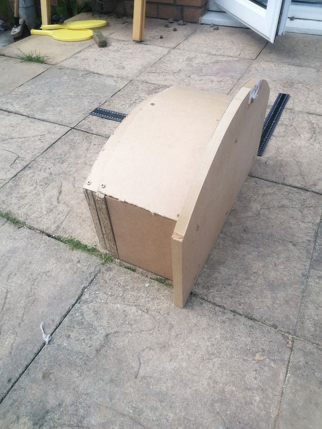

    Yes, that’s the reason I keep suggesting that you should cast the oven first, remove the oven mouth mould plate then place the flue gallery mould against the dome cast and then cast the gallery. It is normal to create a “release” when designing a mould. That is to make it slightly tapered to allow for it easy removal. Definitely place some wedges under it so it can drop after it’s cast. Do not force the mould out or you can crack your casting. If it won’t remove easily attack it from the inside with an angle grinder and remove the pieces carefully. Polystyrene is a better material than MDF for this mould as it is easier to remove without damaging the casting.

    Click image for larger version  Name:	IMG_20200714_193946-01-01.jpeg Views:	0 Size:	364.2 KB ID:	426029 Click image for larger version  Name:	IMG_20200714_193942-01-01.jpeg Views:	0 Size:	384.0 KB ID:	426030 Click image for larger version  Name:	IMG_20200714_194000-01-01.jpeg Views:	0 Size:	368.3 KB ID:	426031 Flue gallery form is almost complete, I used mdf and hardboard but will ensure they are well sealed so the water doesn't get in and swell the boards. I've still to put the funnel for the flue on, but with regard to dimensions, is there any best practise here or is it just a case of ensuring the funnel is big enough to fit the 150mm diameter flue on? (using the good old delux paint tin as seen by other builds) Also, if there are any experts on the gallery, I'm a little concerned my oven mouth depth is a little short, it's currently just over 60mm before leading into a 1/2inch lip for the door. Will this depth be a problem with smoke or should be OK?
    Cheers

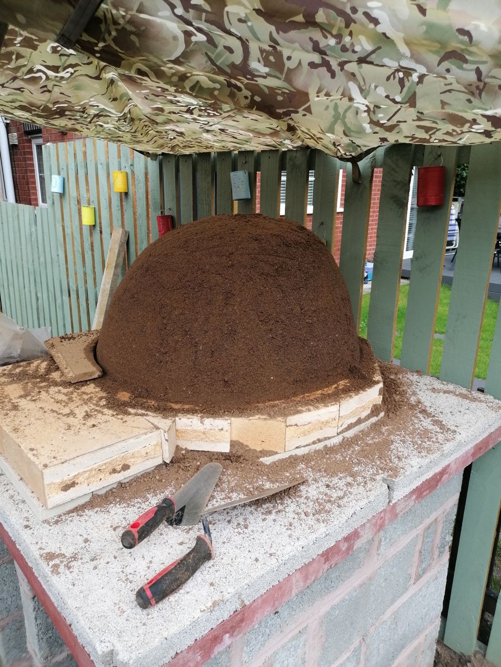

    Haha cheers Mullster, I think I'll leave the grinder for now, try and level them using dry fireclay and then see how it is. Did you find the sand from the mould filled in the small gaps between some of the bricks? I was gonna try and brush some of the mould sand into the cracks but unsure if normal sharp sand isn't the best for the this? Did read the somewhere, Ash from the subsequent fires is great at that and provides some kind of natural insulation?
    I'm gonna try and mould the sand this weekdn and cast. It's getting real
