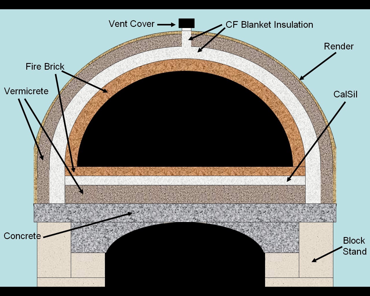

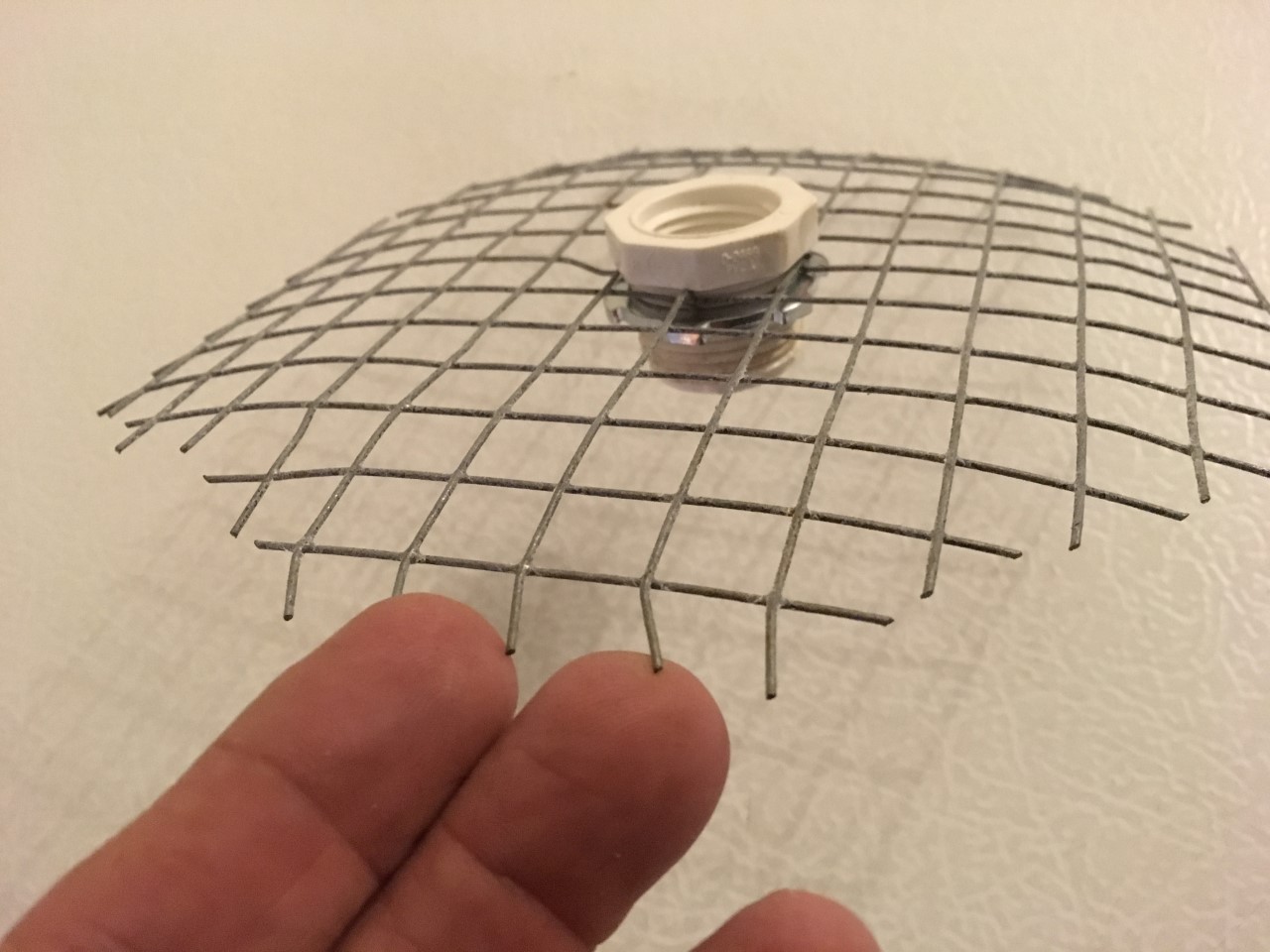

            I've never seen a need to insert a pipe down in the hole. The hole just needs access to the blanket insulation layer. This is how I anchor a pvc bushing in stucco/render. This link to another thread has a little more of explaination

            Click image for larger version  Name:	Insulation and Vent.jpg Views:	0 Size:	266.8 KB ID:	428584

              Mullster,
              I see now that you have been researching this on another thread and are having a problem filnding an actual breather cap. Until you find one a pvc plug can be threaded into the bushing that I show above when the oven is not in use. Also, a short "gooseneck" vent can be made real easy out of pvc fittings. You will need a 1/2" pvc threaded male adapter, two 1/2" pvc elbows, and two 1/2" pvc pipes cut to about 1" in length. Glue them together and a little latex paint will make the gooseneck vent a little more presentable

                  Hello Mullster, I think you are way past the installation of the pipe, but just for giggles here is my 'low tech' approach. I stuffed a tiny brass screen into the downward facing ell for a bug stop.
                  I know everyone prefers the apex of the dome but that space is full of blanket so I don't think there is any convection happening that will allow hot air and moister to rise to the top.

                    Mongo that looks like a cool solution. I think I probably will pipe it now - I have the vermicrete layer to get through but as I say haven’t rendered over that yet so I think it’s still feasible. I obviously can’t create the ‘base’ for the pipe like you did because I’ve already done the vermicrete layer.
                    By the way - your dome and blanket and wire mesh look so professional!!
