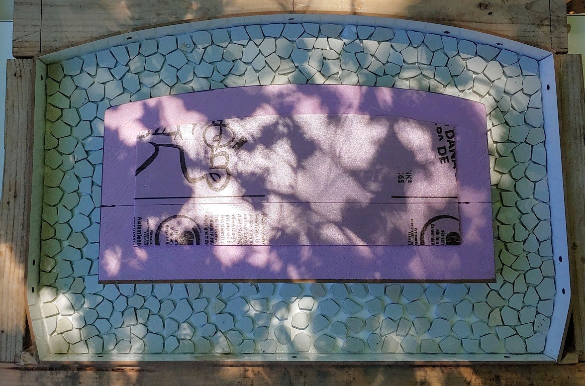

    I really like your front or your oven! Looking for tiles like them .
    Did you used tiles that are resistant to frost? What would happen if I use standard bathroom tiles break them to mosaic the outer arch. Would frost break them
    What ratio did you used to make the front (outer arch) (portland:sand:sealer) any special sand for the white colour?
    Would it be possible to add the broken tiles them on a later stage (after I find suitable tiles)

      If you add an extra blanket layer you can reduce the thickness of the vcrete layer above it to 30 mm (according to David) though I don't think it is always easy because that stuff goes on thick. Fluffyness - yes, correct, don't worry about it unless you are doing something weird instead of simply laying on vcrete. You will see what I mean when you get there.
      Thanks on the facade! I did a really stupid thing with it. I glued the tiles to the bottom of the form with silicone (see the picture). I have since spent hours scrapping silicone with a razor blade and most of it is still there (I also got lucky with a really fresh tube of silicone!!!). Don't use silicone. I was afraid of the concrete getting under the tiles so I would not be able to see them. Lots of guys on the forum embed stones or glass in the bottom layer when casting and then polish it. You can't do it with tiles. I wonder if it would be easier to cast a facade and then glue tiles to it later and grout. I don't know if they would stay when heated or frozen. No idea on the frost resistance either but they are small pieces and they don't crack when heated. Hopefully ok when frozen. I also like the tiles because it is very easy to clean with a soot cleaner.
      I have used a hi-tech countertop concrete mix, same as I used for the hearth foundation and the tabletop next to the oven, with 1/4" rebar. I didn't want to bother with mixing concrete components myself, everything I used was a commercial mix (except pcrete and even then I managed to mess up using electric mixer - don't!). Also, forget the white color - gaps between tiles are now black. Soot only comes easily off the tiles, not off the concrete in between.
      Also, make sure you mount the facade like David suggests. Mine has stainless steel wire embedded in it that goes around the chimney adapter and there is a good size gap between the inner cast and the facade.

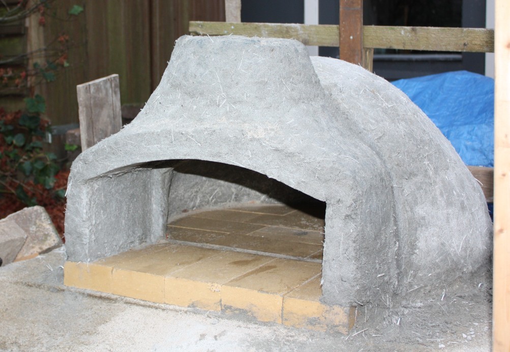

        Maybe a stupid question, but would a entry(oven front) of some nice hard wood be an option or would the wood become to hot and break or even catch fire?
        Of course I would add a heat break of a ~8 mm between the entry and the front arch just an empty space (or some vermiculite barrier) .

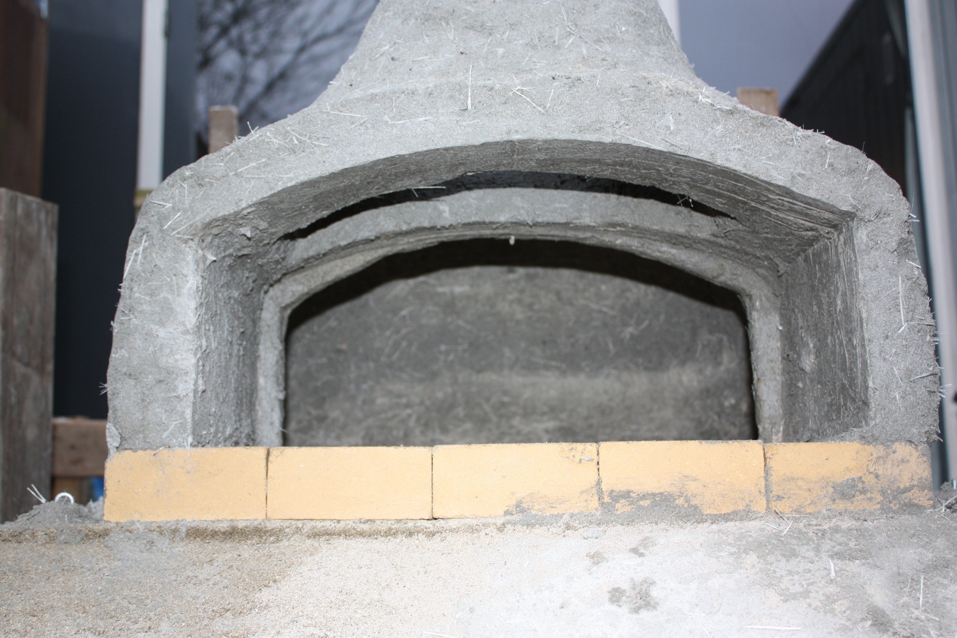

        Here a photo of the where the oven front should be made

          And another one. show the flue gallery. Hope hot air will take this route......

          • #35
            Looking great!
            Judging by my oven, a wooden facade will catch fire very quickly. When you are heating up an oven quickly the fire will go into the chimney. It gets hot, very hot very close to where the facade is.
