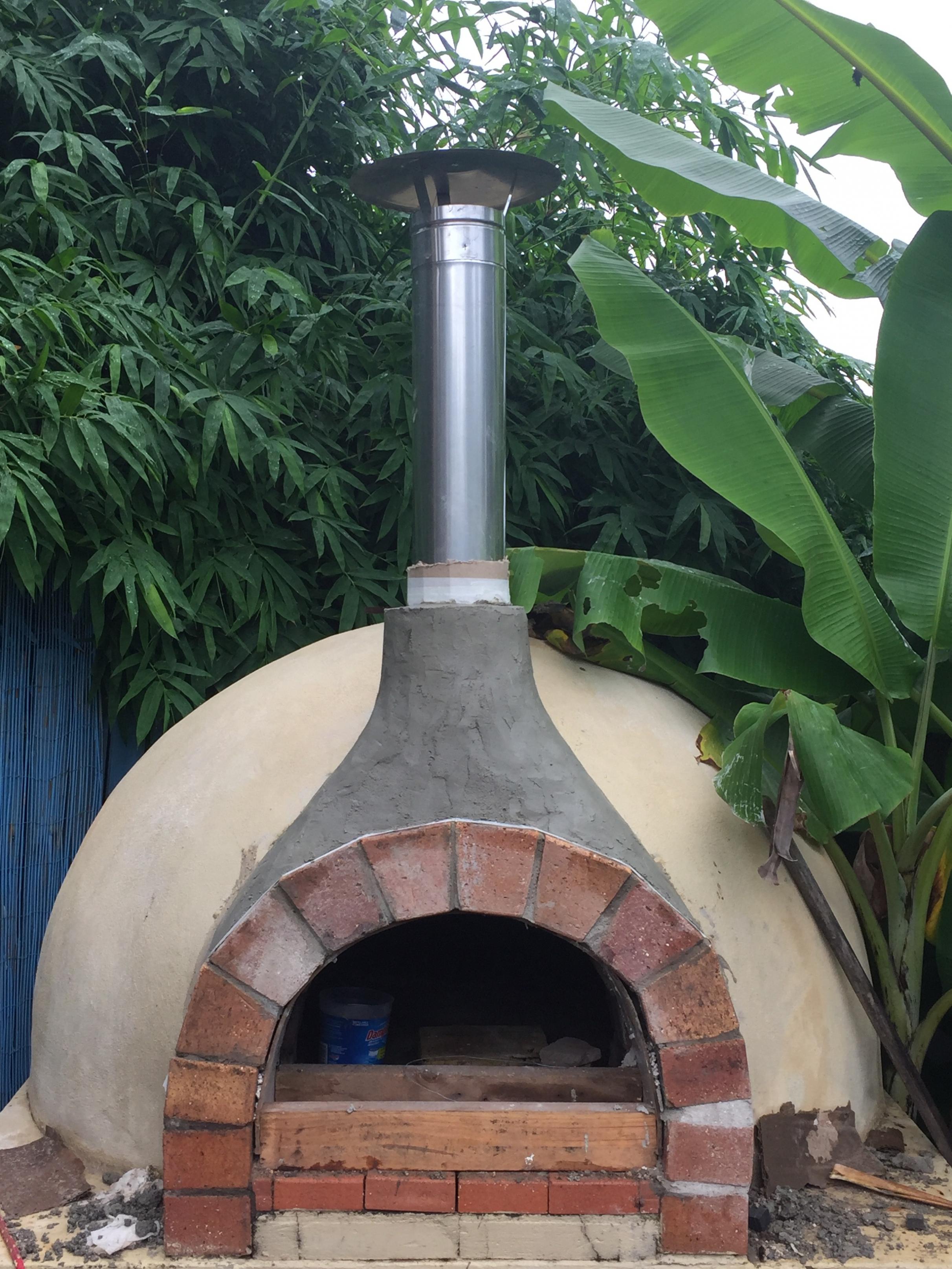

          I have a small 'issue' with my flue.... So for the flue pipe stucco I followed the idea of David S. Where he leaves some room for expansion of the metal flue pipe so it will not break the concrete/stucco.
          So around the Flue pipe i packed two layers of cardboard (~5 mm) then some chicken wire (to fixate the stucco) and sticked approx. 1 cm / 2 cm of stucco.
          The Idea was to remove the cardboard if the stucco / concrete is cured. Than fill the void with vermiculite or perlite. But ..... this does not work The Cardboard is stuck between the flue and stucco.
          Did someone had the same? How did you fixed it? Would it be an option just to fire up the oven and see what the cardboard does?
          My build 60 cm/24'' homebrew, the Netherlands
          • #50
            I wrap some plastic around the cardboard for easier removal, but you should still be able to dig it out. High temperature silicon is a better material to fill the gap than vermicrete, as rain tends to run down the pipe and you want a decent seal there, but vermicrete should still work ok.
            Actually the last one I did I did not wrap plastic around the cardboard, but used masking tape to hold the cardboard in place and brushed a little oil around it to act as a release agent.

                  Had to redo the concrete / stucco around the flue. I could not get the cardboard removed. I rebuild it and I followed David's advise. and tried release agent (oil). Hope it will remove.
                  If the material around the flue pipe is removed there will be a void (for expansion). What do you think:
                  Would it be advised to fill it with perlite OR with 1:10 Portland/perlite OR just keep it empty?
                  I will close the top of the gap with a Heat resistent silicone (that will be very hard (not flexible) if dried)
                  • #54
                    My guess would be it doesn't really matter because the high temp sillicone already keeps the rain out, which is your primary concern.
                    I don't see a big difference between keeping the gap empty or filling it with 1/10 cement/perlite. Maybe over time some perlite could come loose because of the expanding/shrinking cycles of the pipe, and maybe this could crumble and fall down the vent gallery onto the firebricks? not a big deal probably?
