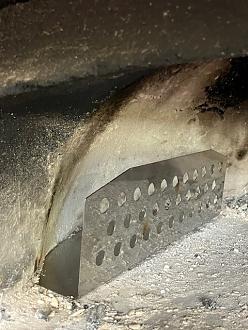

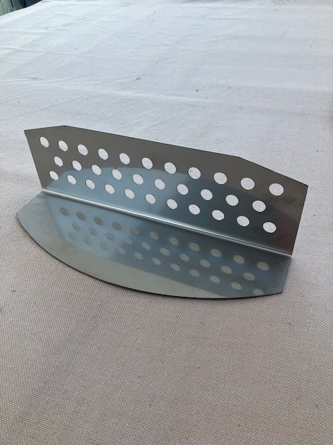

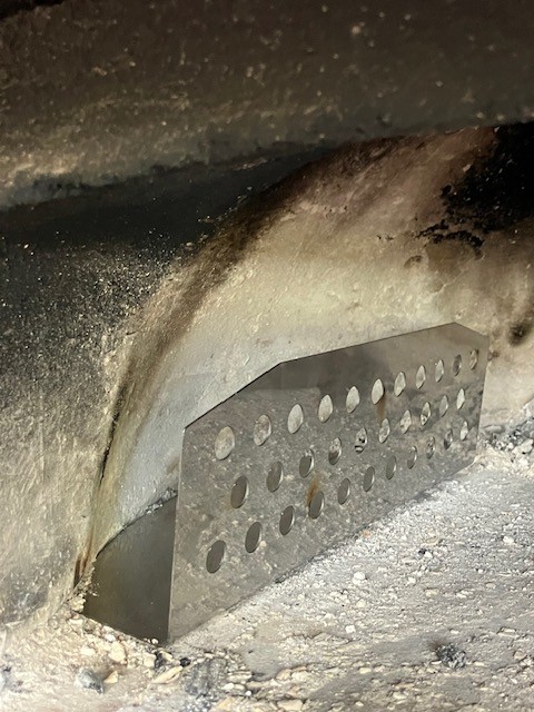

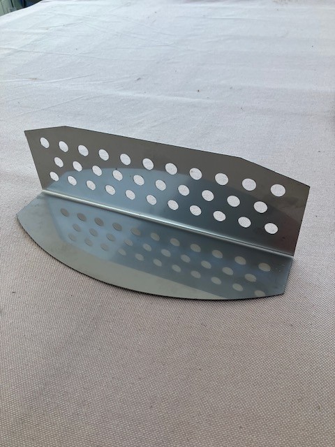

    This is my solution. 95 x 95 x 295 x 0.90 mm Click image for larger version

      #182
      Yep, that's the kind of design I have in mind.
      Gonna take a bit of time to drill ~30 holes.
        #183
        My first one had no holes as it was a prototype, but as I was getting them laser cut I decided to add the holes to allow some heat through and some air in. It’s the same principle as a kiln bag wall to protect wares from direct flame impingement.

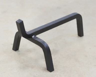

          I also want to try my hand at making an andiron like this.
          Can I Just bend a few pieces of rebar and weld them together? Would that hold up for a couple of years?

            It should hold up OK. I made a fireplace grate out of rebar that has survived several seasons. I was going to build a log holder like you are showing, but the Pompeii designed ovens draw so well (at least mine does) that I can't justify the space it would take up when I was not firing the oven.

              It’s more a case of just wanting to try and see if it makes a big difference. I’m not having any draw issues either, (no smoke ever escapes through the oven mouth, except for 5 minutes when igniting the fire) but I think it may help prevent small logs rolling off the fire and into my pizza!
              I might make a smaller version, as my internal diameter is only 28” – 70 cm.
              Rebar should do, okay – Thanks!

                The heat deflector works like a charm no more fire rolling onto pizzas, and less quick burning of the crust as well !

                  #188
                  I also use one of these, it is particularly useful for small ovens and maximises oven floor space and reduces burning the pizza edge that’s too close to the fire. For years I used a prototype made from 0.5mm stainless, but it did warp badly from the heat, so I had a bunch laser cut using 0.9mm stainless with holes in the front face to allow some heat through.

                    #189
                    Dear David, i used the pictures of your heat deflector at the top of this page as inspiration to make mine.
                    The SS is at least 1mm thick.

                      I have a couple of finger sized sticks preheating on either side of the entry so when thrown in behind the flame deflector they burst into flame almost immediately. This makes it easy to keep the fire going continuously.

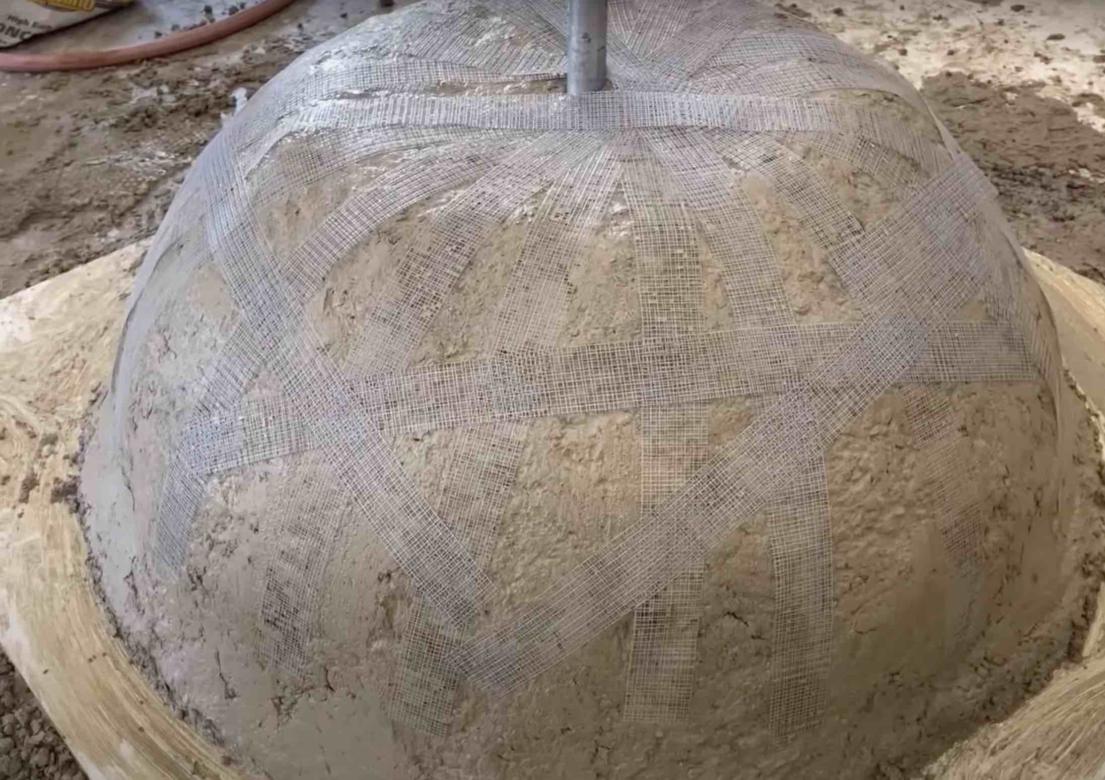

                          or would it be smarter to use a thin refractory cement base and then homebrew on top?
                          or could you even soak a thin theramic fibrewool planket? just for strength of course.
                          What do you think?

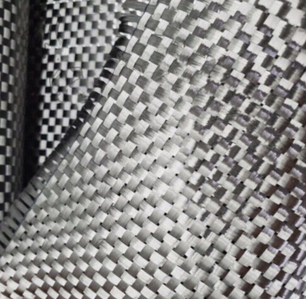

                              Does anyone have experience with this fibreglas to make things stronger? I was thinking of doing this:
                              Click image for larger version  Name:	fibre glas strips.jpg Views:	0 Size:	431.0 KB ID:	456328
                              with this material. either Glass fibres or Carbon fibres.
                              Click image for larger version  Name:	carbon.jpg Views:	0 Size:	233.2 KB ID:	456329
                                #195

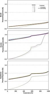

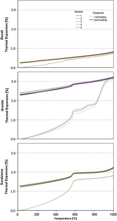

                                Because I manufacture I use a proprietary castable refractory, but I believe the extra durability it might give is not really worth it as the material is really expensive and contains ingredients that are designed for much higher temperatures, in excess of the temperature range to which we fire. The homebrew is almost as good as the far more expensive products. All reports on the homebrew longevity say it holds up very well. So cheap and easy to rebuild anyway. The vulnerable temperature range when thermal expansion of most materials peaks, is from 500C-650c should be avoided to prevent damage. Quartz (silica) does undergo significant and sudden thermal expansion in the 571-576C range and as all sand is primarily silica this is either a reason not to use sand as an aggregate or alternatively avoid the higher temperatures. So never fire an oven as hot as you can just to see how high you can get it. Only go as hot as you need.But this advice also applies to all ovens as a variety of different materials are used and the different rates of expansion can be incompatible. See attached graphs as an example of this. Mineral composition.docx
                                Interesting about your tyre solution to mount the oven on. I have been using that system for years when freighting oven kit parts. I place a motorbike tyre on a pallet, then assemble oven components on top. I’ve never had any breakages in transit.
                                On using fibreglass, you must get the AR (alkaline resistant) ones. They are coated in zirconium which is expensive, but the coating prevents chemical attack from the cement. They are widely used by the concrete countertop manufacturers so search there to find them. Glass doesn’t melt until sround 900C so fibreglass fibres are suitable for our temperature range as long as they are the AR type.
                                The other type of fibres that are probably more important to add are the very fine polypropylene fibres that melt at 160C leaving behind a network of fine pipes through which moisture can escape. This provides a measure of protection from steam spalling whe the oven is completed and firings begin

                                Click image for larger version  Name:	1-s2.0-S0892687515301278-gr3.jpg Views:	0 Size:	44.2 KB ID:	456336
