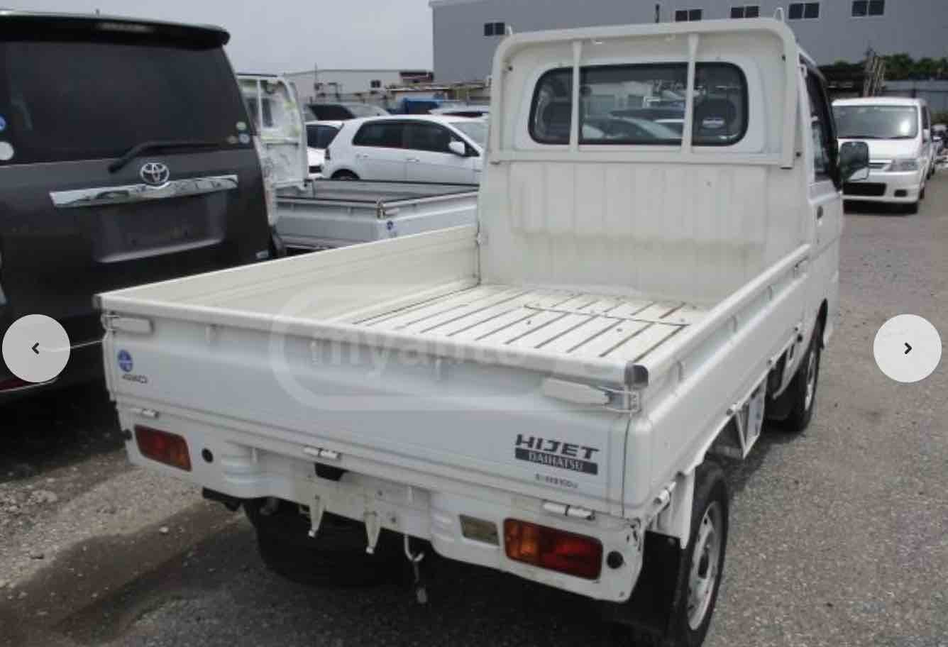

    For my new project I will def. make a new thread when I get started and share the progress. Now I'm looking tu buy one of these cute things :-)

      3.That little HiJet truck will not hold or pull the weight of e 28” oven. My mobile oven is only 21” internal, weighs 250kg and my 2600cc Mazda truck pulls it comfortably but a 3 cylinder700cc certainly wouldn’t.

        3. I think you might be wrong. These things are quite tough. Official payload is 350kg - so that will do. I will not be able to race - but it only needs to move - how fast, not very relevant in my case.
        But its a good thought - maybe its smarter to tow - and have a trailer - then I do not need to compromise in weight, especially I want a thick 6cm oven floor.

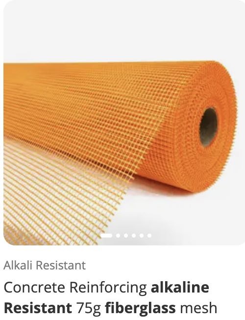

        regarding the AR resistant fibre mesh/strips. I was just thinking: is that not what builders use on the walls - to reinforce concrete plasters - for them not to crack. that's very cheap... :-)

          The rated payload is overstated and includes the tray body. My Mazda one tonne utility truck is severely down on its springs with 1/2 a m3 of aggregate or sand which weighs around 750kg. 1/4m3 which weighs around 380kg is a comfortable load.
          That roll of AR fibreglass mesh could be the answer, but being flat will not conform to a compound curve. You would need to do lots of cutting and ensure it’s embedded . The beauty of random fibres is that you just mix them into the wet mix, then the whole job can be done in one go, rather than two or three coats. It’s a huge time saver.
