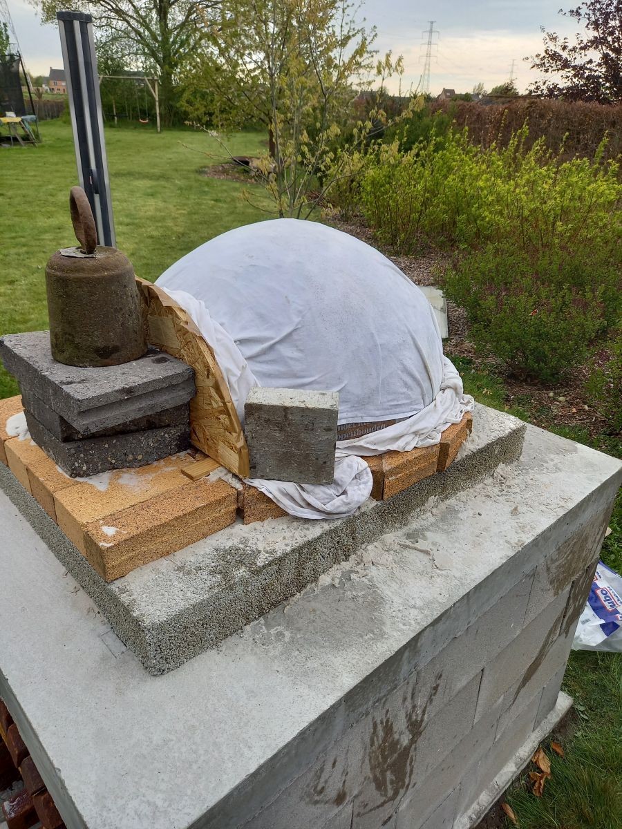

                  • #54
                    I presume you mean the voids on the inside of the dome, after removing the sand 48hrs after casting.
                    I'm worried about protecting the outside of the dome from the rain...
                    Anyway it's raining now and I've covered the dome with a plastic sheet...

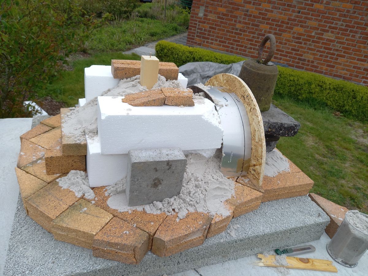

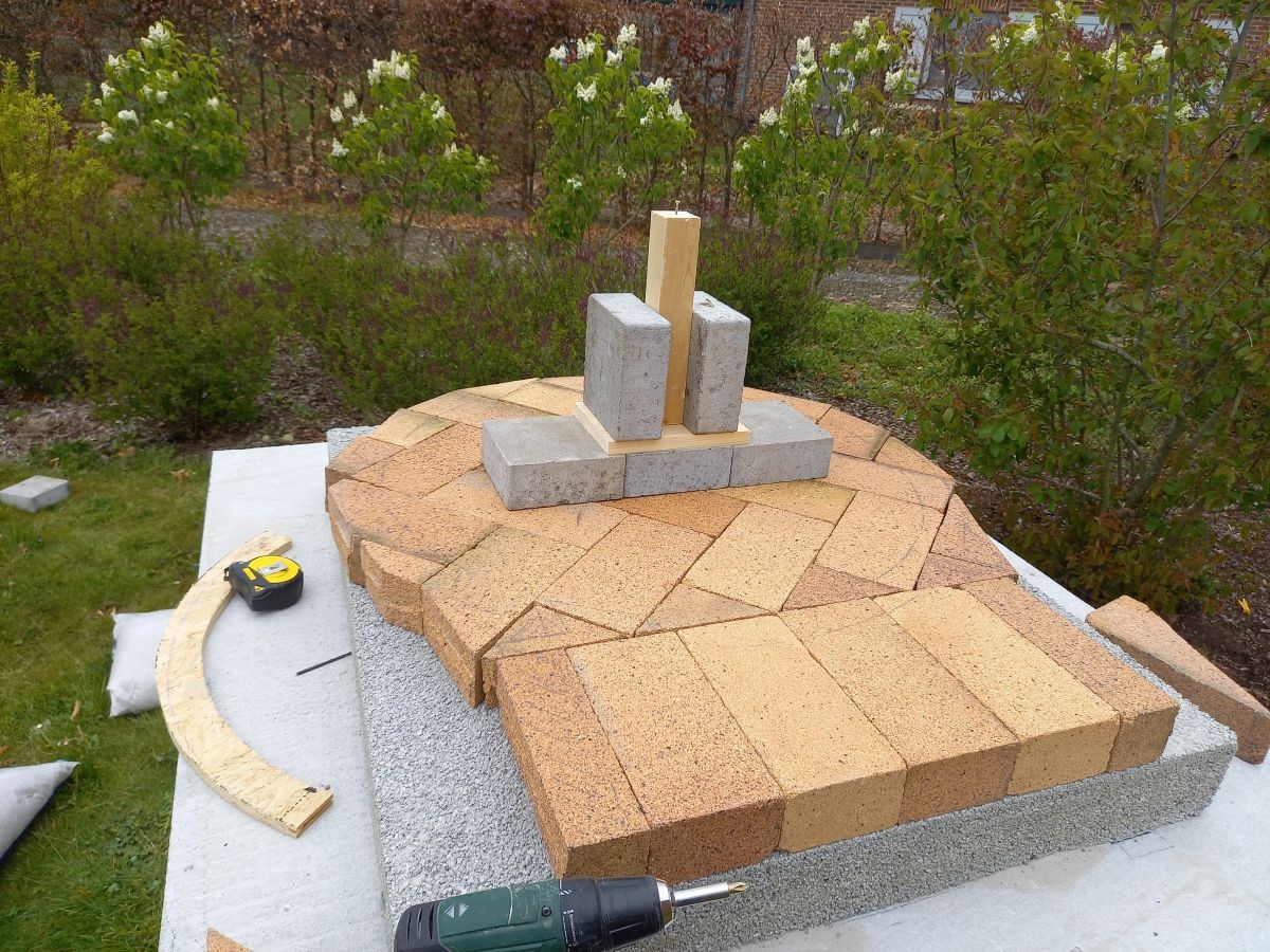

                    • #55

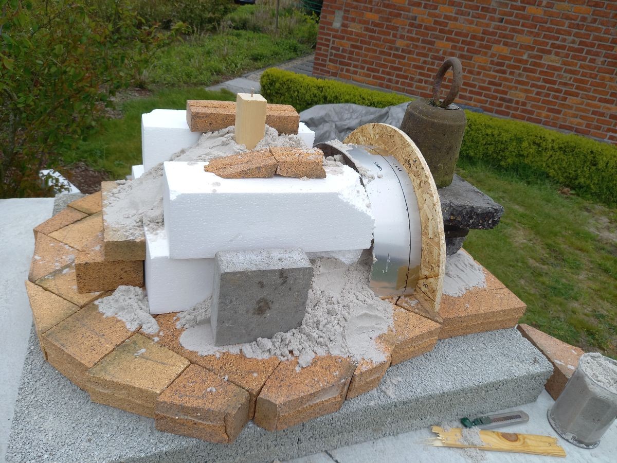

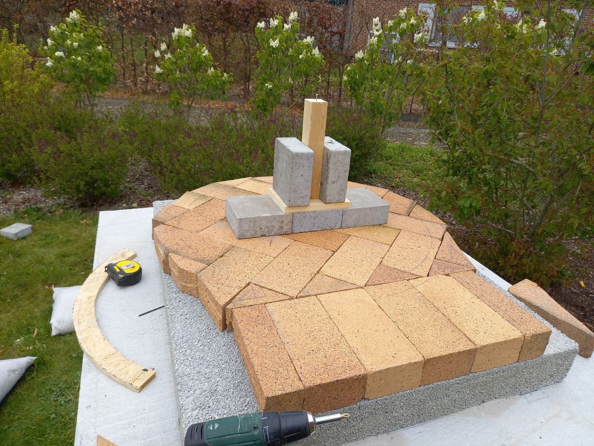

                      Building the sand castle was fun, much easier than I anticipated.
                      I first shortened the central stick as suggested by David to assist it's removal when I will empty the sand.
                      Put some bricks and styrofoam blocks to save on sand.
                      Still ended up using about three 25kg bags of ~ 1 - 2 mm fine white sand.
                      Using the quarter arch pivotting on the screw on top of the stick made it easypeasy to shape the dome.

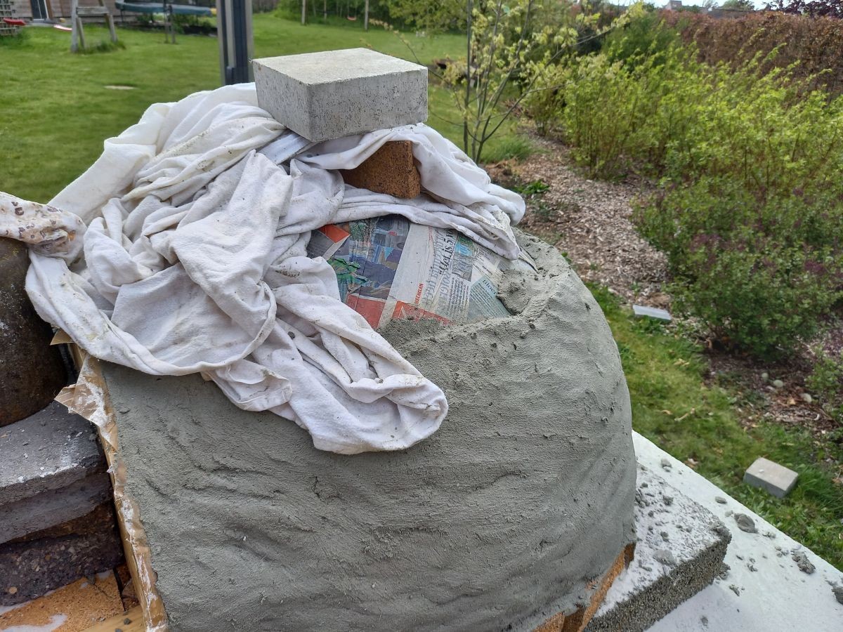

                      • #56

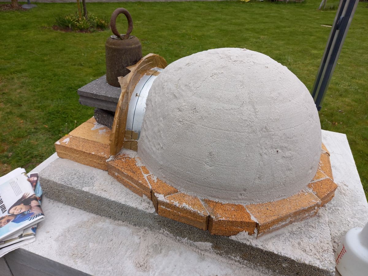

                        Next step was super frustrating: getting the strips of wet newspaper to stick on the dome was nearly impossible with winds up to 60 km/h.
                        Had to call the missus to assist and after a stressy 20 mins we managed to get the dome covered.
                        Used more layers of paper than I had planned (a little extra weight so it wouldn't blow away immediately) I also ended up with quite a lot of wrinkles... curious to see what the inside of the dome will look like on tuesday...
                        Then I immediately covered the dome with a wet blanket and a plastic sheet for the night.

                        • #57

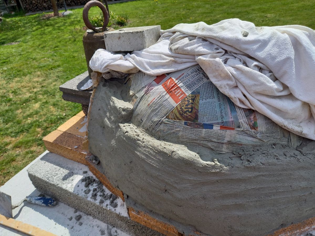

                          Next day was casting, I used the 3:1:1:1 homebrew mix with PP fibers, but no SS needles.
                          I first mixed all the dry components before adding water. I worked with batches of ~ 10kg dry and added about 2,5 L of water.
                          Starting at the base and working up to the top, went quite easy. I tried to push/press onto the newspaper in the hope to get a as clean as possible inside without too much wrinkes and voids...
                          There was quite a strong wind throughout, so fearing the newspaper would dry out and blow away I always kept the moist blanket on top as I worked my way upwards.

                          • #58
                            Looking at some pictures of the casting stage from other forum members I get the feeling my homebrew looks a lot dryer when I put mine on...
                            I was cautious not to wet it too much, fearing it could sag under it's own weight.
                            • #59
                              You will find out when you remove the sand. It looks ok from the pics though. Too dry and you'll get more voids, too wet and the castable will slump and perhaps get some shrinkage cracks.

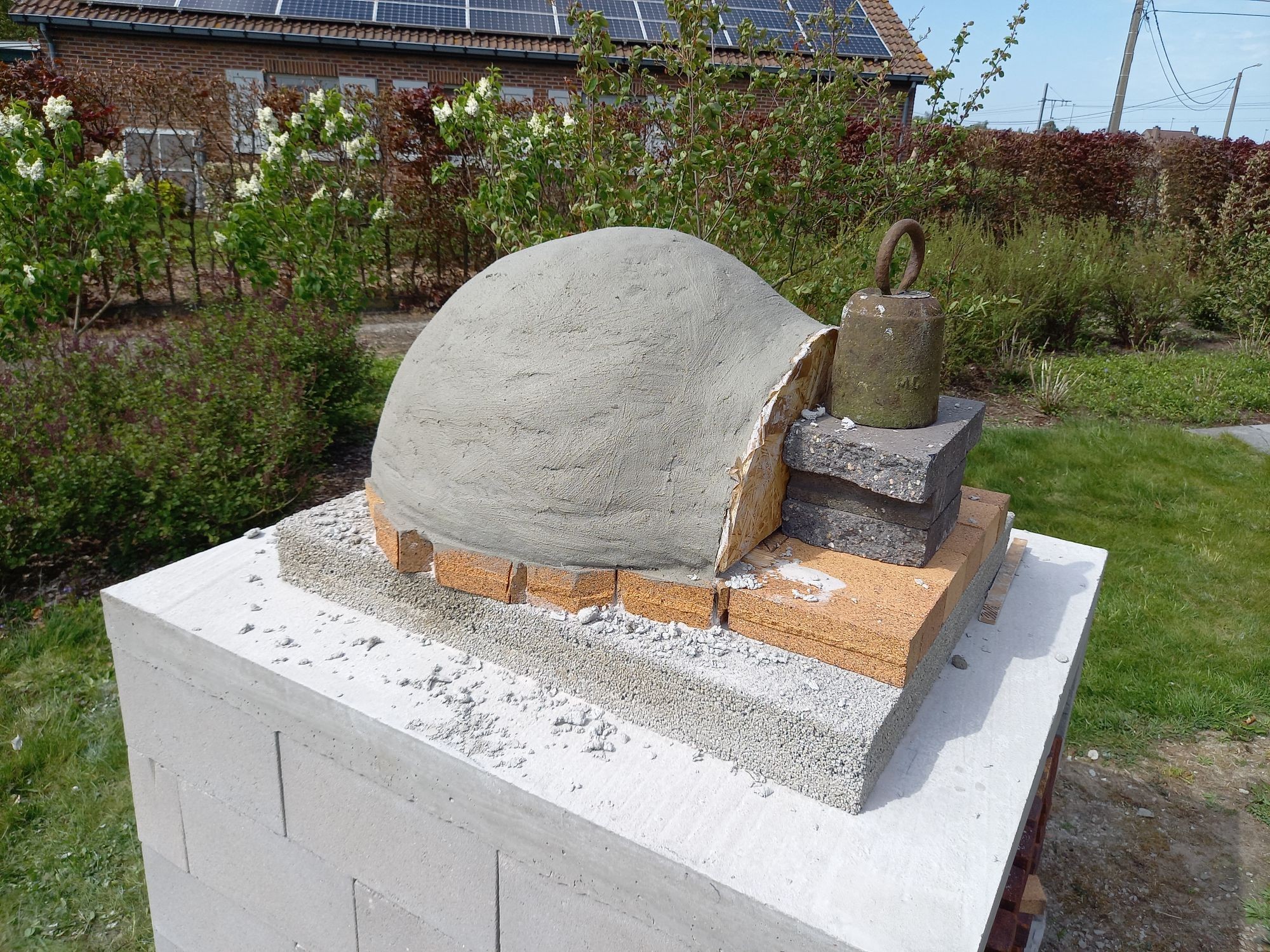

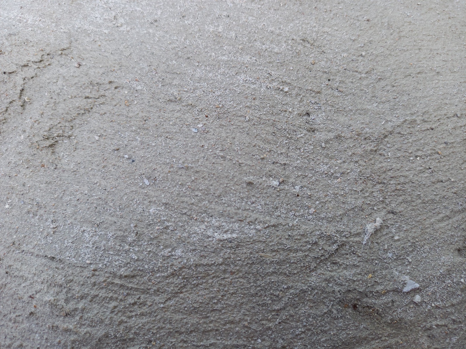

                                I removed the plastic under which the oven was covered last night and today.
                                I expected to see the underside of the plastic covered in condensation, but this is not the case...
                                Should I be worried about that?
                                Should I give it a good hose?
                                I didn't do that yesterday, should I have done so?
                                here's a close up of the surface. I don't see any cracks or crumbly bits... Click image for larger version  Name:	20210510_192612.jpg Views:	0 Size:	805.5 KB ID:	437878
