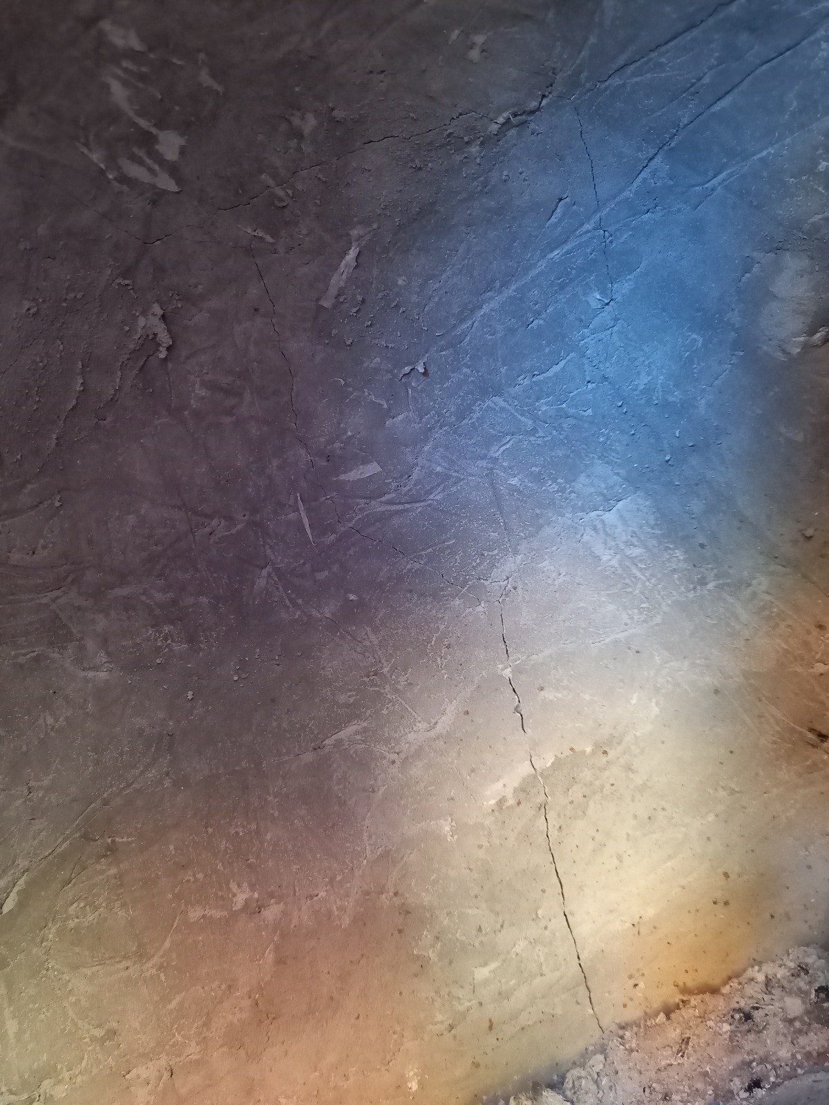

          Unfortunately I also cracked the oven. Now I know every oven is 'supposed' to have cracks so I'm not freaking out, just wondering if this a normal crack or not. It spans about half the dome, starting from the base at the back and running to the apex.
          I might have overdone it on it's third firing, especially as I wsas just wanting to cook a chicken, but I read that you first need to clear the dome, so I did just that, and than let it cool down to put the chicken in.
          I guess for a chicken I could just as well have stopped firing with half the dome cleared? That could have prevented the oven from cracking... Can someone confirm if it's a good practice to only clear part of the dome if you don't need pizza temps?

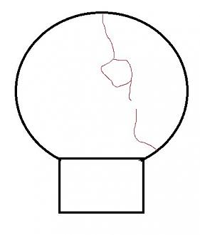

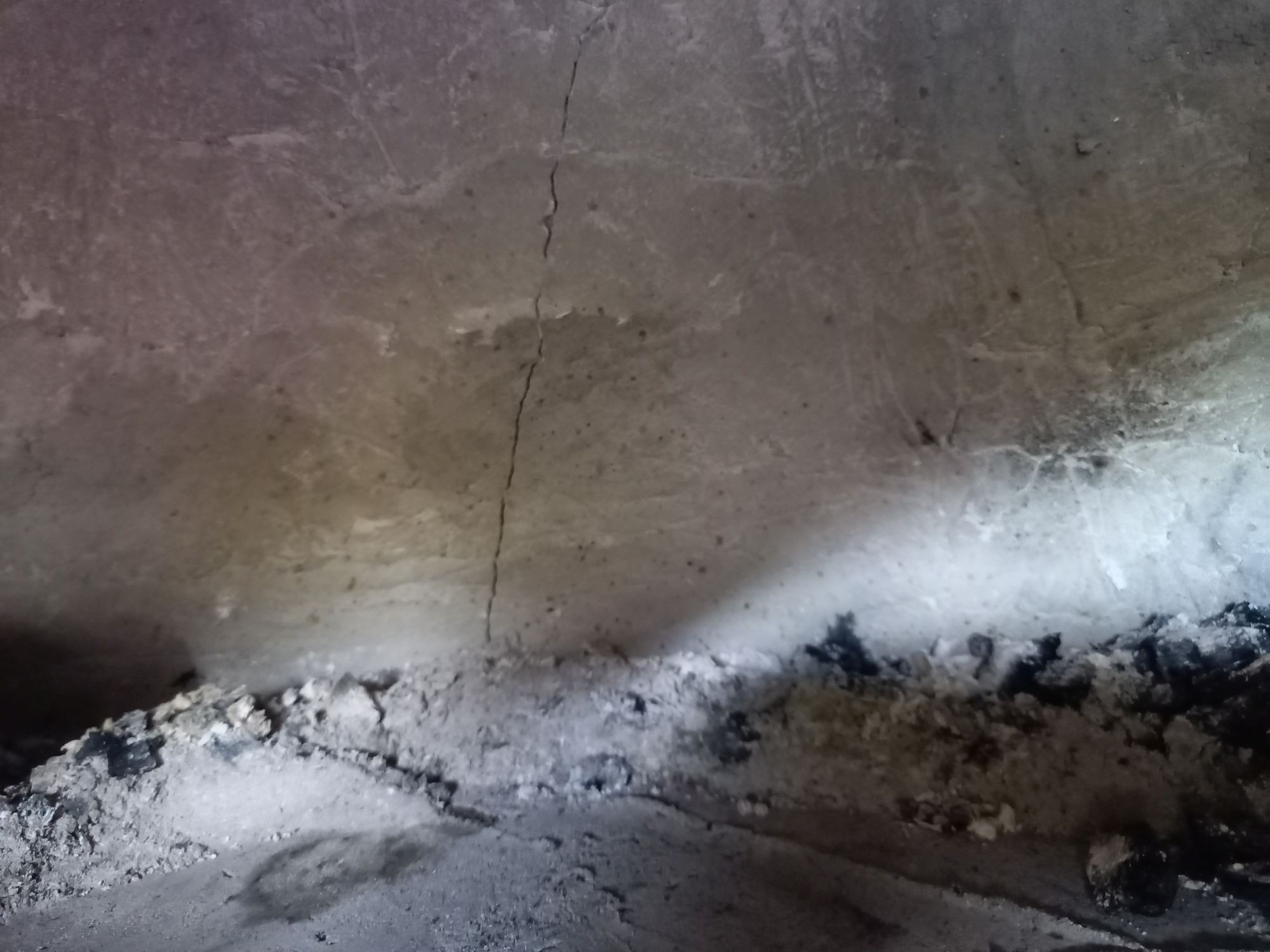

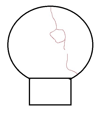

                Well, I'm in need of a bit of reassurance (hopefully!) about the crack in my oven...
                Upon closer inspection it seems the crack spans nearly the whole dome.
                it starts at the bottom, right smack in the middle of the back wall staring me in the face, and is about 2mm wide, i guess.
                it gets thinner the higher it gets and about 2/3 up it splits in two with both cracks going around in a square patch the size a of hand and then rejoin again. (I think the hand sized patch could be the same size as the lumps of homebrew I used to make the dome, so maybe it could have been the last lump of a batch which was maybe just a bit dryer than the rest?)
                after that it seems there a thin hairline crack running the apex and joining a small crack which goes almost to the bottom again ending right of the entrance...
                I tried to make a top view sketch.
ID:	439137 Click image for larger version

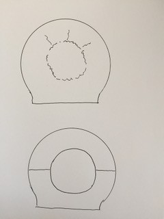

                  #98
                  Hi Chris,
                  Any large refractory section is vulnerable to cracking, primarily because of the difference in thermal expansion. A one piece dome in particular, using wood as a fuel is particularly susceptible. For this reason most cast oven manufacturers offer their ovens in multi piece sections. This makes things more manageable and less weighty sections. For mobile ovens some manufacturers offer a single cast dome as they're less likely to have problems with road vibrations. When I first began to build ovens I used a single piece cast dome, but now produce a 3 piece dome. Unfortunately this requires much more work to create a mould, particularly if the sections are to be step joined. This is hardly worth the effort for a single cast oven, the simplicity of the single cast, in situ, over a sand mould has way more advantages. The single cast does however have a tendency to produce a crack, just like yours has, which runs vertically right opposite the oven mouth. This rarely gets any worse though, and the oven will not collapse.
                  The attached drawing shows where fine hairline cracks (you couldn't fit a playing card into them)have developed in my oven (14 years old and still working like a charm). Subsequently I redesigned my moulds and now cast them in 3 pieces with a step joint between the front and rear sections. The top section is quite a large diameter which allows it to get hotter and expand without stressing the other sections.
                  See top pic: one piece cast with hairline cracks
                  bottom pic: 3 section castings
                  I th ink you are over worrying, get into the joy of cooking
                  Dave

                    Allright, thanks Dave, appreciate your feedback!
                    Apart from the bottom section I could indeed not fit a playing card into the crack.

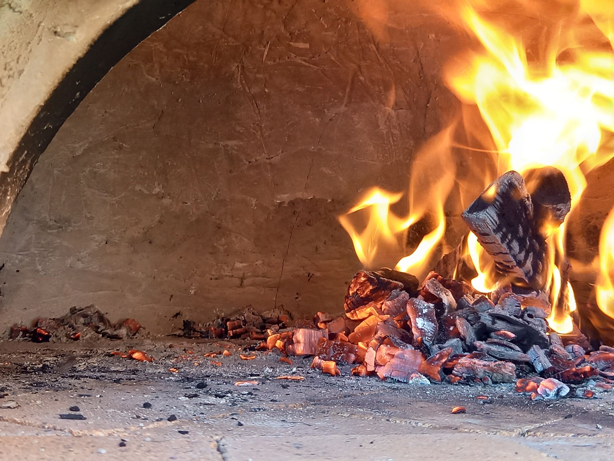

                      First pizza’s yesterday!
                      I was a little curious to see whether the oven crack would grow, but it looks like it didn’t.
                      I prepared 6 dough balls the evening before and let them rest in the fridge overnight.
                      After 90 mins the oven was at pizza temp, the first baked in 3 minutes, after the third pizza I noticed it took quite a lot longer and the dough didn’t rise as much with the crust less airy.
                      I was doing other stuff at the same time between the first and finishing the third was probably 25 minutes, in which time the flames had died out.
                      So I decided to move the coals to the other side and build back to flames so I could bake pizza’s at the other side where the floor would be a bit hotter.
                      The next three pizza’s were okay, but the first was still the best and since then I was always struggling to keep the oven floor at 350°C or above. I guess 90 minutes is just about okay, but it’s better to saturate the oven just a bit longer so the floor stays hot longer.
                      And/or I should also build my fire bigger with more coals.
                      I almost forgot to take a picture.
                      After that I baked 2 breads @ +/- 230°C (they browned really nice but taste only “meh”, still learning all the dough stuff.
                      @ around 180°C put in some BBQ ribs for an hour, then wrapped them in alu foil, and 2 hours later took them out. Juicy, soft and loose from the bone. Very nice.
                      One little question: how easy/difficult is it to damage the dome with tools like the pizza peel, brush,… when I tap the inside of the dome with my knuckle it has a very hollow sound (Duh!), sound fragile, but I know the dome is a very sturdy design. Still I try not to touch the dome when brushing the floor, moving the fire and wood around, or raking coals out.
                      Also: I am stoked (Ha!) about the way the vent/chimney works: 99% of the smoke when starting the fire goes through the chimney, I have no ugly black soot deposit whatsoever on the front of the oven. something I have seen in some other ovens and really wanted to avoid. So big thumbs up for David S and others from who I copieda large funneled vent.
                      (I use the top down fire method which also helps ignite the fire more efficiently)

                        #101
                        Thanks for your comprehensive report Kris. An hour and a half is usually about how long it takes for the oven to go completely white, but an extra 20 mins or so of "the fire from hell" is usually required to get it really charged. Usually the floor is too hot for the first pizza and it needs to be cooked closer to the entry where the floor will be a bit cooler. Subsequent pizzas can be pushed further in and the oven will hit its sweet spot, cooking 2 min pizzas for most of the night. However you must maintain a fire on the side to keep the temp up. Also a new oven still purges itself from moisture for several firings and you will find its performance improves for around 5 or 6 decent firings. The under floor moisture is the hardest and slowest to remove.
