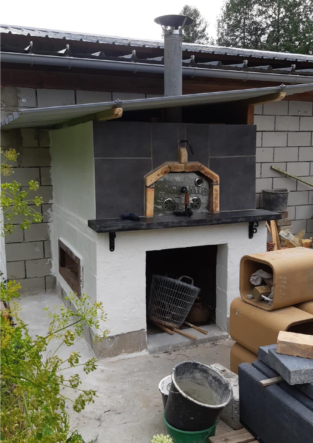

            hi Kris,
            Mechelen is not really near, but i have friends there i'l probably visit next month.... if you want i can drop it of, just pm me,
            Thanks for the tips, i have noticed the same thing, i have done pizza for 8ppl 2 times now, i did flamkuchen for 6... also baked sourdough bread and siu yuk (kantonese crispy pork belly) in the oven, works verry wel... ik have a crack in the entrance, but none in the dome itself...so far :-)
            this is my oven;

            its an oval shaped (85cm/120cm innside) flatend dome... firebrick but with a coating of vermiculite concrete on top, then, the entire enclosure was filled with a mix of vermiculite and argex (expanded clay)... the supports for the stone and the doorhandle i forged myself, everything was made from repurposed materials (the firebricks cam out an old bakery oven)
            i had her up to 550°c and after 24h it still had 180°.... she's lager than a usual pizza oven, because i like to bake bread, and would like to do pig roasts in her.

              Your oven looks great, and 180°C after 24 hrs is really good!
              I gladly accept your offer, will pm you!

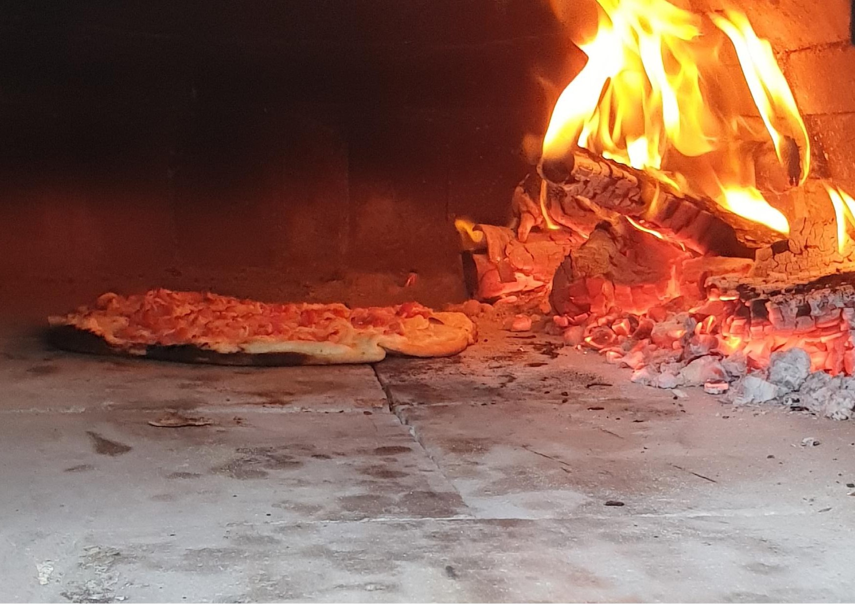

                          #117

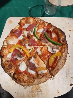

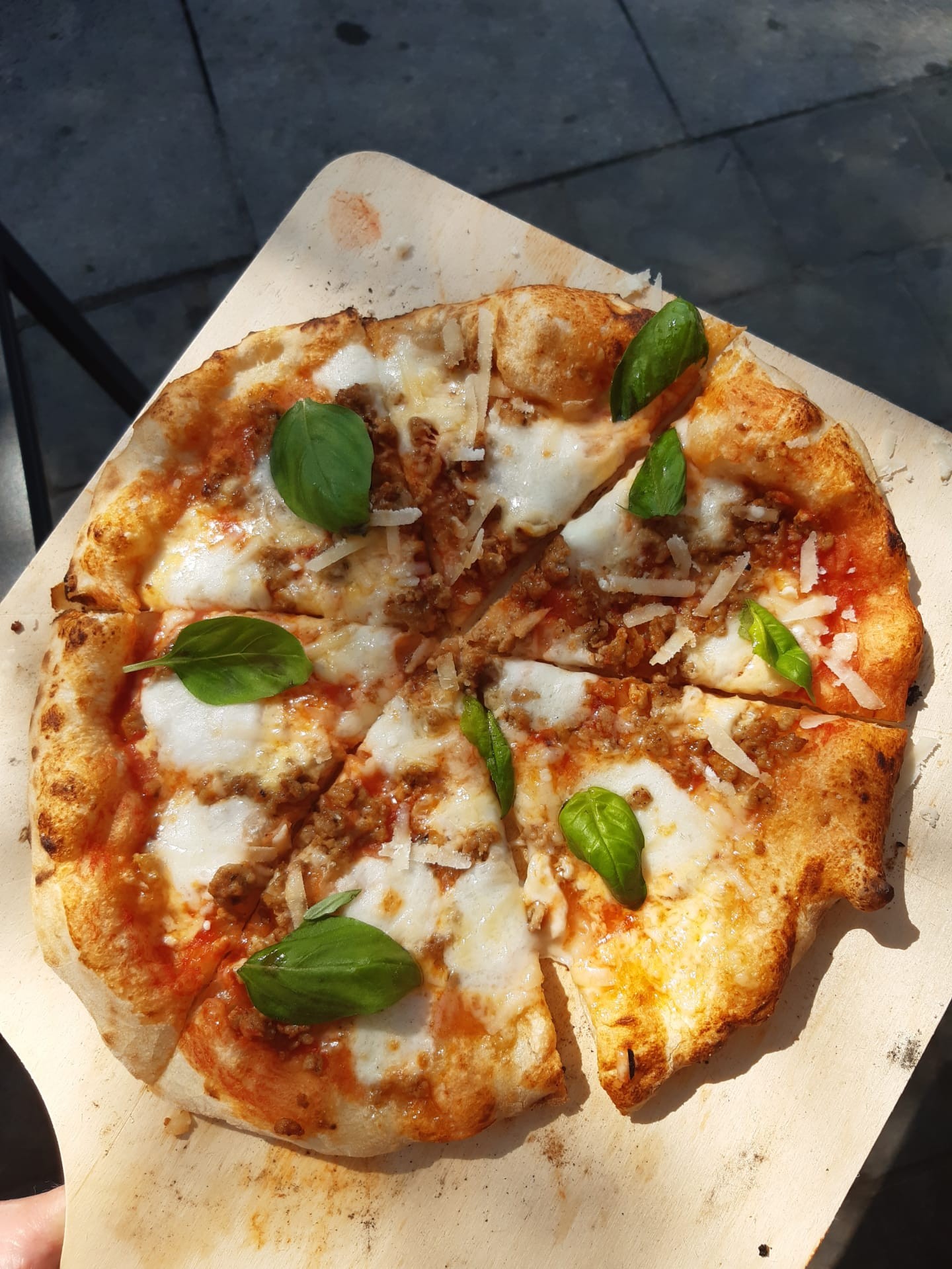

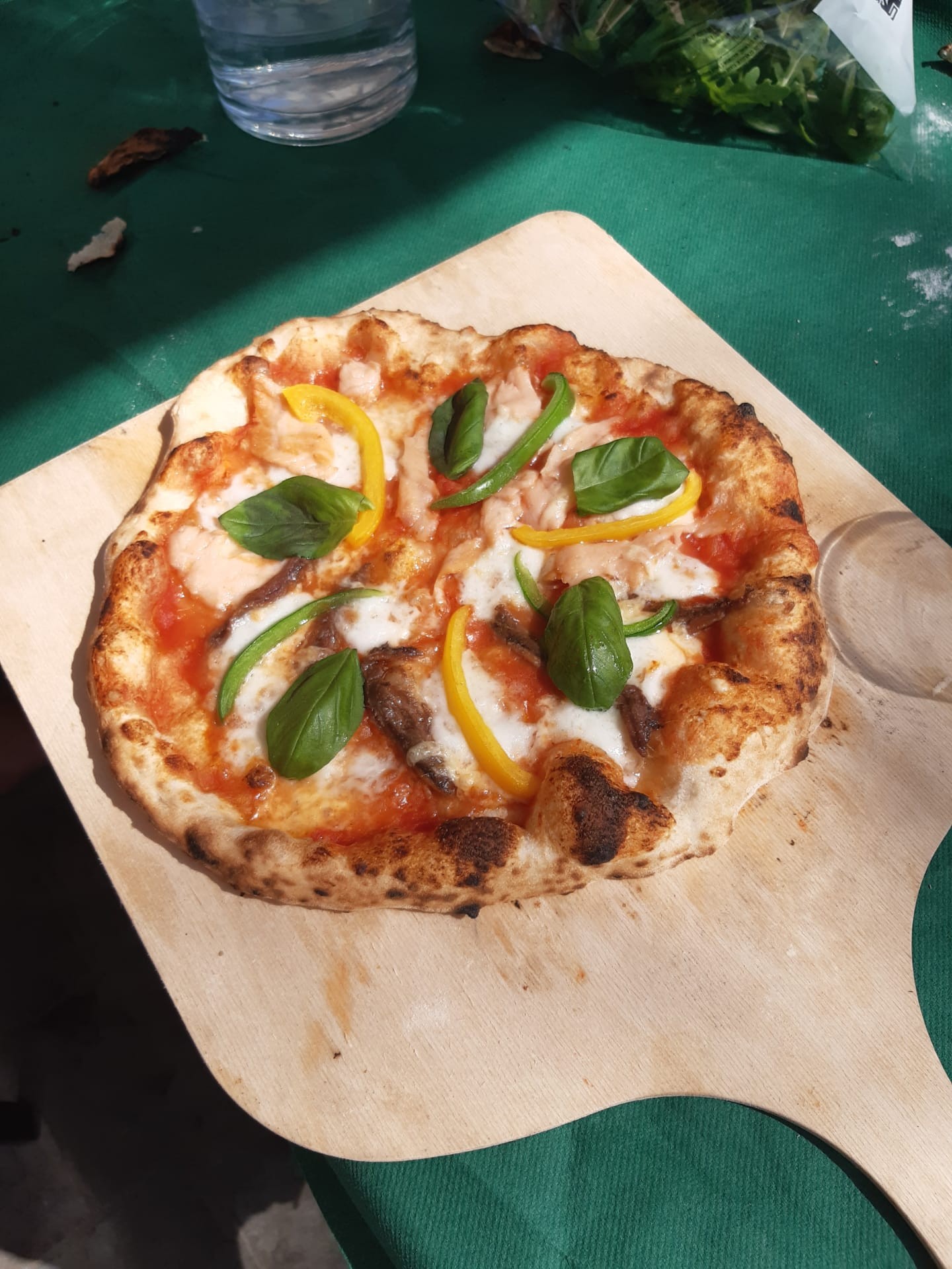

                          Hello again! So we had another pizza party, this time we cooked 24.
                          Overall all went well, still learning to get better at Neapolitan style pizza making . (couldn’t get semolina flour this time)
                          I’m getting better at judging the ideal floor temp (and position for the pizza), I find anywhere between +/- 375 -450 °C (+/- 700 – 840 °F). higher and the dough/flour immediately burns black which tastes horribly bitter.
                          Fire management also getting a little better, learning the importance of having lots of flames going to cook the toppings in the same time it takes the floor to cook the dough. Having and maintaining this good floor / flame equilibrium is still somewhat difficult for me to keep going for a long time, in the end my floor was a little too hot and I had a little too few flames so the tomato sauce and toppings were not quite 100% cooked, but the dough was ready, so I take the pizzas out.
                          I had prepared 33 dough balls with a 24hr proof, there were 9 left, so without thinking too much I put the balls in plastic bags and straight to the freezer. The morning after we decided to invite some other friends for pizza again at noon because we still had some toppings and stuff left, so I took them out of the fridge in the morning to quickly thaw at room temp. not ideal because it’s better to let them slowly defrost overnight in the fridge I guess). Once thawed I did a little experiment and re balled 5 and let the other 4 flat and irregular. Should not have re balled them because it took a good 2 hours for them to flatten enough in order to stretch a good bottom. The ones id didn’t ball again were actually good enough to shape the moment they were at room temp.
                          These are some pics of the pizzas with the reballed dough from day 2 with left over toppings, they were still somewhat difficult to stretch, so a little smaller and floor / flame balance was not quite right, but they were delicious!

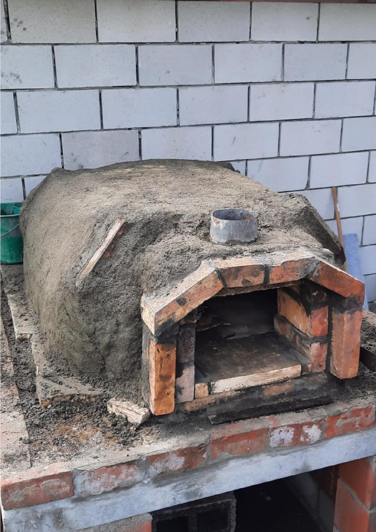

                            #118

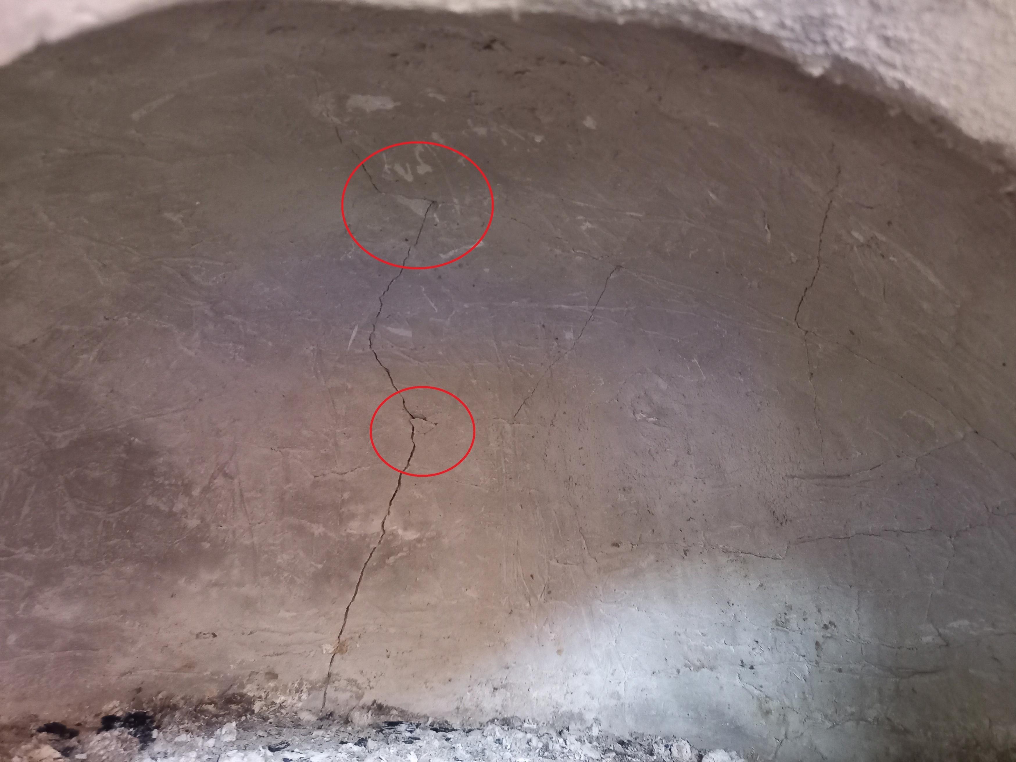

                            Now here’s a less pleasant thing to report: I noticed a small chunk of the dome is coming loose, and a bit higher up it appears a small piece has already fallen out!
                            Should I panic? I do remember after my casting that other users posts of their casting process looked more wet, my homebrew was a bit on the dry side.
                            Patching up is futile I think, I probably wont even be able to reach as well.
                            Any input greatly appreciated!

                              #119
                              mmn, thats bad news indeed....., can you tel if your cracks form during heating or during cooling down afterwards?
                              but even so as long as its only a small chip here or there (and they dont fal in the food) i don't think the structural integrity of your dome is in any danger.... is there smoke leaking?

                                #120
                                Yesterday it was indeed pizza-party-weather (we had 15 ppl over). Your pictures look great! I hope the dome holds up.
                                my 2c on pizza baking:
                                Excess of flour will indeed burn black. Wipe and-or blow it to the side every few pizzas.
                                Btw: a wooden peel slides with less flour.
                                keep very thin timber at hand. The fire responds so much quicker to it. Even more if you preheat it in the entrance.
