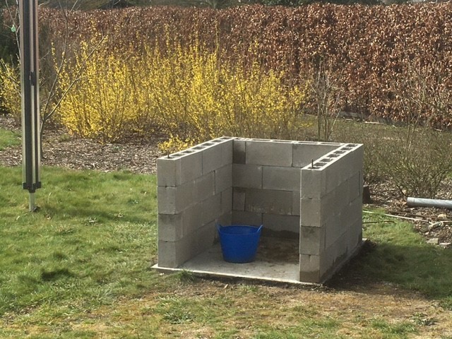

        Dry stacked the hollow blocks, later filled every other hole with concrete.

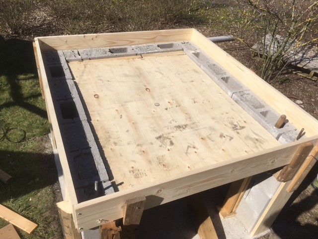

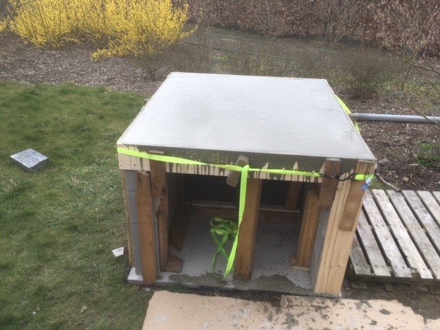

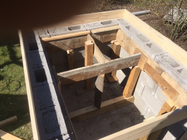

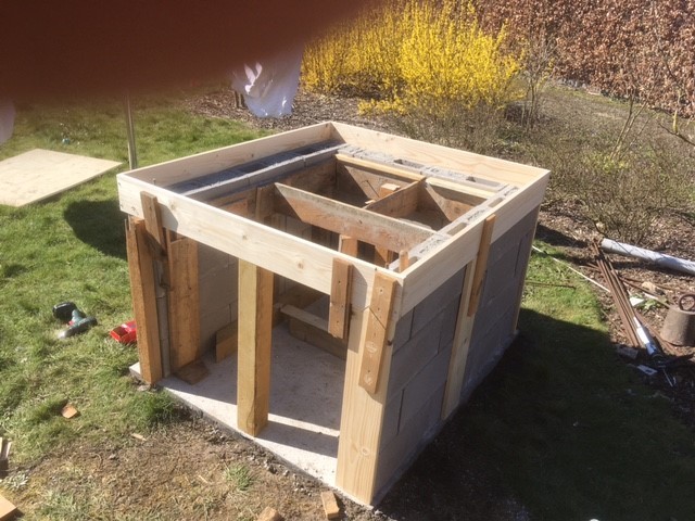

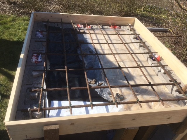

            Poured the table top...

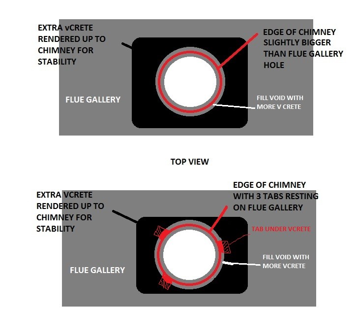

                I’m thinking a few steps ahead now, but for some reason I can’t wrap my head around how to place the chimney pipe on the flue gallery.
                I want to go the David S route with simply resting my (single walled) chimney on top of the flue pipe and rendering up to it (with a cardboard spacer in between) with Vcrete.
                But I don’t really understand the advantage of cutting and bending 3 tabs at the bottom of the chimney to put it on the flue gallery over the hole. Can’t you just make the hole of the gallery a little bit smaller (1cm?) so the chimney can be put on top without it falling through and without the need for the tabs? And rendering up to up with vcrete for 8 inches high or something?
                I would think the gallery hole always has to be a bit smaller than the chimney diameter so the pipe can’t fall through? So are the tabs just there to ‘anchor’ the pipe more in place because they will be covered with Vcrete, thus giving more stability?
                Maybe these drawings make it more clear what I mean:

                            The chimney is tricky.... I think the tabs in the end of the flue pipe give you a bit more stability (at least this worked for me. But also more touch point with the oven and risk of cracking the stucco.
                            The photo shows my nice cracked stucco (one layer) in the front of the oven chimney. The stucco does not touch the chimney in any place.
                            (I had to redo my stucco on the chimney anyway due to unremovable cardboard....)
                            My build 60 cm/24'' homebrew, the Netherlands

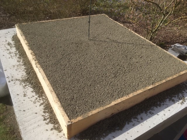

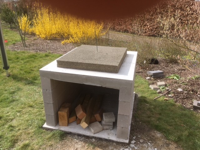

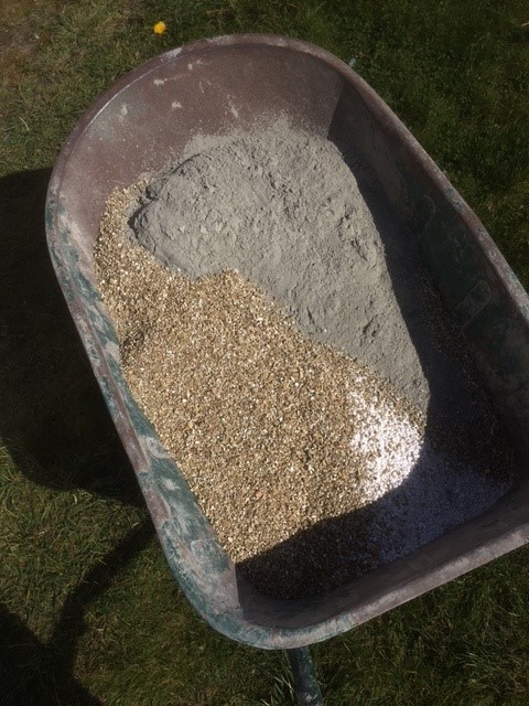

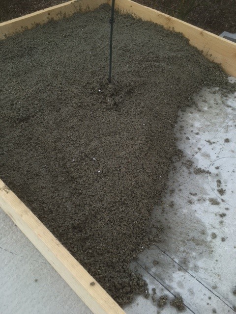

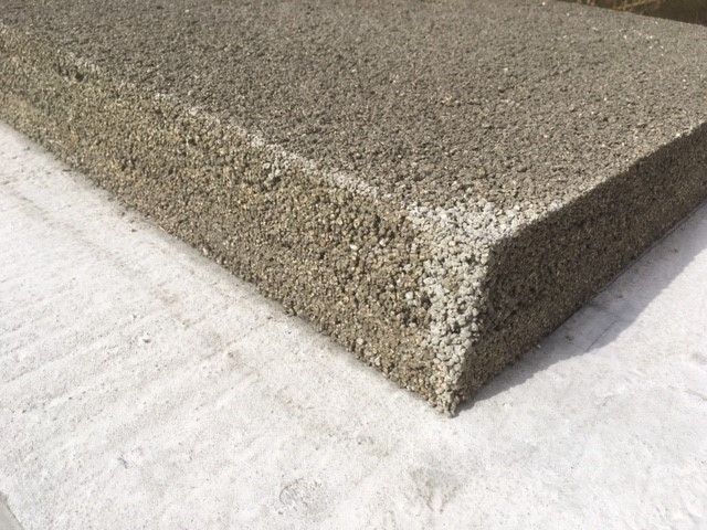

                              Poured the 10cm (2.5") thick 50/50 vermiculite/perlite insulating layer.
                              Used a 5/5/2/3 volume mix of verm/perl/cement/water. Dry mixed the solids first before adding water as advised on the forum.
                              Vermiculite is the brown stuff, and Perlite the white lumps in the picture of the wheelbarrow.
                              Have to let it dry for 3 weeks now before continuing.

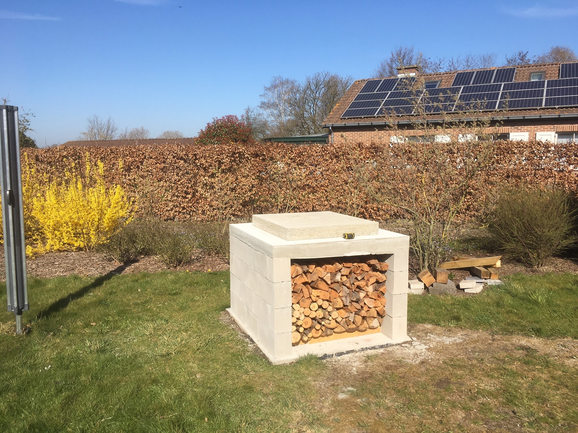

                                Forgot to add I also drilled three 10mm weepholes through the conrete, I could immediately see it's advantage as there was a little water seeping through after I put the Vcrete on.

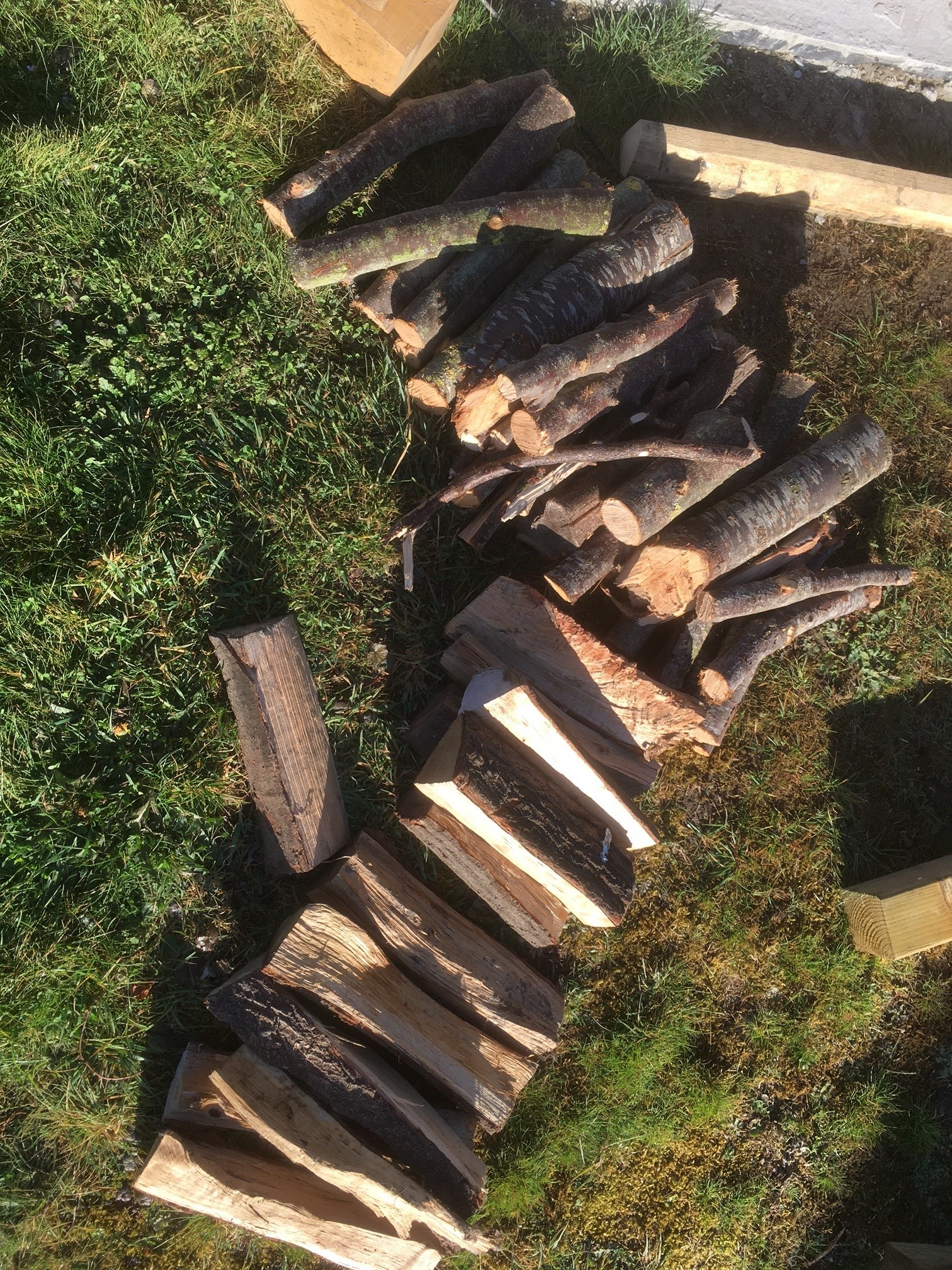

                                Getting way ahead of myself again and stocked a bit of future firewood under the oven.
                                I've got a sheer endless supply of willow and oak, but read that fruit woods are considered excellent for cooking with. I have a little bit of apple and plum (close up picture) and also stocked some cherrywood.
                                I intend to only use these if and when I get the hang of firing and cooking half decently.
