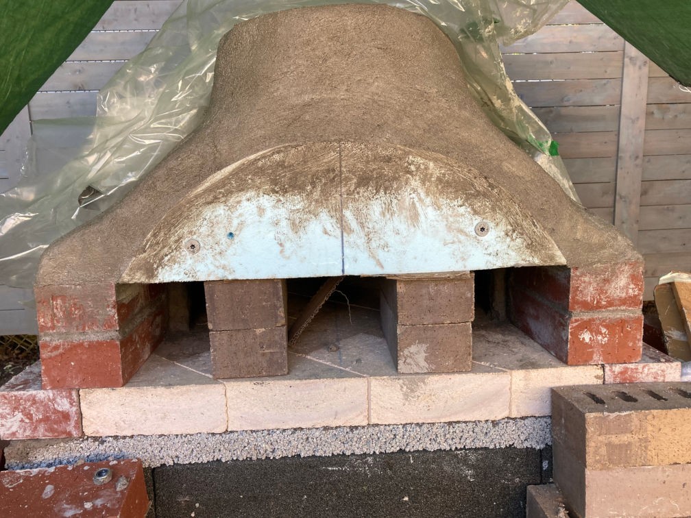

              This is my gallery:

              Some old rigid foam to make the form. I screwed up a bit early in my design process, I am pressing to hard to keep the gallery as short as possible, and now I won't have a full 6" opening for the flu... it will likely make more sense when I post some more photos later.
              My plan is to let the dome/gallery sit covered for a week. Then add the CF blanket and start the process of adding the perlite/vermiculite layer, which I will do in lifts over a few days. Then after 2 weeks or so to start the slow firing process.

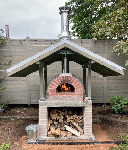

                  The outer layer has been placed, I also have a roof in place over the oven. I am looking into a concrete sealer or something to put over the outer layer. There are certainly some cracks in the interior of the oven, just hoping it still functions fine. I haven't fired it up to pizza temperatures yet, but will this week. Thanks for the help everyone! Now I have to learn how to use it!

                      That roof will keep the rain off the oven, so you are probably better off allowing the outer shell to breathe as sealing the outer surface also prevents moisture escaping. I really like your roof design, it allows plenty of breeze around the oven to keep both it and your wood dry, nice solution.
