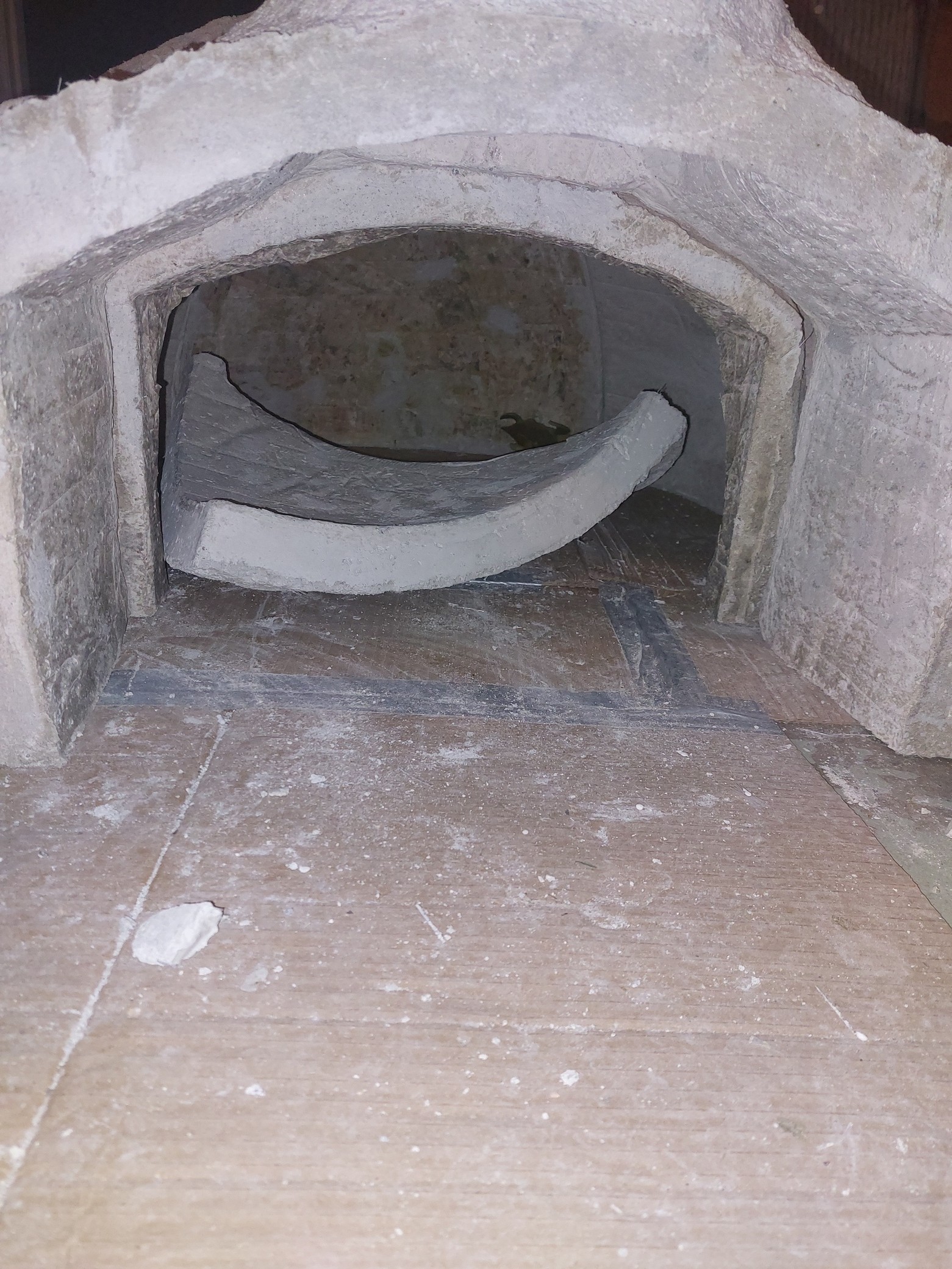

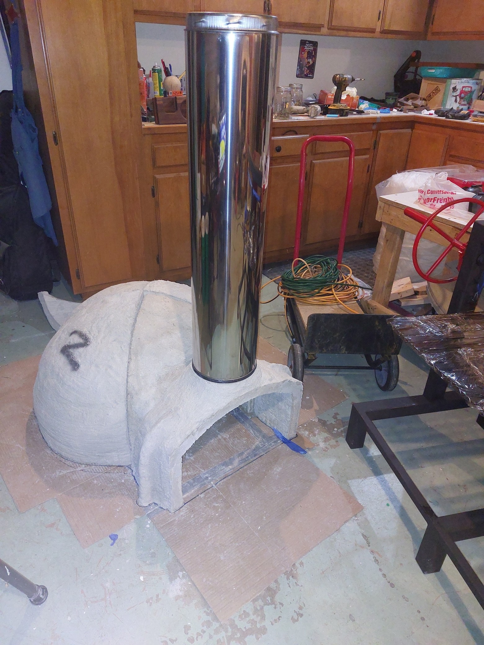

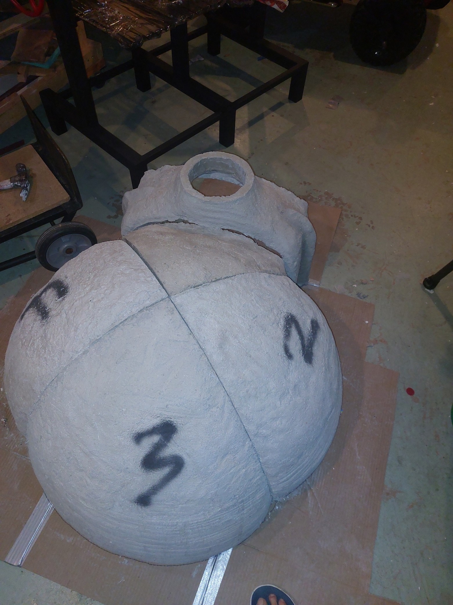

    Well looks like the cling wrap worked in keeping the 2 sections from bonding to each other. I was able to demould and seperate them pretty easy. Now its actually looking like it might work. Would it be better to fill the seams with perlcrete or a homebrew mortar?

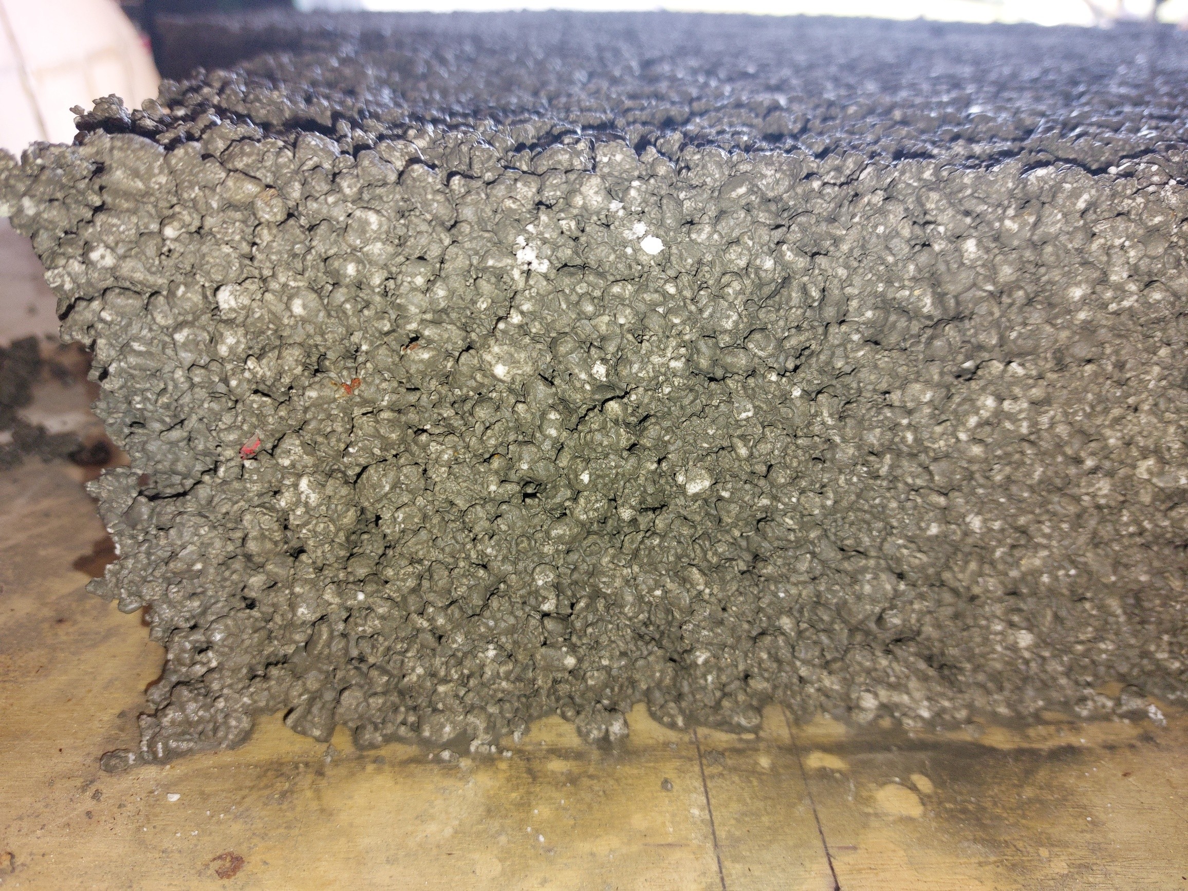

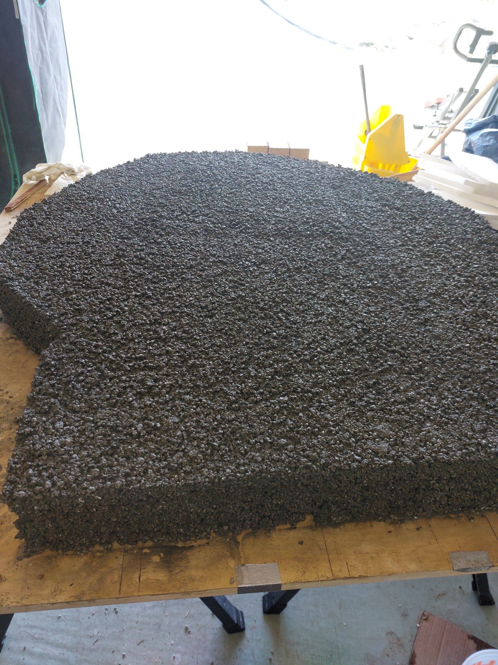

      I was finally able to cast the underfloor insulation with 5:1 perlite/portland cement. Hopefully i can set it on its final resting place without it breaking. I feel like it could of used more cement since it seems quite fragile, but the ratio has been used by so many other builds so it should be alright.
      • #18
        This is the right ratio for floor strength and insulation properties, any more portland reduce insulation value.
          I thought the same, at first you think it's never going to hold up. but once dried it's deceivingly strong, I had to partly remove/chisel away the front corners for my enclosure walls, and was surprised how sturdy it was!
