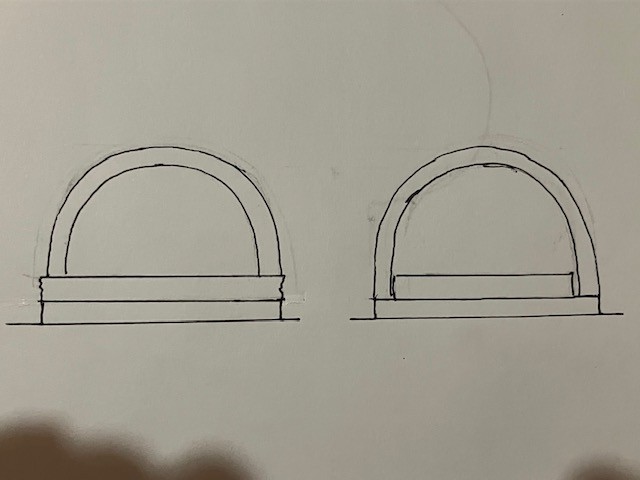

        Thanks David. That makes sense. I was hoping to confirm that it's best to cast the dome on top of the firebrick floor, not on the insulation. What is the logic there?

              #81
              This question pops up from time to time and the answer is that once the oven is built it really doesn't matter much because the interior form, wall and floor thickness are still the same.
              Although there are some differences. If building on top of the floor (left drawing), you can cut the perimeter pretty roughly because the edges will be covered in insulation anyway. This can save a lot of time, especially if you don't have access to a wet saw, which you may not as you intend to cast the dome.
              If casting around the floor (right drawing) you have the advantage of being able to remove a floor brick, should it need replacing, at the floor perimeter.
              Balancing the two, I'd go for time saved trimming the brick edges because any floor bricks that require replacing, probably never and then only by your grandchildren, will always be in the middle of the floor.
              Others may disagree. Click image for larger version  Name:	IMG_0935.jpg Views:	0 Size:	36.7 KB ID:	457932
