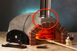

                  And a question. I've been scouring the forum for ideas on how to form/frame so I can cast the vent. I want to do something like FB's own ovens with the square, flat vent that hods the anchor plate. I remembering seeing that someone did a really nice job of that in the past and they posted good photos of their forms, but I can't a good example. Any tips or someone remembering those thread would be really appreciated. Thanks!

                    Searching in the Forum can be tough. Try a Google search. Something like: flue anchor plate site:community.fornobravo.com.
                    Play with search terms. You can also refine the search with the Tools function and use a custom time frame if you want the most recent posts.

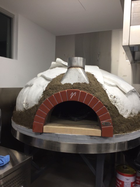

                            Here's another alternative which has the advantage of low thermal mass that won't act as a heat sink like a heavy brick or castable casting does. You will need to get it fabricated at a sheet metal shop who have stainless welding experience (unles you do) The stainless should be 0.9mm thick 304 (or specify 316 if you want to be crazy)
                            Regarding the use of something to cast around if going the castable route, the pipe itself works fine, but be careful to wrap some cardboard around it, then some sheet plastic for easy removal. If the castable is too tight around the pipe you risk cracking the casting from the expanding conductive pipe.
