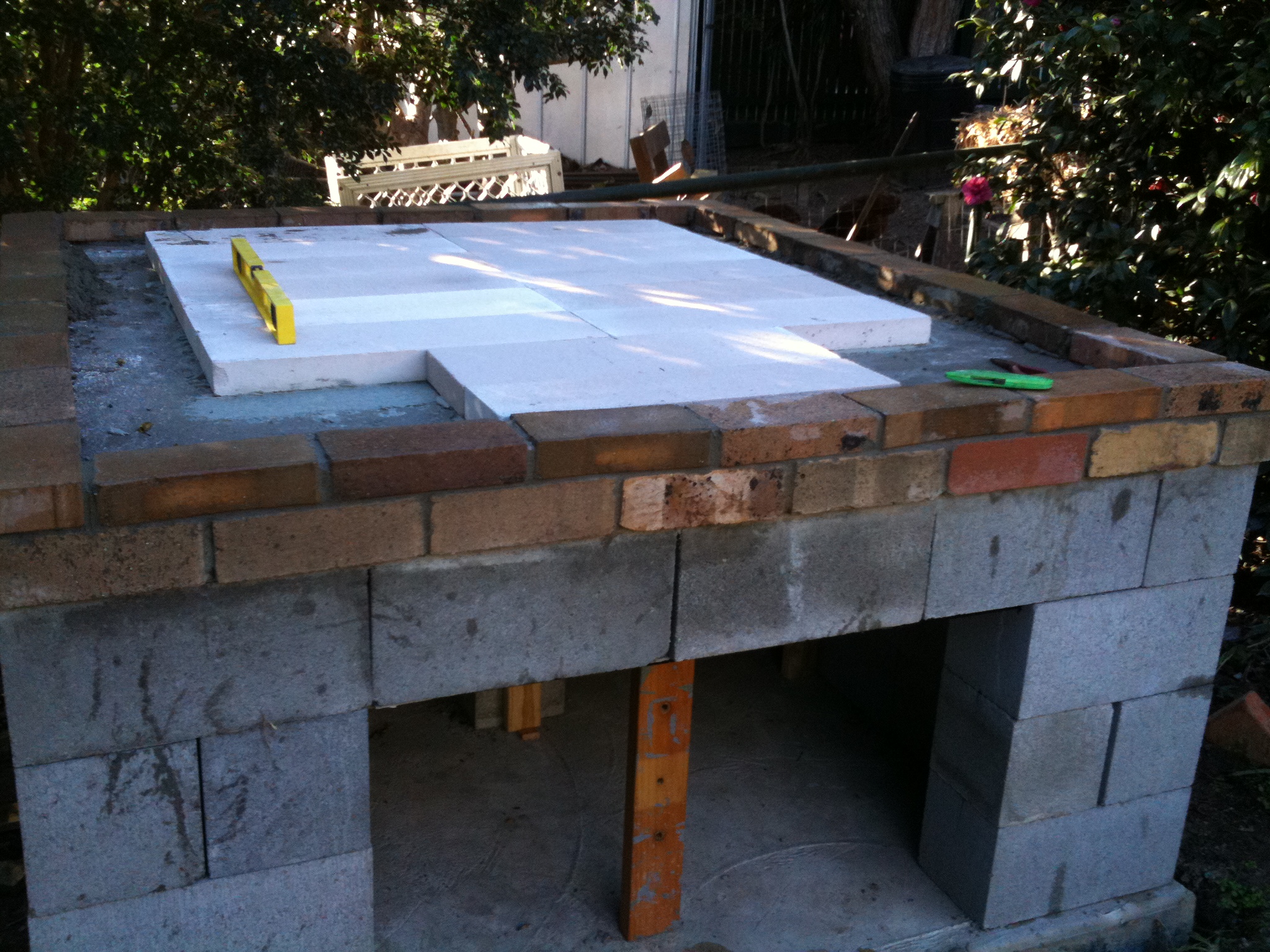

                          I have used Hebel as my hearth insulation Why... I had a good supply of it cheap? most free spent 20 bucks on the rest.
                          Works?.. seems to have had 4 pizza temp firing to date and cement slab remained cool.
                          Mix the cement by hand Wow you must be fit
Name:	hebel layer in position.jpg
