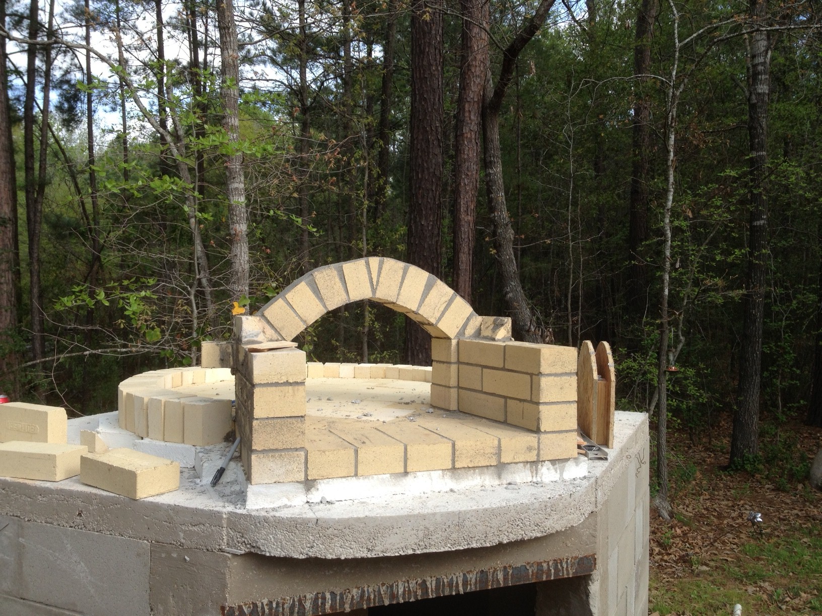

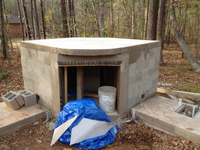

              I've made some progress on my build after quite a few delays, mostly weather delays.
              I am mixing my own hi-temp mortar, as are most of you guys I am sure.

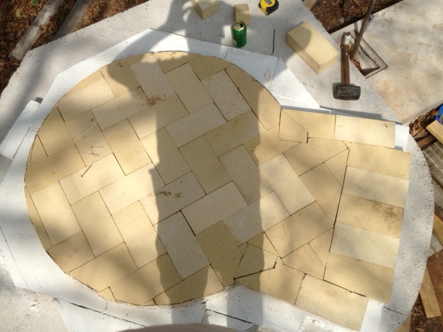

              I Found the medium duty firebricks for $1.43 each, maybe I bought too many as I bought 210 so I could use them for the floor too and have some spares in case I mess up.
              So far the process has been hard on my hands (see pic below) but easier than I thought. Laying out the oven and getting the floor bricks cut took a good while as it's a lot of cutting. I'm cutting with one of the Harbor Freight $189 wet saws and a $70 diamond blade from HD and it is working fine.
              I am at the point where my first, soldier course is up and mortared in place. I cut the soldiers in half rather than leave them full height as I am shooting for a internal height of 17". I don't want to exceed 19" so I figured if I shoot for 17" I've got some room for error.
              See the progress in pics:
              The top slab poured: Click image for larger version

              The floor of the oven laid out and cut: Click image for larger version

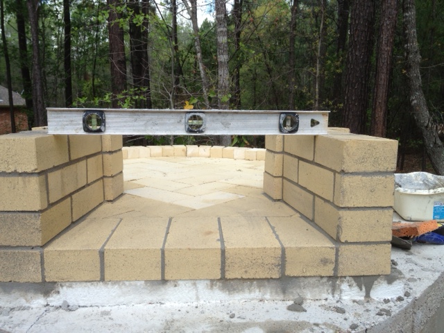

              The entry to the oven built, mortared and level: Click image for larger version
              The entry with the arch to the dome area built and mortared, built this arch first so I could build the dome up to it. Note that I left two full sized bricks to extend out from the side of the oven entry dome so that I could tie in my dome and entry very well. I also cut my bricks that transition into the dome from the entry on 45 degree angles so that this area would be very sturdy: Click image for larger version
