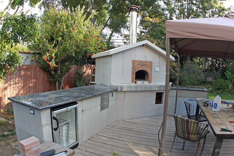

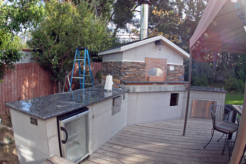

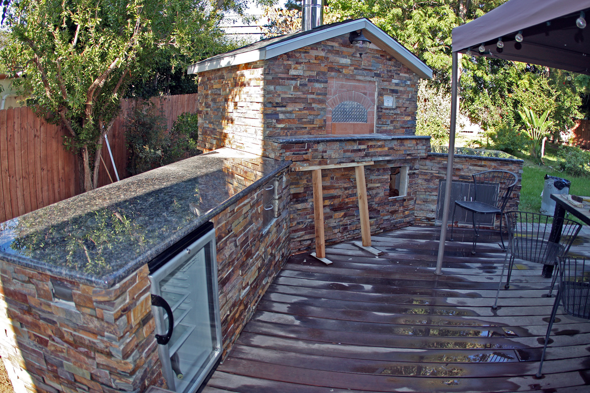

        My fridge arrived and I was happy to see I had actually measured correct- It fits like a glove:
        closeup:
        Hope to get the granite landing done this weekend and then finish things next week. I have my biggest pizza party yet tomorrow with 30 people coming. I made 35 balls of my pizza dough recipe I posted on here recently and am looking forward to using the 49" oven to its capacity.

          That's a good lookin' kitchen gt40!

            Ya mon! Verrrry nice!!! You're gonna love that dedicated counter space and fridge, altho with all the dough balls in there where ya gonna keep the beer?

              I designed in enough space to put a kegerator next to the fridge, subject to shmbo...

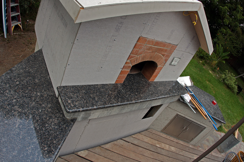

                Re: gt40's Pompeii Oven 42" build log

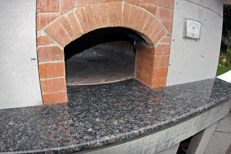

                Update:
                got the landing done finally:
                Stone vineer to finish...

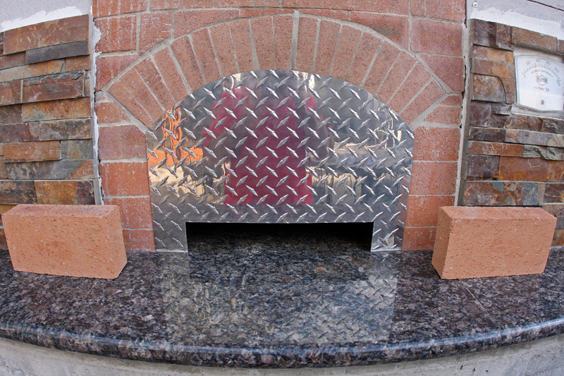

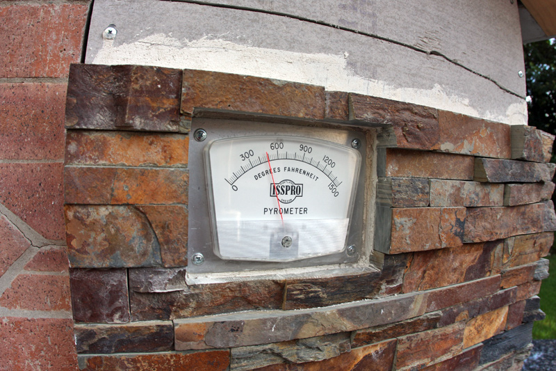

                      When I was working on the recirculating chimney design, the issue was raised that you would need to make a damper or something to cut off air flow beyond putting a door on the front. I made a temp door out aluminum tread plate - uninsulated. We had party last night and I laid the tread plate on the front with a couple of bricks at the end of the evening. This morning, at 9am it is reading:
                      Oven is firing up and hitting 800 degrees in an hour at this point and holds the heat so all that insulation is definitely the way to go.
                      Temp door shot:

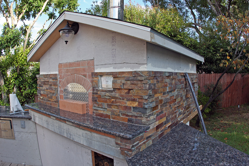

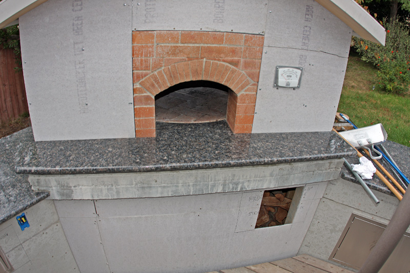

                      A few more pics of the home stretch putting up the vineer:
                      I can't wait to finish this!

                      • benguilford
                        • Dec 2010
                        • 100
                        #146
                        gt40, you have done yourself proud. What an amazing job, I especially like the bench tops, the whole job looks so professional!
                        As for your damper door - if you made an insulated version of what you're showing there, with a slide that allows you to adjust the amount of air being drawn into the oven (instead of just a gap) then you would be killing multiple birds with the one glorious stone! - Trapping heat in the oven during your warmup phase, preventing soot from staining the decorative arch and controlling the heat of your fire. Sounds like a plan to me, where do I sign up.

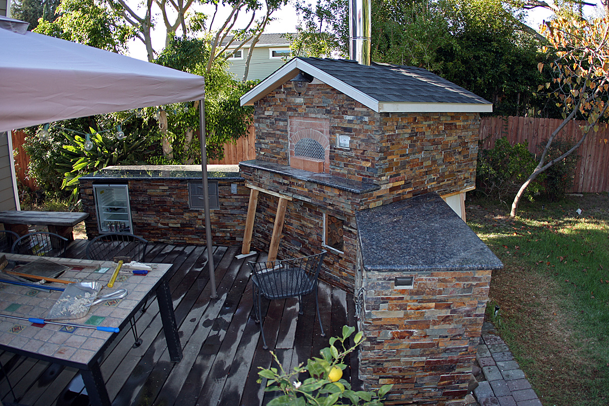

                          Finally done except for cleanup and the corner by the light:
