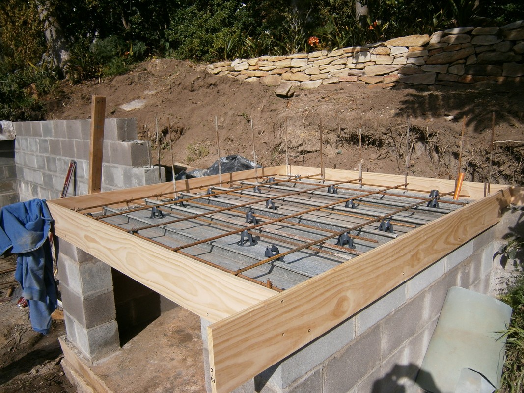

        Finally after much time and effort and cost my hearth is complete. Had a big weekend on the tools and moved 3.5 tonne of cement mix up my very steep driveway with buckets. It was a glorious winters day, about 22 degrees in the sun...beats working in the heat of summer.
        The hearth is incorporated into a retaining wall and is 120mm thick with N12 bar. The besa blocks are core filled and there is reo down 300mm every 200mm so this baby isn?t going anywhere. The hearth base is sitting on red ironstone. I used suspended metal sheeting for the base which worked out really well. My father in law had some lying around on his farm so when we were up at Taree he cut some down for me and I brought it home. The local metal supplier wanted 75 bucks per square meter so it was a handy saving and the first ?FREE? thing on the build.
        It?s taken me a long time to build the retaining wall due to the steep driveway and getting everything moved up plus some sanity time to recover from knee and elbow strains.
        The Mrs. laid the slab and I was the labourer. I am lucky she is a supporter of the project.
        We hired a mixer as we also had to core fill the retaining wall?this took about 2.5 tonne I rekon?big big job.
        I don?t think I have seen anyone using the metal slab, but it was easy as to form up and no requirements for propping up or supporting. Fingers crossed it will hold up ok. There are a few little hairline cracks at the front but they don?t appear to be right through. I think it may have dried out a little too quickly as we made quite a high MPA mix. I will keep it wet for a few days to assist with the curing.

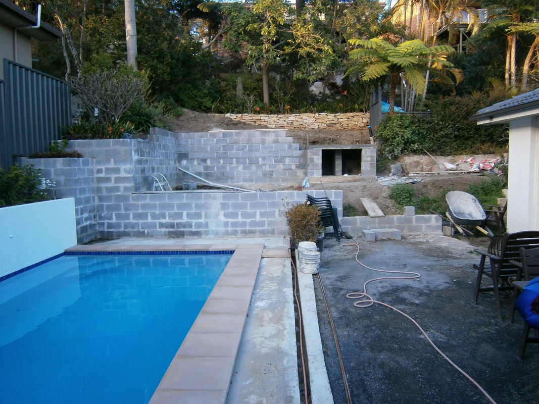

                Pic of oversite site
                  Hearth formed up

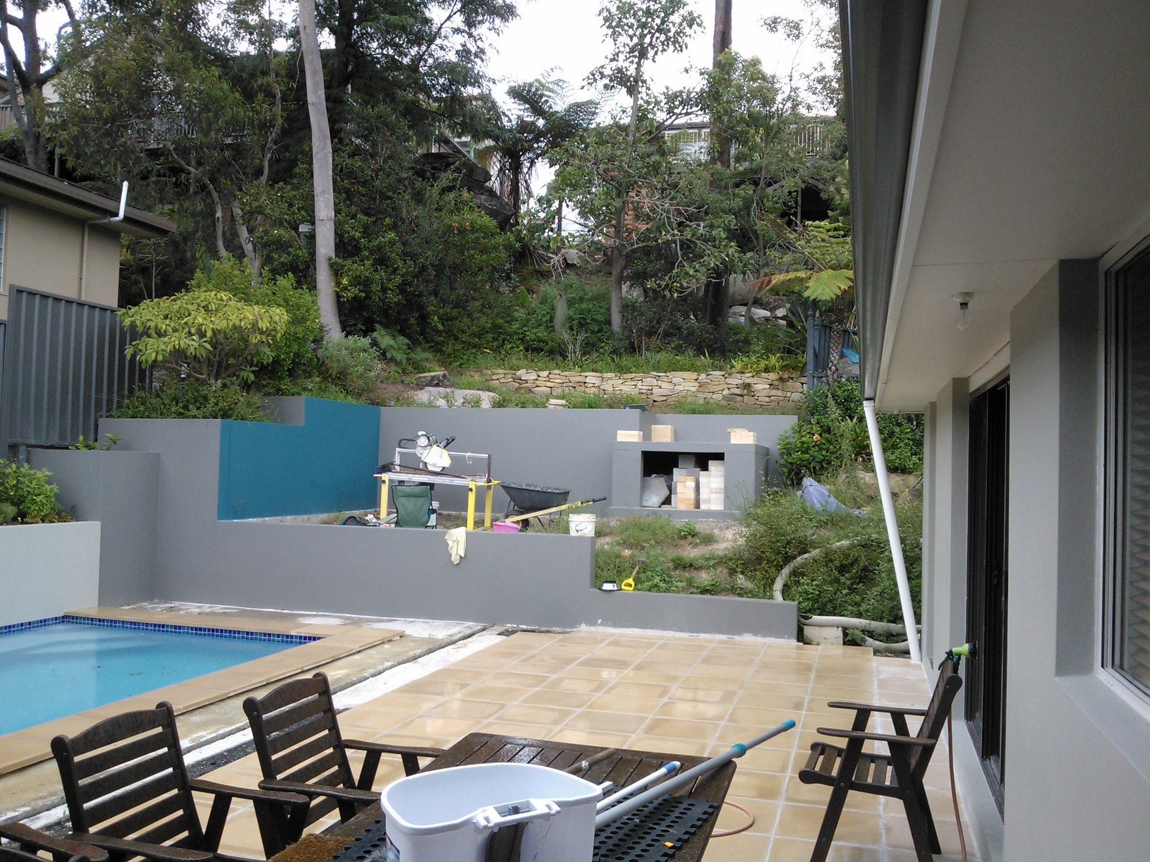

                            Re: Alex?s Pizza Kitchen (APK) build, Central Coast, NSW Australia
                            Hi WFO members,
                            OK, finally some movement at the station?
                            Pleeeease let this thing have a fire in it by the end of Winter.
                            My middle son wanted a pizza for his birthday on 3/6/2014, but alas work and life has gotten in the way!
                            See attached some pics of the first couple of courses.
                            I am pleased in general how it has turned out, I have tried to keep the lines as tight as I can and have been cleaning the brick as I go to avoid getting my tummy stuck later on.
                            I ended up buying refractory mortar at $46 a bag for 25 kilos?OUCH! Apart from the cost it is good to work with. I cannot believe how porous the bricks are.
