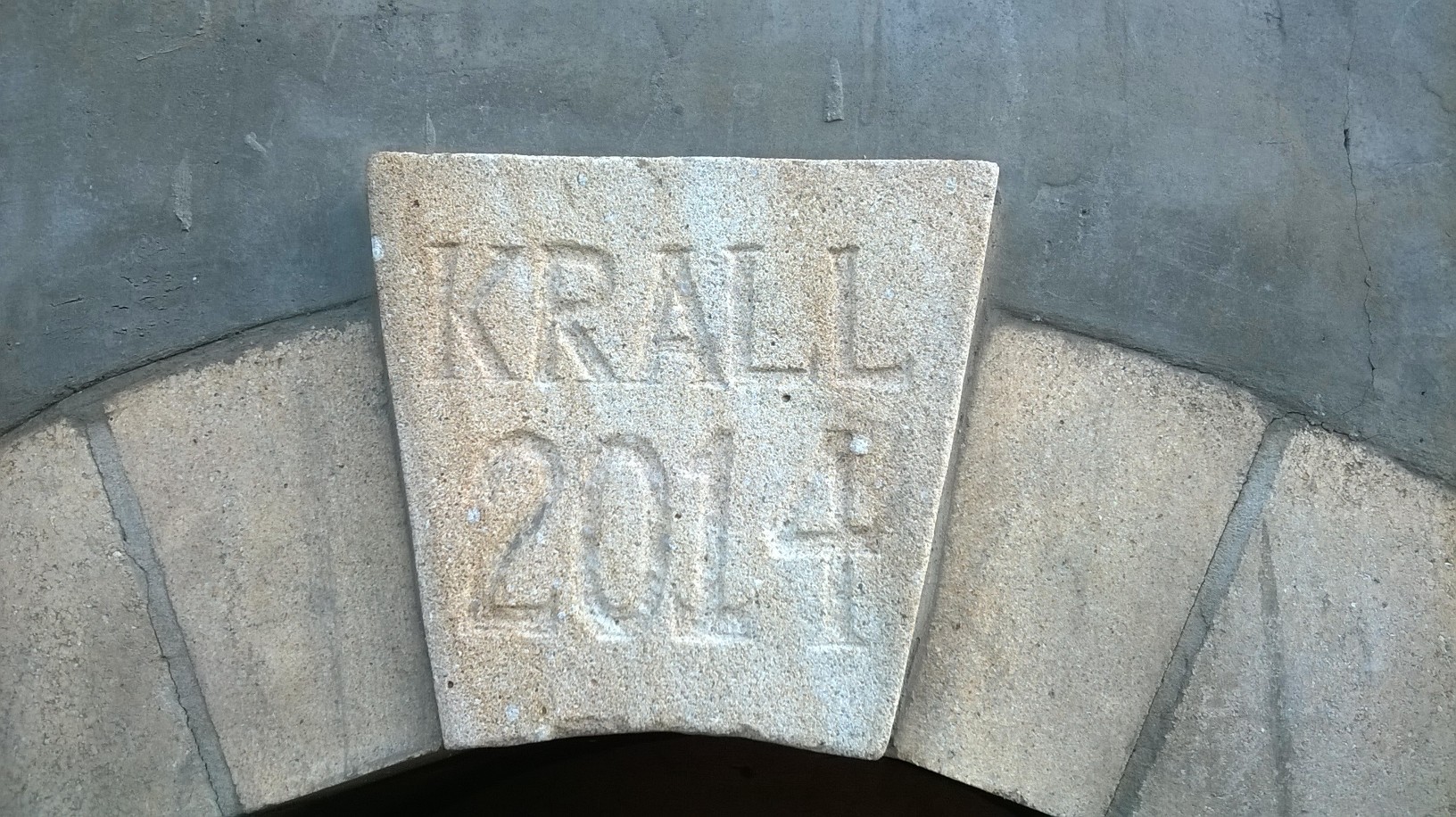

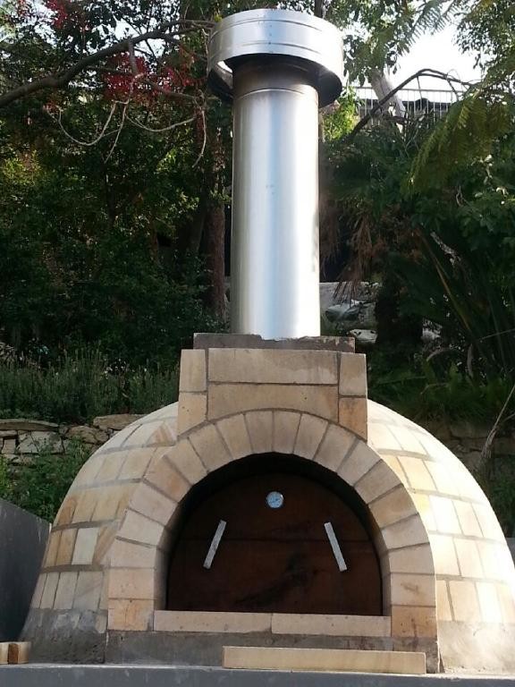

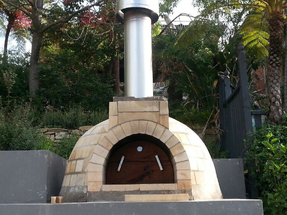

          Dear Russell, cheers, yes I was planning on cutting the arch bricks, but the concept is confusing me. The first photo is where I am currently at. The first course and second course are in, but I cannot figure out the third course angle. I marked top and bottom on the brick and cut it to mirror the dome. It looks and fits well however I am not sure how to progress it further. The door arch will be higher than the dome brick course so I guess that?s where the taper comes in together with the back off the arch to allow the dome brick to intersect it as it curves in.
          The second and third photos are where I need to eventually be. I know some peeps build their door arch first but due to the access issues for my oven I decided to build it as I go?didn?t want to knock and damage.
          Dear Colin, yes the things are so porous it was the only way to get the things down. The site attracts a large amount of heat and I have noticed with the hot Autumn weather the slab and bricks dry out remarkably quickly.
          Any assistance that the forum could offer regarding the marking out of the door transition would be great.
          Cheers Al

              I think those photos of the arch have made everyone believe that is your oven, but I think those pics have come from Field Furnace.

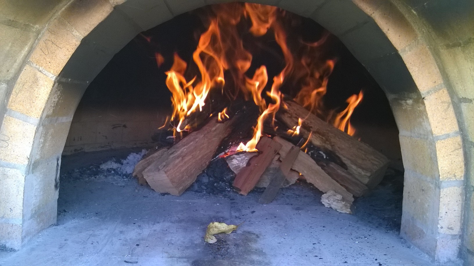

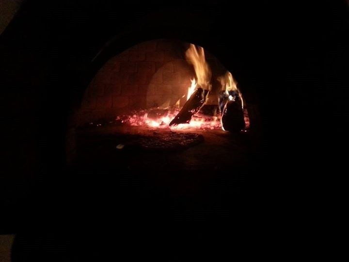

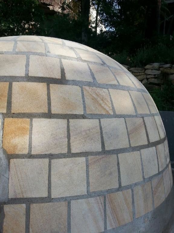

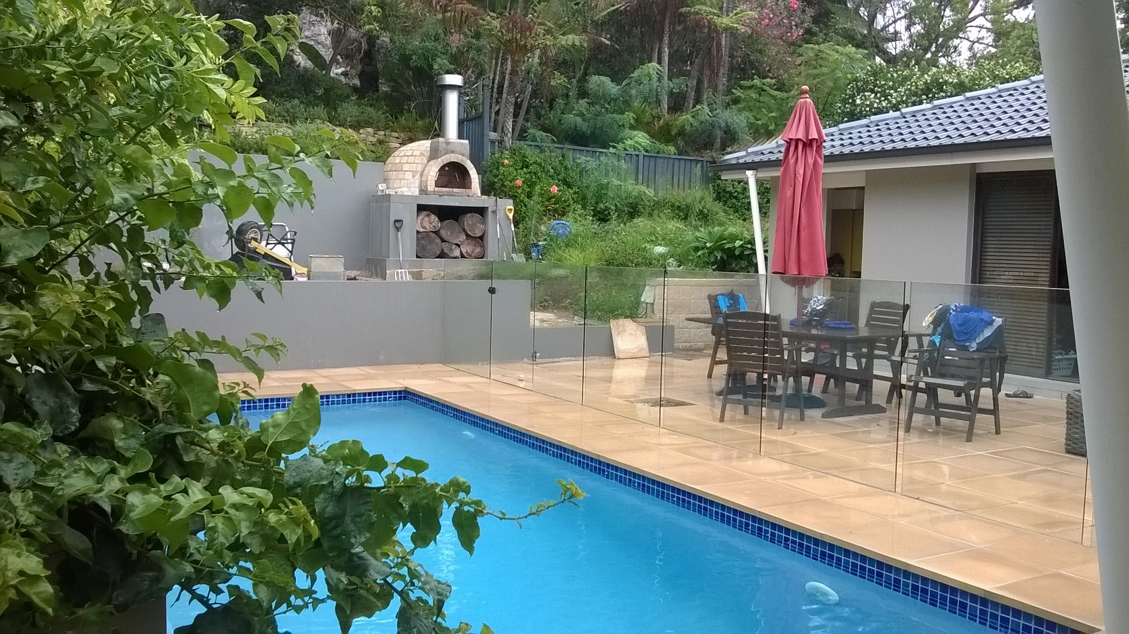

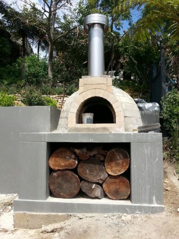

                  Well I've been lazy with my posting so here is some updated photos. I may do something unorthodox and work my post back with photos.
                  I am very pleased with how the oven has turned out. I've been using the oven since September last year and it has great temperature holding capacity. I can generally get 3 days of cooking out of it after firing and slow cooked lamb shanks are a favorite.
                  Did Guinness Pie filling in it last night (Sunday) from a Saturday fire (forgot to put the door on when I went to bed so lost quite a bit of heat) however the oven was still stable at 150c. Ideally I was going to put 75mm of ceramic blanket but I had two issues 1. ran ever so short with product 2. the added thickness would not have been viable as the dome would have encroached with side wall.
                  I need to build the floor level up to oven floor height and tile it then I'm done!Click image for larger version

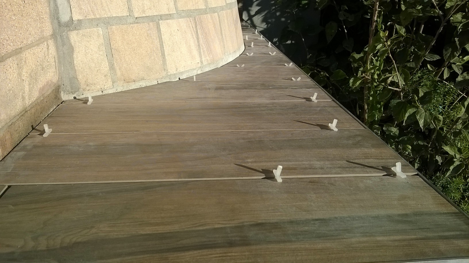

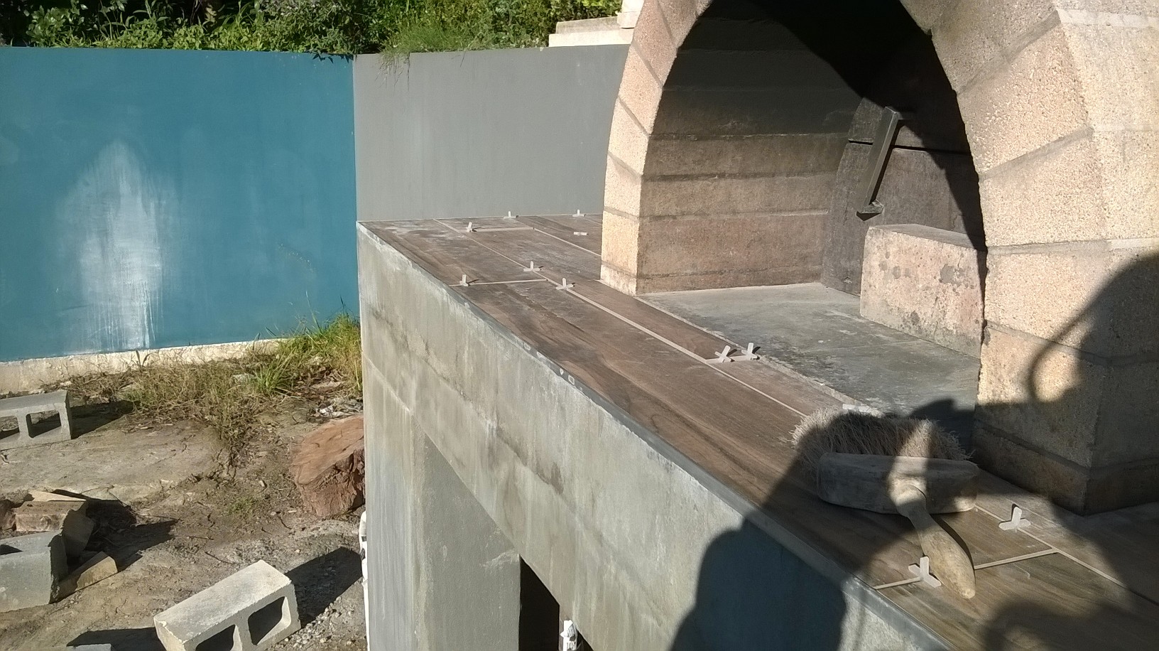

                          Been a while and noticed the new look forum! great for adding pictures.
                          Mucking around with some fake timber ceramic tiles for bench top.
                          I created an edge with some aluminium tile strip.
                          Heaps of work like anything to do with the WFO. Lots of cutting. I get some cardboard and make a template then transfer it to the tile.
                          Happy with the look just need to finish cutting and glue down.

                                Thanks Alex and Randy
                                I was initially looking at a wood bench top but the oven is extremely exposed and there would have been a lot of expansion and contraction.
                                I though these ceramic wood tiles would be a good alternative and hold up to the various temperature fluctuations.
                                I spent the extra money and bought the flexible tile adhesive...Hopefully she holds up. It certainly stuck good.
                                Although I've been using the oven for a year it isn't really practical for parties yet. A deck still needs to be built together with some steps and a platform for the oven. Once that is complete she'll be a goer!
