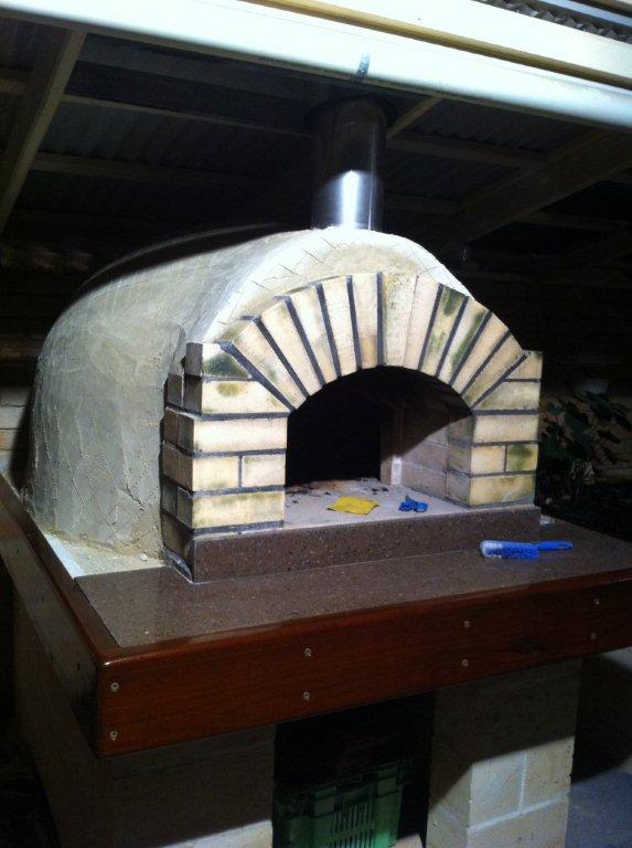

        #33
        Re: Midwest WA build
        Another step closer.............

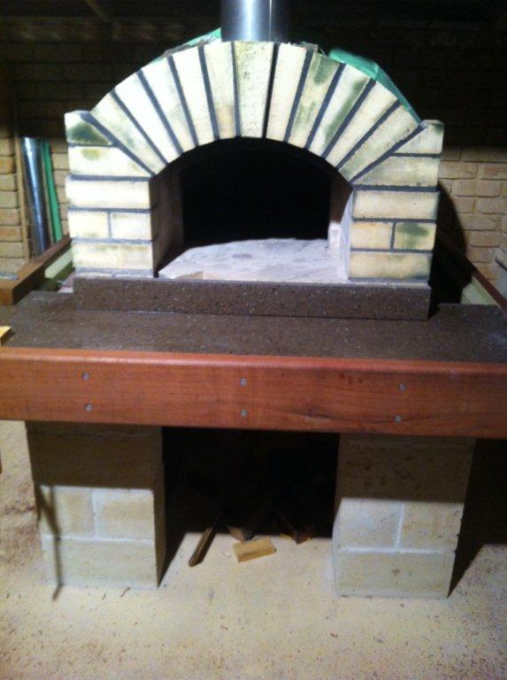

            #35
            Man Ive been hammering the oven every week end since completetion , put on a few kilos as well. Not 1 crack in the oven except for a 5cm long hairline in the render surrounding the chimney Ive had it to over 500 degrees C . Most of my friends are pissed at me because there now saying they wont buy ordinary pizza any more ! And to think 5 courses from the top I was thinking it was all too hard
            Big pizza night for new commers tonight
