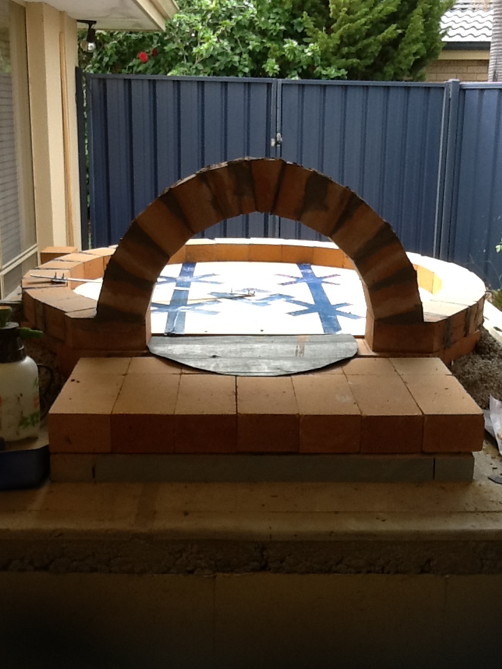

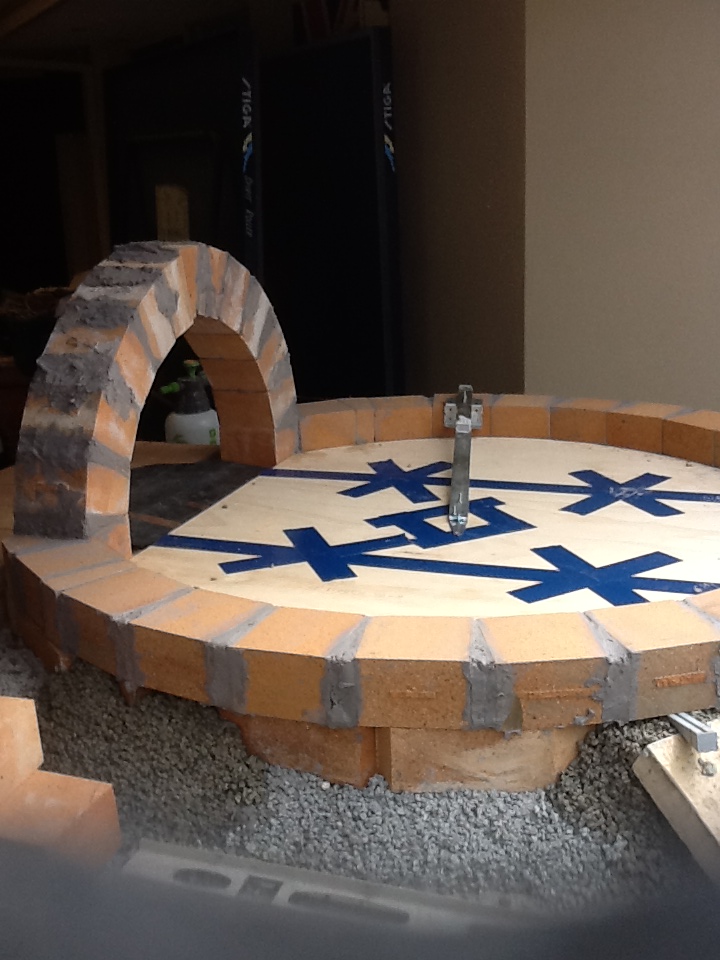

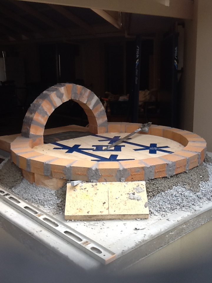

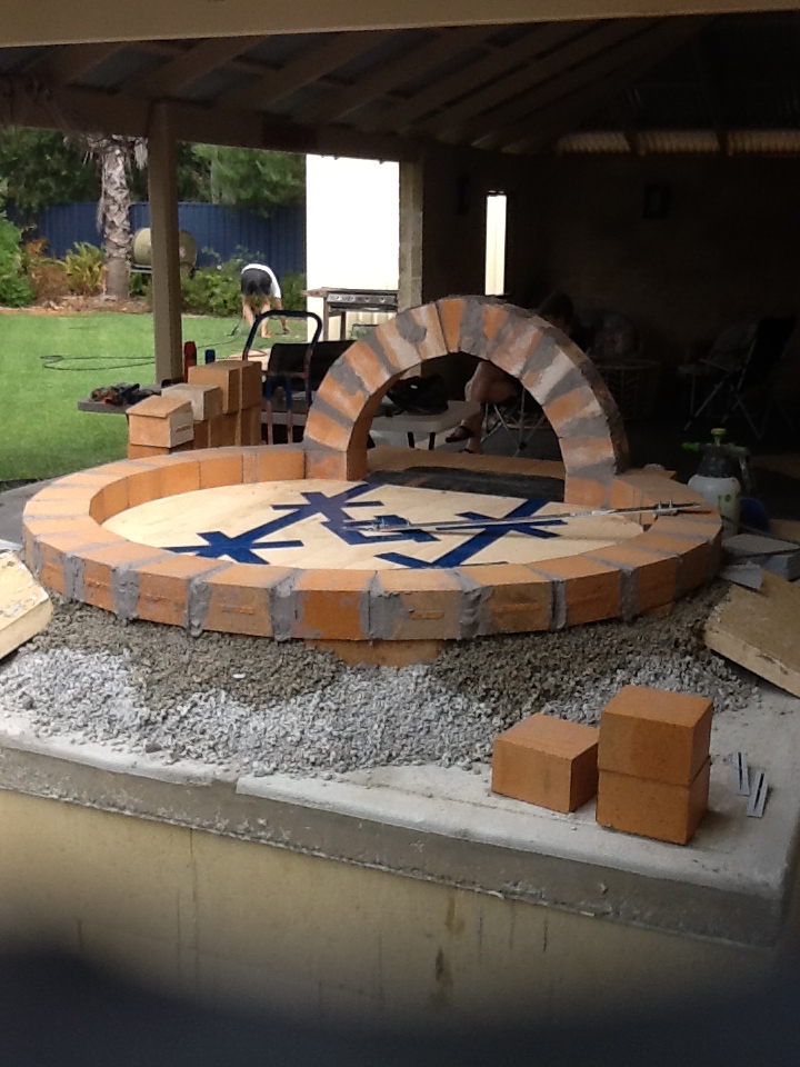

    I'm about to start the first course with high heat mortar. Before I do that, am trying to visualise how the dome will integrate with the oven opening. I'm going to use angle iron for a rectangular, 20" entry - I'm just not skilled enough to do an arch, unfortunately.
    See attached pictures. Questions are:
    1. The two (three in the last picture) vertical half bricks these will eventually be 4 to make the height of the opening - should I mortar them like normal bricks? I'm thinking it would make them stronger, and also lift them sufficiently to allow the next chain on the dome to sit on top of the angle iron.
    2. Is the general arrangement as shown for the oven opening acceptable? I've left a reveal for the door. Trying to minimise cuts, keep it simple. It won't look as nice as most I've seen, but is it going to work?

    Re: Perth 42" Pompeii - dome to flat entry integration
    You need to keep angle iron out of the equation, it will distort and rust.

                        Sorry, accidentally deleted my post, that didn't have pictures, so here's it again, in summary:
                        This may be the dodgiest build on the forum, but I have built an inner arch and first course. Note the many and varied mistakes - one could spend hours picking them out! Any resemblance to Cheesesteak's oven is purely coincidental, therefore! Before I move on, is there any reason to redo this arch? I'm not going to stand on it, that's for sure, but when is near enough good enough? Appreciate the mentoring to get me this far (originally it was going to be a flat entry and angle iron, remember?), but don't be shy in any advice or counselling you may care to give (such as "quit while you're ahead ... ha ha).

                        • brickie in oz
                          • Mar 2009
                          • 3445
                          Carry on with the build, the dome will buttress the arch and stop it from moving further.
