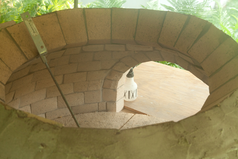

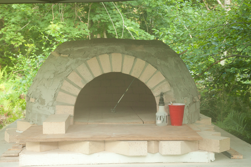

Hi Dave, I did not pay as much attention to the seams as I should have, but did try to keep the small bricks in the front. I had a huge crack in my dome from floor expansion.(my fault for not being more attentive to cleaning out the gap between the floor and dome) But if you looked at this fissure running up the wall, not only did the crack appear in a couple of mortar joints but at least one firebrick cracked
So, I agree with Faith that seam alignment is almost purely in the eye of the beholder.
