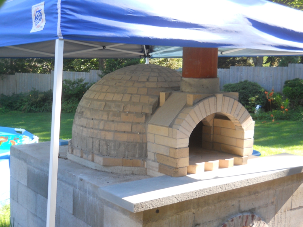

ID:	290561I have finished my oven!
                          Now the enclosure is developing in my mind so I thought I would revisit this topic, not so much for the wood but for the use of metal studs as rafters. I have searched the FB site and the web and haven't found any specific recommendations for using metal studs for rafters. I live in RI and worry about heavy wet snow buckling a metal stud (even 2 together, making a solid beam). I plan to use 4? wide block for the side walls and pitch the roof using metal rafters. I?ve thought of using some stops between the rafters and some metal plates used for wooden truss fabrication. Has anyone come across instructions on how to build rafters from metal studs?
                          I am going to wire reclaimed slate to hat channel attached lengthwise across the rafters (no sheathing) but again, I?m worried about the load on the metal rafters.
                          Any thoughts?
                          Thank you,
                          Greg in RI
