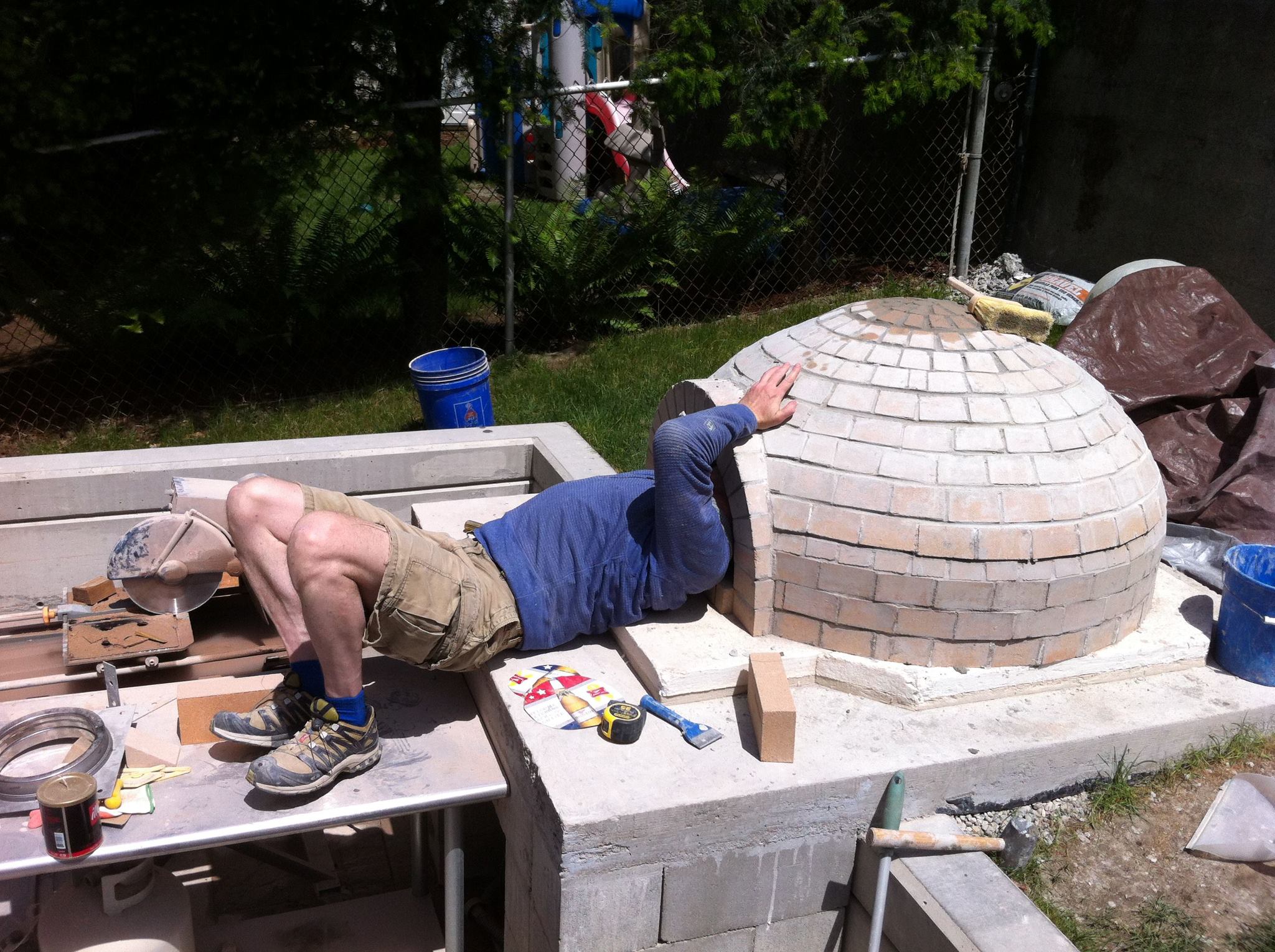

            • mrchipster
              • Apr 2010
              • 1502
              Re: 42" Inch WFO with 24 inch dome height
              Originally posted by MAD1
              Phxdt
              I made a bigger mistake i made mine 26.5 with a 12.5 door... I was going to try to fix it but had positive feedback so I left it alone. I hit a white oven in about 1.5 hrs ( not sure if that's good or in the ball park?) but pizzas turn out great... no issues with other foods and breads. all good.
              Mark
              You need to stuff the legs in too otherwise they will be a little rare.
              Chip
              Chip

                • mrchipster
                  • Apr 2010
                  • 1502
                  Originally posted by Laurentius
                  Hi Chip,
                  I'm confused. What legs, needs stuffing in?
                  Look at picture one of post 4 above by MAD1.
                  A joke is not good if it needs explanation but here we go, MAD1 refers to cooking other food in his oven and it is "all good" In the photo MAD1 is in the process of building his oven and someone is sticking legs out working on the oven build, it looks like he is cooking someone in his oven but in order to get the legs cooked he should have them inside the firebox or they will not get cooked or they will be rare - underdone. My attempt at humor lost again to the heavens.
                  Chip
                  Chip

                      • MAD1
                        • Oct 2010
                        • 20
                        As I like to tell everyone... the breast may be done but the legs have a while to go!
                        This is my father-in-law who helped me build my oven. Great guy!
