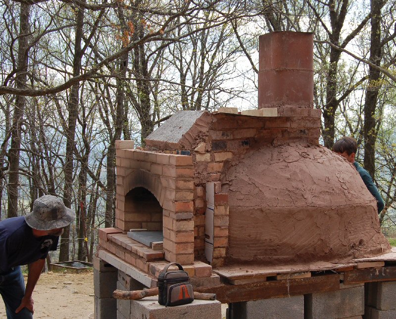

      I have seen ovens that use what is called a "beaver tail" chimney design - where the flue curves back over the top of the oven. You could probably rig something like that up to make it work. Aesthetics may be another issue - but I imagine you could probably use stucco to make it look pretty good
      http://www.fornobravo.com/forum/f9/b...one-14918.html

            Re: Need design advice please
            Personally, I dont think it is a good idea. The chinmey located in the rear will create a huge draw of air from the fromt opening, across your fire and out the back.....I dont think you will capture and retain much heat in your oven plus you will burn through a lot of wood.
              I do like the beavertail design however....make sure your chimney opening is exta-large to account for extra flow-losses.
                Do a google for beaver tail chimney, the flue exit is located at the front of the oven.
