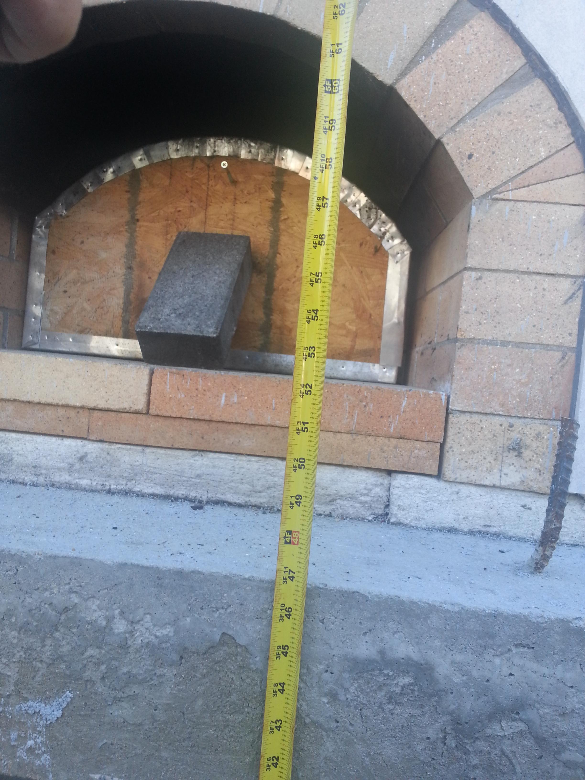

              I am 6'2". I used 5 blocks in my base, in part due to a raised footing above the level of the patio, my final cooking floor height is 52 inches above the patio. I find it very comfortable to work in Click image for larger version
Name:	2013-01-08 15.19.24.jpg
