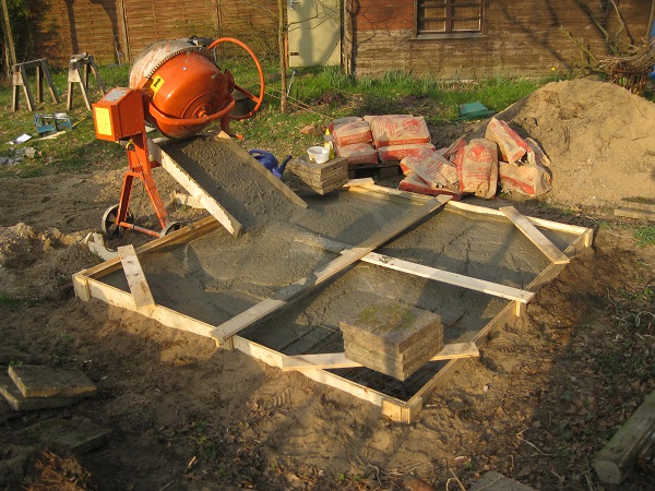

    Some pictures of my 47" - Pompeji-oven:

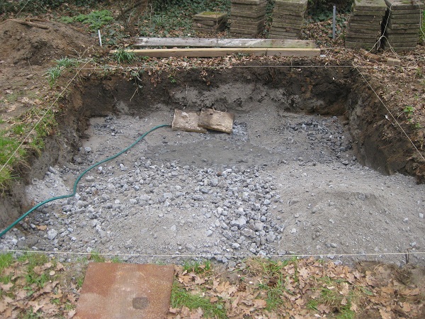

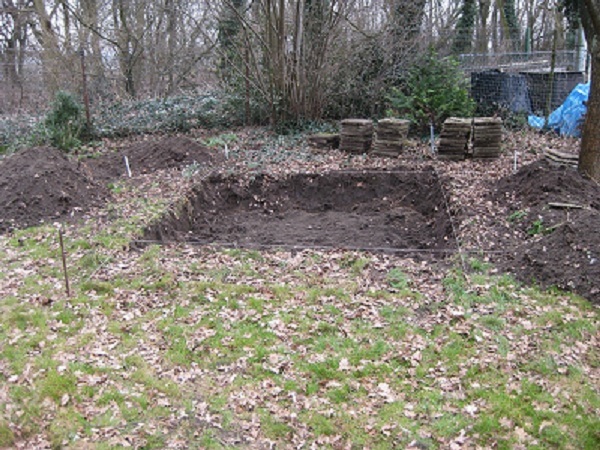

    This is how I started, I dug a hole 2,5 m * 2,5m, 0,7 m deep-

    Ready for concrete!

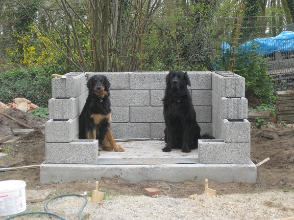

    Our dogs, the breed is called "Hovawart", which means that they will protect your home. They do!

                  That is an interesting choice of floor insulation Are the air spaces in the "engineered brick" the only insulation/heat break between the oven floor and the slab?
                  • CvC
                    • Mar 2012
                    • 35
                    Re: 47" - Pompeji
                    Originally posted by Gulf
                    Looks great!
                    These "engineered bricks" are sold under the brand name "Poroton" (which means something like "clay with pores") in Germany, usually they are used to build houses and have excellent insulating properties, comparable to Hebel/Ytong.
                    (The coefficient of heat conductivity is about 0,07 W/mK.)
                    So, yes, these bricks are the only insulation between hearth and slab and I think they are much better than vermiculite.

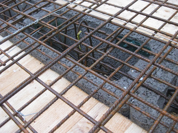

                        Looks like you take your rebar seriously there in germany!

                            Yes, we do, what did you expect, we are Germans?!
                            We dont spend hundreds of hours of work for an oven, that doesn?t last forever!
                            Another reason, why I built it just a little bit oversized is, that I am living in a region where you have to expect minig damages to buildings (coal mining in the Ruhr-area).

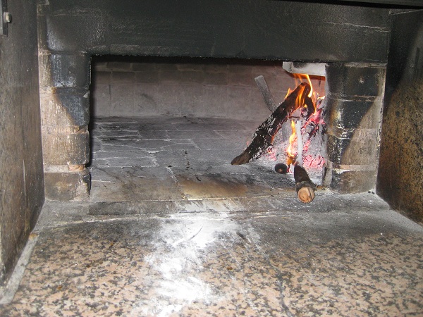

                              Last year, we spent two weeks in the Toscana, Italy. We found a nice little Restaurant in Montescudaio, called "Osteria il Forapaglia", the Pizza was the best I?ve ever tasted so far.
                              The manager didn?t allow me to go into the kitchen to see his oven, but made some pictures of it:
