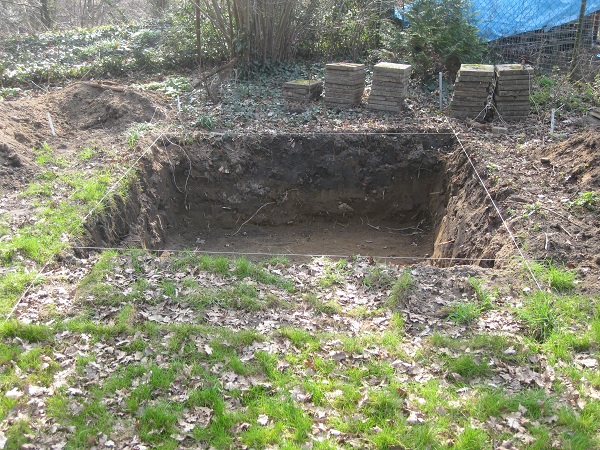

    Some pictures of my 47" - Pompeji-oven:
    This is how I started, I dug a hole 2,5 m * 2,5m, 0,7 m deep-

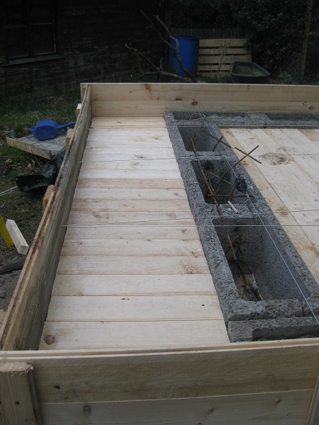

                        Looks like you take your rebar seriously there in germany!

                            [ATTACH]35377[/ATTACH]
                            Yes, we do, what did you expect, we are Germans?!
                            We dont spend hundreds of hours of work for an oven, that doesn?t last forever!
                            Another reason, why I built it just a little bit oversized is, that I am living in a region where you have to expect minig damages to buildings (coal mining in the Ruhr-area).

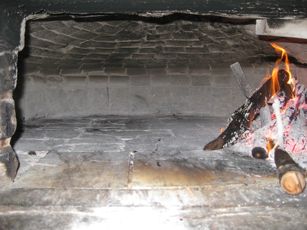

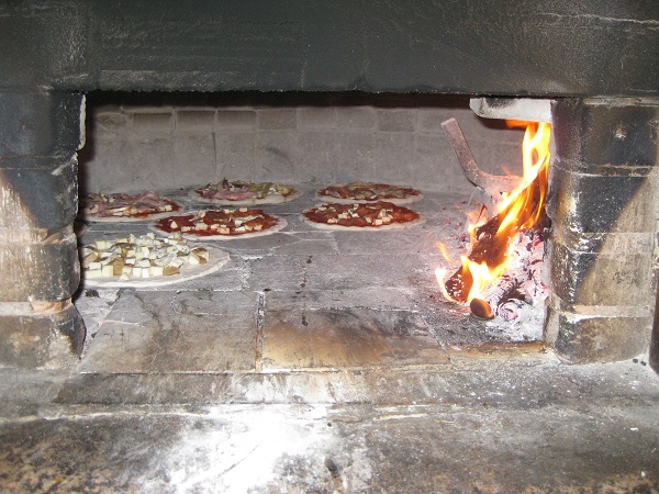

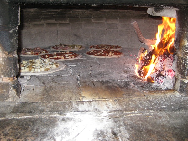

                              Last year, we spent two weeks in the Toscana, Italy. We found a nice little Restaurant in Montescudaio, called "Osteria il Forapaglia", the Pizza was the best I?ve ever tasted so far.
                              The manager didn?t allow me to go into the kitchen to see his oven, but made some pictures of it:
