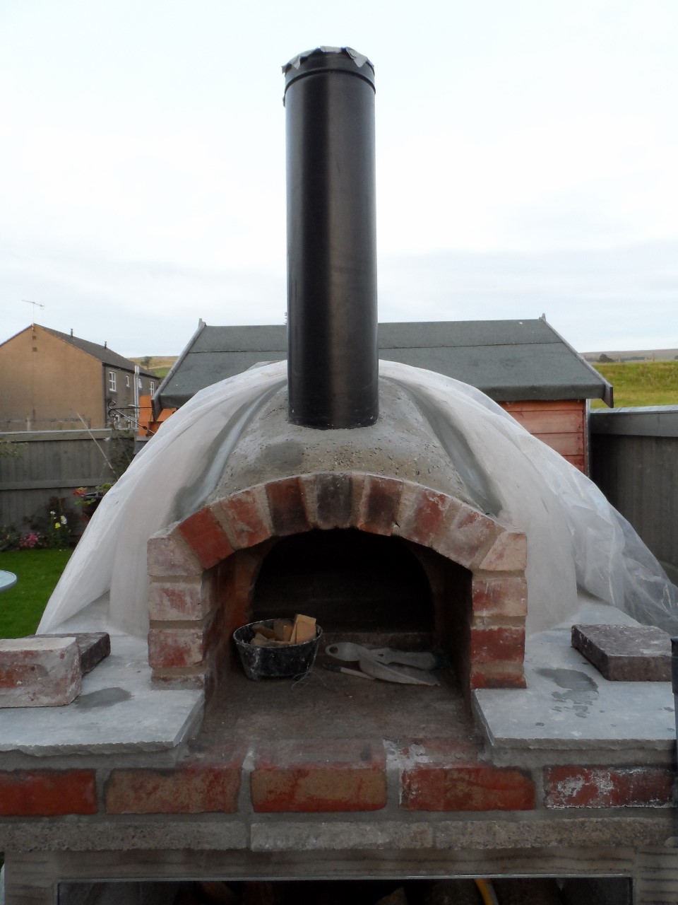

Keith - I used chicken wire and it worked fine. It held the vermicrete until it set. Once that is in place the subsequent layers are easy/easier. I assume you are buillding an igloo.
