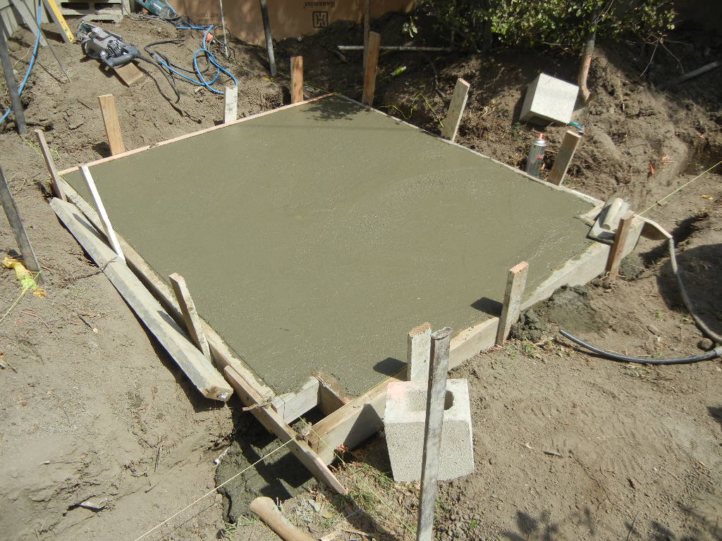

                      A few pics of the progress to date. Basic stuff, Yard location, Foundation.
                      • bnac
                        • Mar 2012
                        • 11
                        Re: 39" Tutto Forno in Socal
                        So, I guess I don't have the posting routine down as well as I thought I did. Standby, looking for the answer.
                        • bnac
                          • Mar 2012
                          • 11
ID:	295779 The obligatory foundation pic.
