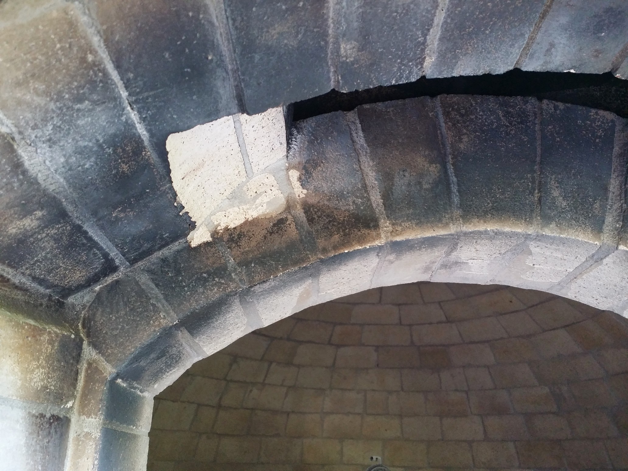

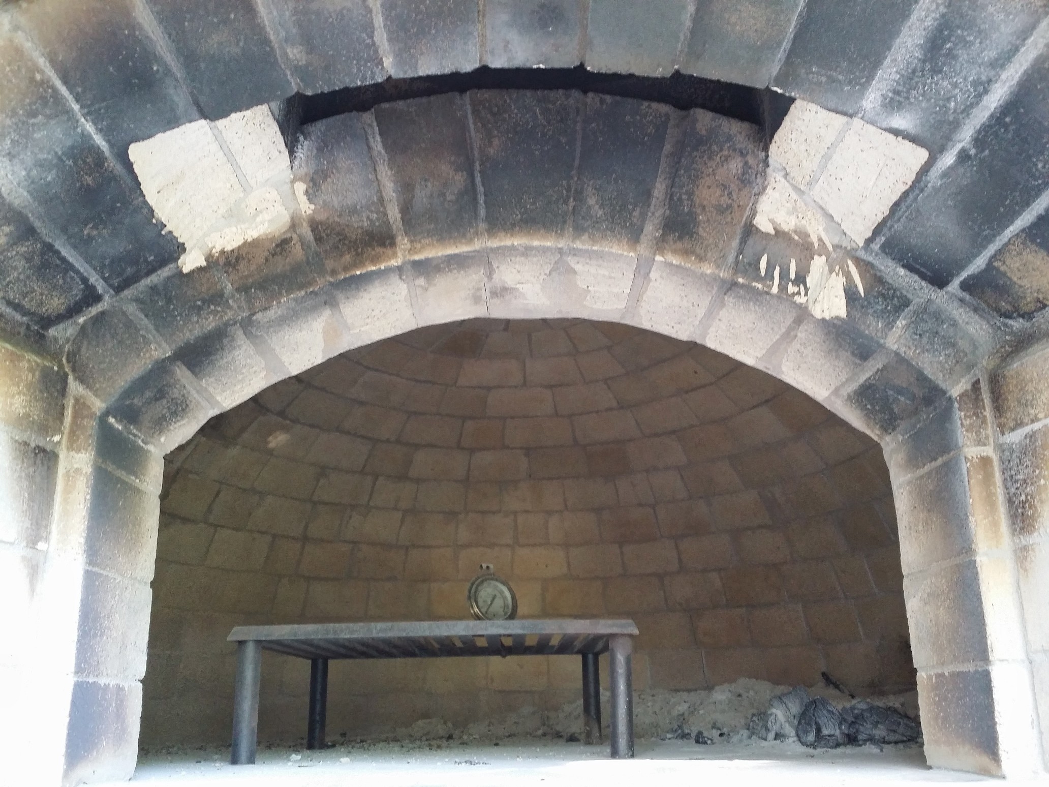

    What you are proposing will not compromise the arch integrity at all. Grind away.
    • Re: 42" build in Central Texas
      Have you tried a lit roll of twisted newspaper in the throat opening before you light your kindling? That metal transition and flue will heat up fast and it may be all you need to stop the blow-by.
        Well, no I havent tried it since I installed the 8" extension/flashing. The Cap has a spark arrestor screen and seems to drag my airflow down. I think I'll grind it anyway.

          I would grind it too, that throat looks small for a 42"...it certainly won't hurt anything. Try the flue preheat too, you might be surprised
            Garner,
            The preheat works! I've seen it work many times over the years in fireplaces. In more recent years, my oven. Masonry chimneys can cool down over a few days. In the south, where we live, it is not uncommon to have temps in the 30's at night and 70's by afternoon. The masonry inside your chimney wont warm up as fast as the ambient air. The cooler air inside your chimney will naturally fall out of the entrance of your oven. That is the reverse of what you want. I would do as Stonecutter advises before breaking out the grinder. Preheating cures a lot of problems
              Originally posted by Gulf View Post
              Garner,
              Yeah, I recall you telling me this before Gulf and I think I just forgot to do it. Ive only fired it 4 times beleive it or not... I did however break out the grinder today. I gave it a little taper on either side. I made a dumb mistake while doing it, not realizing exactly where ALL of my blade was at all times. Trying to cut square with a round wheel, I dug into my reveal a bit . I can fix it but Im very irritated!

                Trying to cut square with a round wheel, I dug into my reveal a bit .......... I can fix it but Im very irritated!
                You build has turned out to be another one of the superb builds on the FB, It deserves a mention on the treasure trove list. The tapers should help with your draft, once it all black with smoke, no one will ever notice the mistake except you. They will only notice the ones we point out.

                        Kind of like getting the first door ding on a new car. Like Dave says, soot will soften the look, it just looks worst with the contrast right now. Pizza and food will taste the same.
                          I don't know, that entryway is all butchered up after that grinder fell out of your hands. Better break out the sledge and have at it.
                          I wonder what kind of dreams you will have now?
                            Ha, I was just reading thru my whole thread (while watching Forrest Gump) recalling all of the great comments, advice, humor, and psychology....
                            My only concern is that "door ding" is right where my door will seal against the reveal. Thinking I'll mix up a Tablespoon of Heat Stop with some tiny firebrick pieces in it and try to regain the original form. Its my nature to want to "fix" it!
