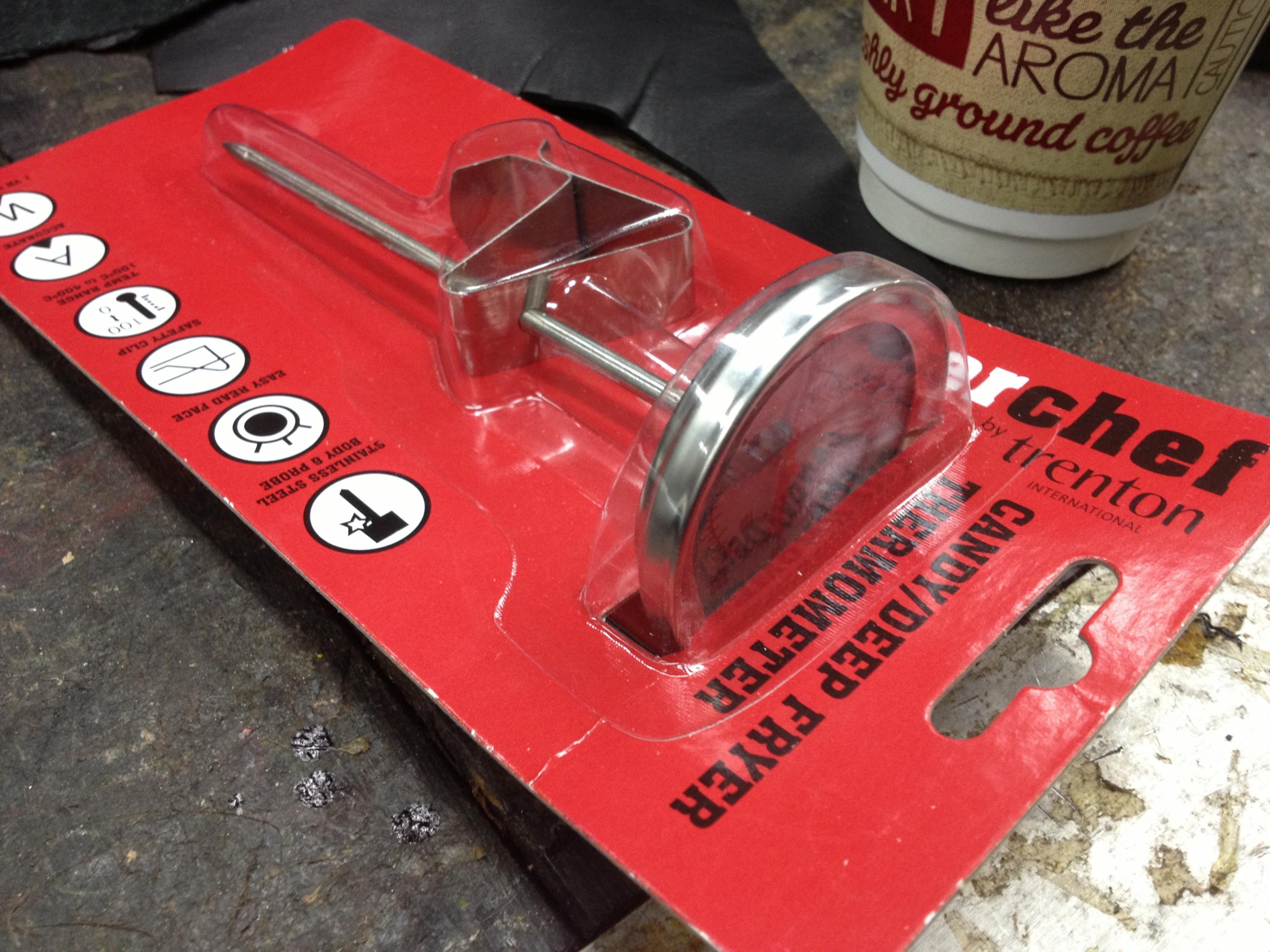

      Dropped in at the hospitality supplies shop after work Sat. No pizza oven thermometers , but I did find this. It's a candy/ deal fat fryer thermometer and reads from 100c to 400c and has a 100 mm probe. More than suficient to fit into an insulated door for a WFO for that cooking without the fire
