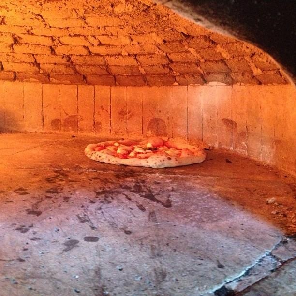

                        G'day
                        This is the " ridge didg" ( Australian for real) Neo oven built for the full pizza
                        kitchen, running 12/7. Cannot fail cause the business will bust pizza oven!
                        I don't know about you but I recon my brickworks a bit better
