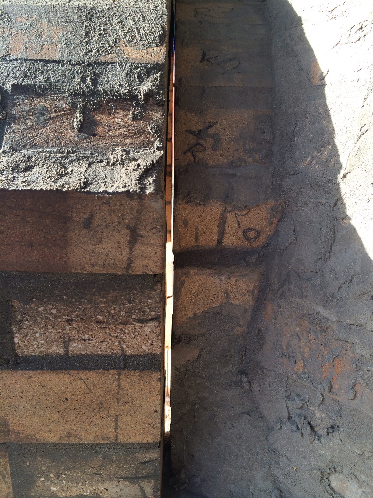

    well since my last post today is the only chance ive had to do anything at all to the oven, spent the whole day completing the outer arch, made a form 2 inch bigger than my inner arch form for the reveal my opening ended up 11 1/2 inch by 8 inch i hope this is big enougth Click image for larger version

    i removed the form about 20 mins after the last brick was laid you can see in the pic not to much to clean up the last pic is the heat break il fill that tomorrow with the fire rope

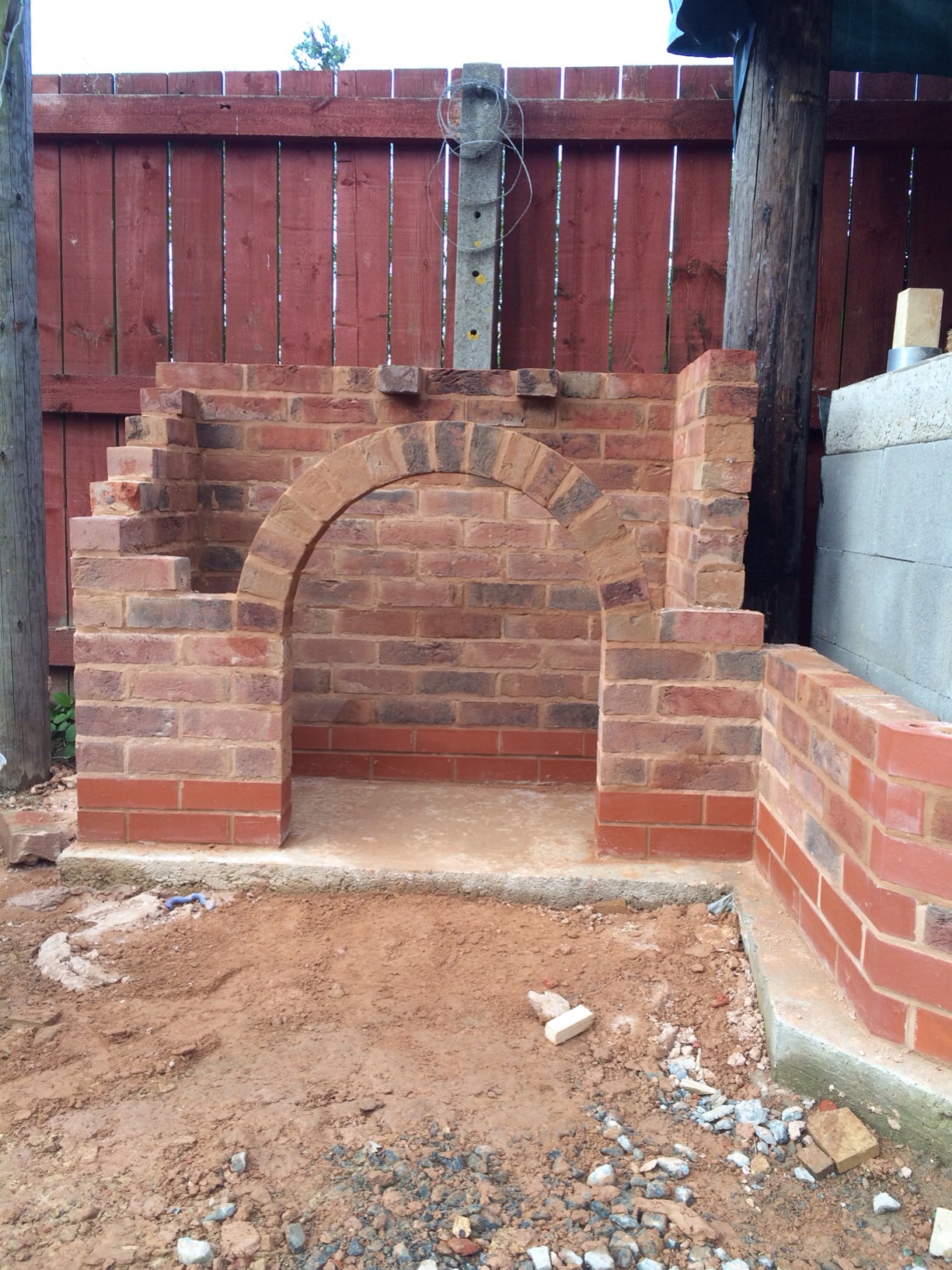

                        Got a little more brick work done tapered all the arch bricks with the sthill saw for a more even joint. Only getting one day a week on the oven is really slow progress but it's all I get nowadays Click image for larger version

ID:	305881 I've used red engineering brick squints for the corners should look better the further up I get same size arch going under oven as the prep area
