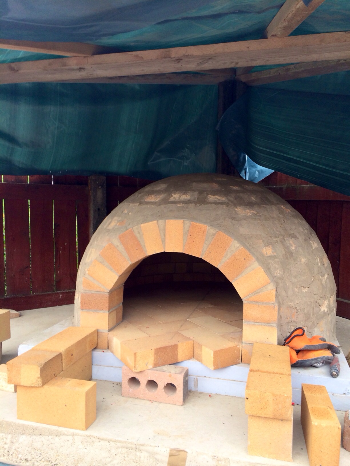

            Re: 7 years in the waiting i get to start my 42" pompeii
            Thanks a lot guys hodgey1 I have 2 ideas for the enclosure both up hill again i think! rather brick igloo effect or hand cut natural stone just want to get the outer arch sorted first .
            I don't have enough calcium silicate board left for the size it's going to be but enough for 1 layer for the inside arch floor inside as I really wanted the arch wall bricks to sit on the hearth as my chimney is going to rather heavy with a 8 inch 3 ft long clay pot and a brick skin half way up I've seen this product on to lay on the concrete hearth to protect from heat Ceramic Fibre Paper 3mm-Vitcas Ceramic Paper I would lay it the full area of arch and lay the arch wall brick straight on top then cast some verm mix on the inside half a cal sil board up then use the bits I have left for final base for firebrick do you this would work?

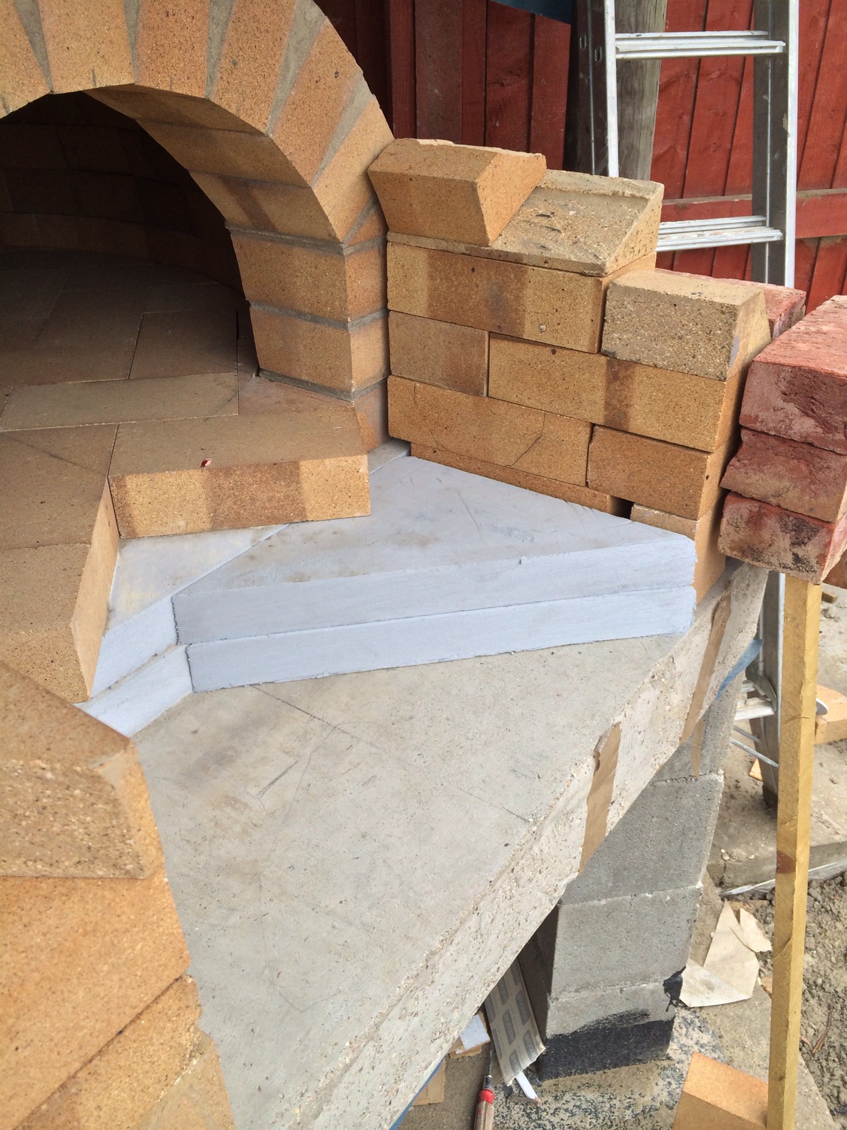

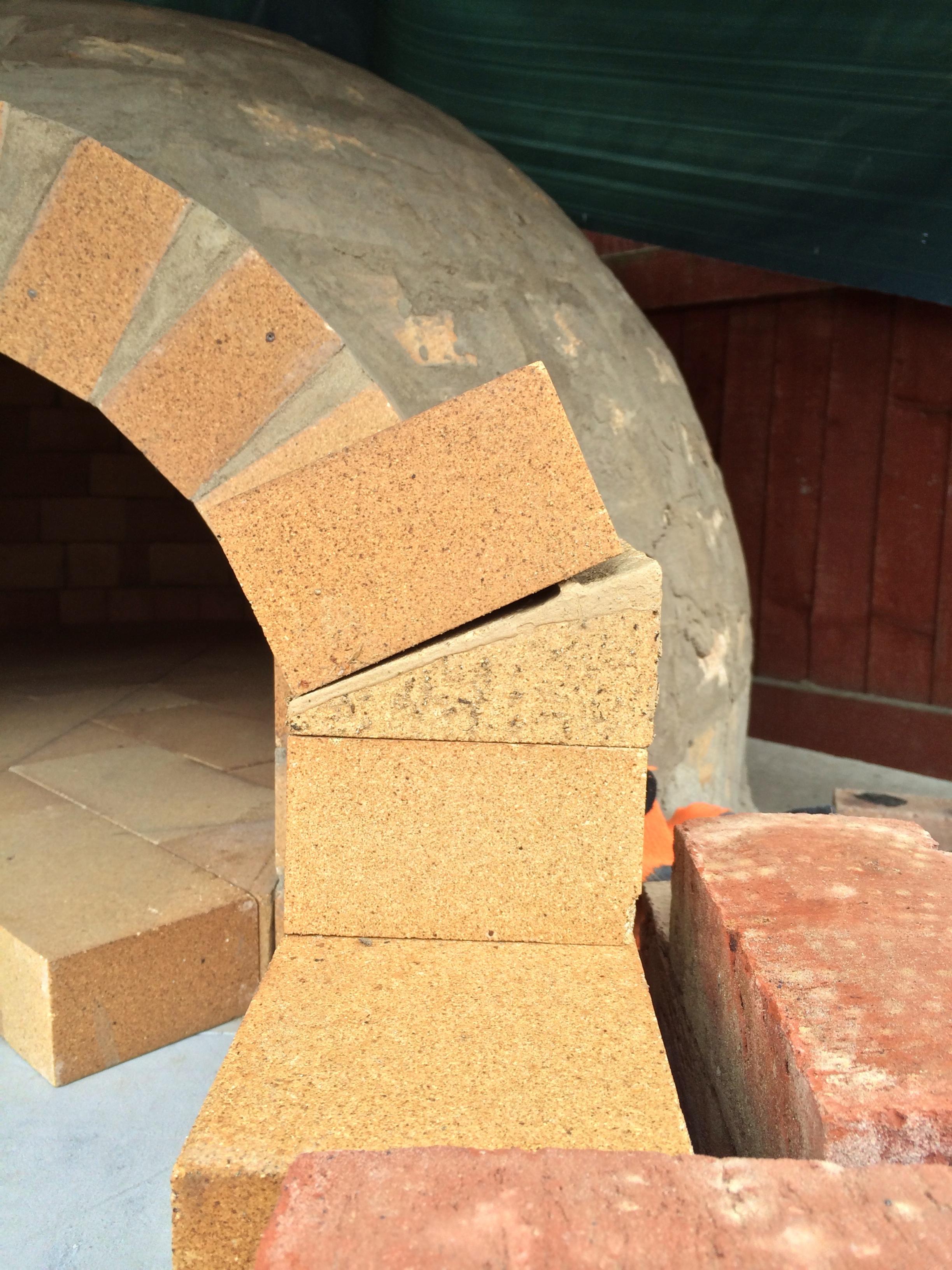

              You can see my to levels of board hereClick image for larger version
ID:	305360 also any body out there with any form of arch knowledge I wanted to use the cuts I used on the outer arch as I did in the dome just simple triangles are these cuts right for the weight distribution ? Thanks

                #67
                Lee....it is my understanding that if you would incorporate a heat break in your floor and possibly your archways, you might be able to design things a bit differently. I'm no expert, but after asking questions and doing some research, that is what I plan to do. Just my 2? worth.

                    #69
                    Can you post some photos of the area? That may help me or others to give opinions. My question, w/out the benefit of seeing photos, is how is the heat getting to the concrete floor? Personally, I believe that heat breaks in the floor and the archways is the way to go. They act not only as a heat break, but also an expansion and isolation joint. Again.....just my 2?.

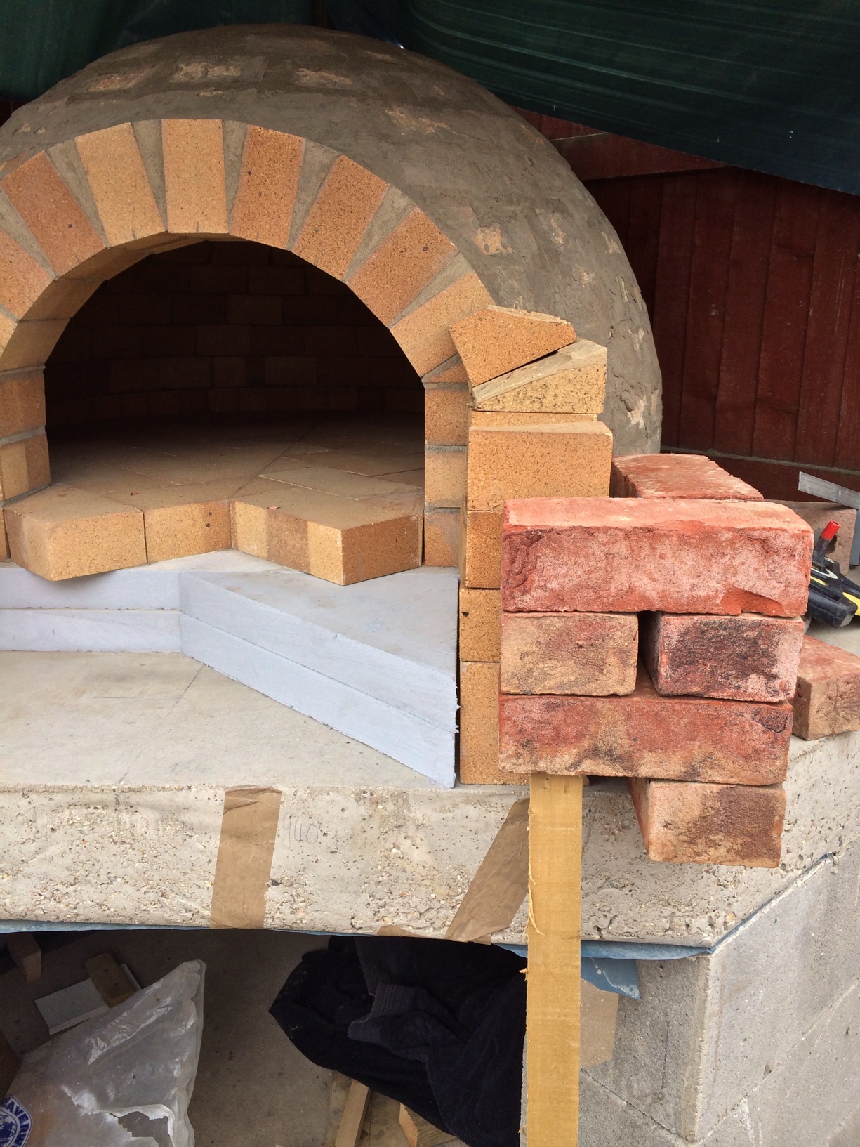

                      #70
                      hope these help a bit more then had a dry stack with some off cuts you can see the fire brick on the concrtete and the board inside i just didnt know if the heat would soak through some how maybe using a tuscan grill im just guessing Click image for larger version
ID:	305364 you can also see the sort of cut i was looking at using to start the arch
