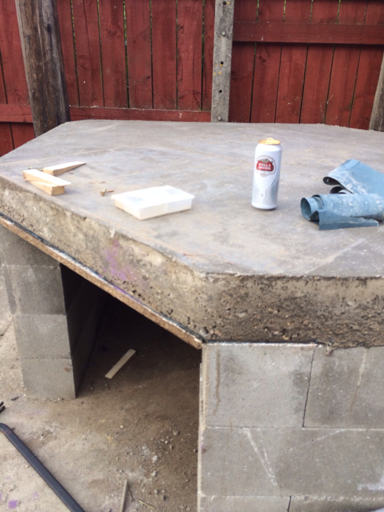

                            #28
                            Re: 7 years in the waiting i get to start my 42" pompeii
                            Slight bit of honeycomb in the slab pour but won't be seen Click image for larger version
                            link to my effort http://www.fornobravo.com/forum/f8/7...art-20707.html
