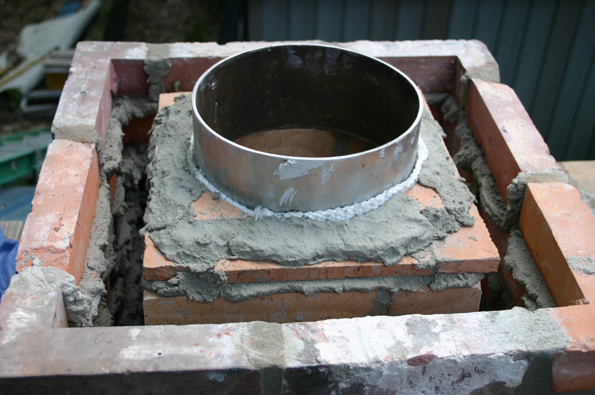

              Re: Yet another curing question
              In certain places it's not optional like a break between the vent and oven opening......like when the flue comes through the crown of the chimney.
              Maybe,..... not practical but, definately optional
              • stonecutter
                • Jun 2007
                • 2003
                Well, I guess everything is optional. What I mean is, not optional if you don't want a cracked flue (clay)...not stainless.
                  Not quite I separated my vent flute from the dome with heat break and insulation even though I wrapped it around the dome entry arch. Substantial difference in temperature still bloody got though.
                  Cheers Colin
                  Oven 1 Completed
                  Oven 1 and surrounds
                  • stonecutter
                    • Jun 2007
                    • 2003
                    It is optional in that with or without a break, the masonry isn't subjected to damaging expansion. Stopping heat from migrating into the vent masonry is optional, is not detrimental, and the performance gains are minimal.
                    Old World Stone & Garden
                    John Ruskin
                      But, will improve "greatly" after all is dry .
