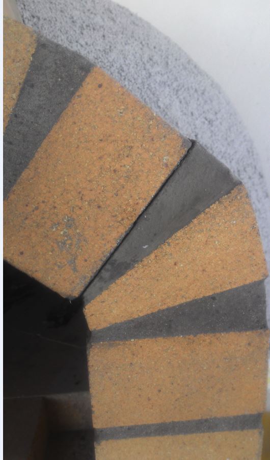

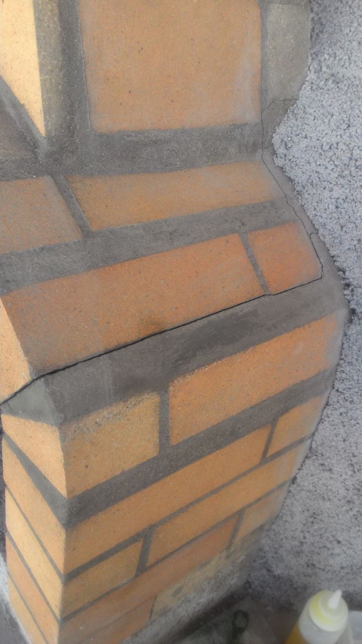

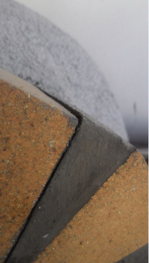

Hi David,Originally posted by david s View PostThe crack in the position you describe is quite common in ovens that have no thermal break or expansion joint between the oven and the flue gallery. This expansion joint allows the expanding oven to move a little without putting stress on the outer arch of the flue gallery. The other problem is the uninsulated flue gallery itself. Stress on the refractory is increased when the inside gets hot but the outside remains cool. By insulating around it this temperature difference is reduced and thereby reduces cracking tendency.
Don't worry about the crack, it probably won't get worse. As they say there are two kinds of ovens, those with cracks and those with owners who lie about their ovens having no cracks.
Today i made some pizzas for first tray.
I reach very high temperatures and the oven was almost saturated.
I see the same crack again and the corner of the brick just a little down.
Which is your opinion on this?Need some protection or is not a problem?
